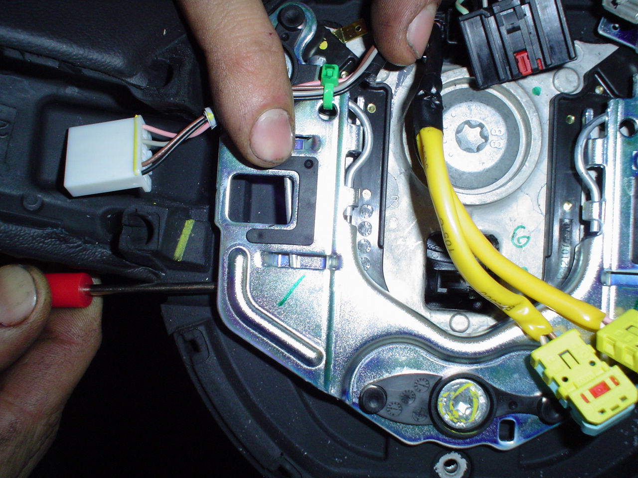

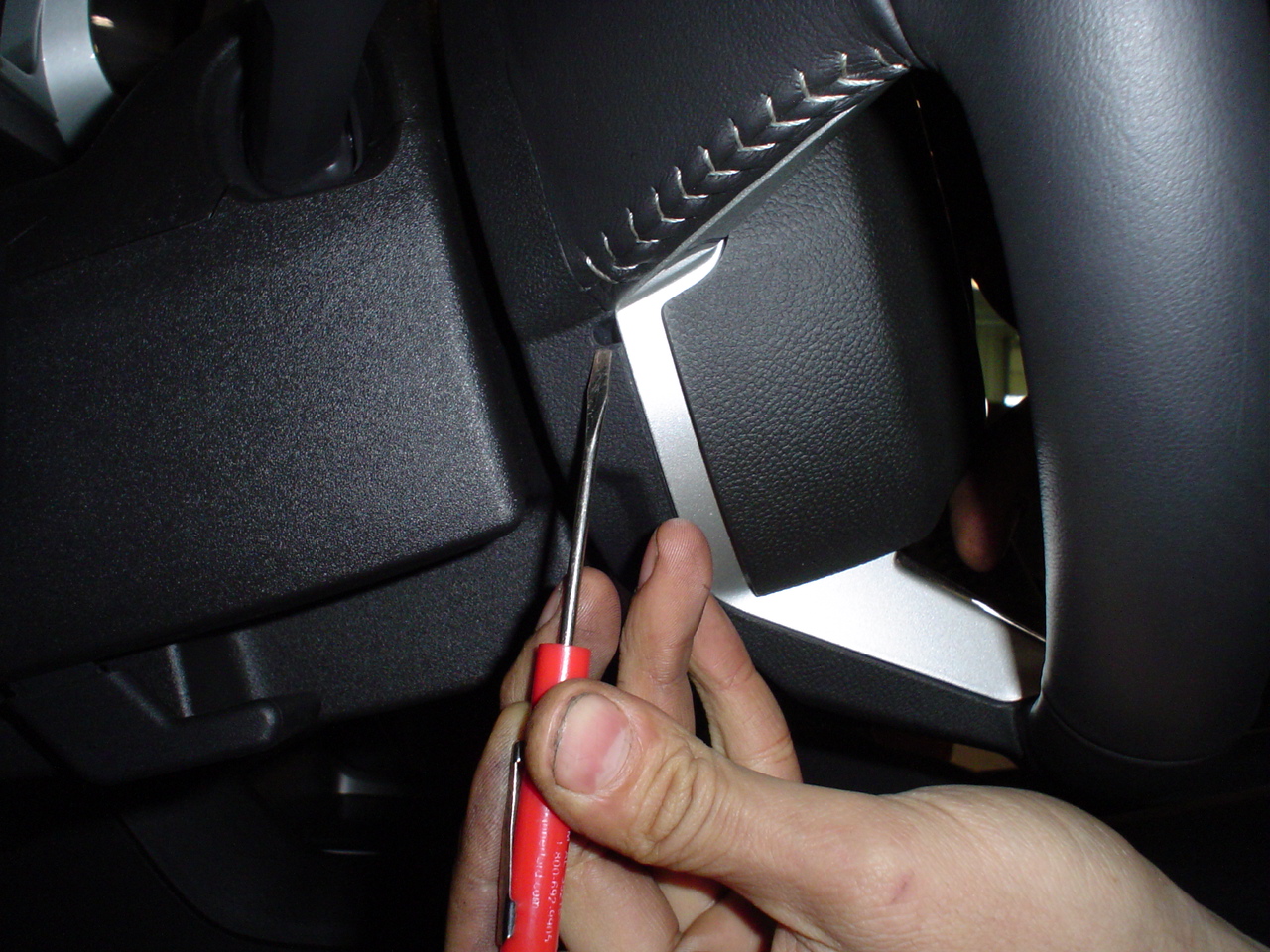

first step as always is to disconnect the battery so as to not set off the airbags. dont be afraid of them if you are careful they are not a problem with no power. there is a small hole in the side of the steering wheel insert a small tool i use a flat blade pocket screw driver and push in on the metal tabs i took pics of the tabs w air bag off to show you what you are pushing against
