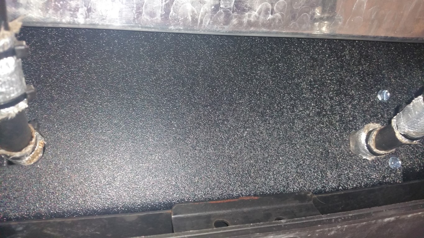

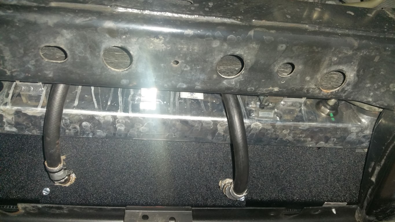

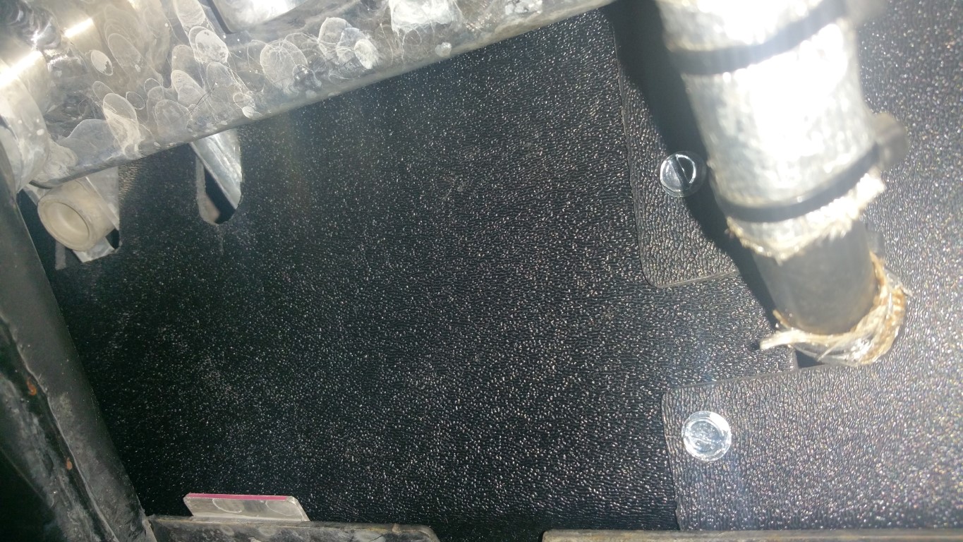

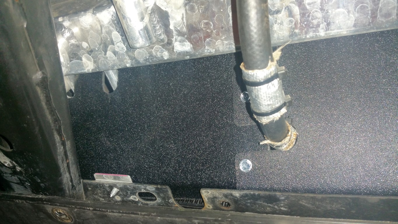

Today, I built my lower air box. The new HX cooler rendered the ZL1 version useless so, worked with some ABS Plastic, heat gun, and built it up in sections:
Worked out nice. Next weekend, I'll take off the bumper and do the upper part.
