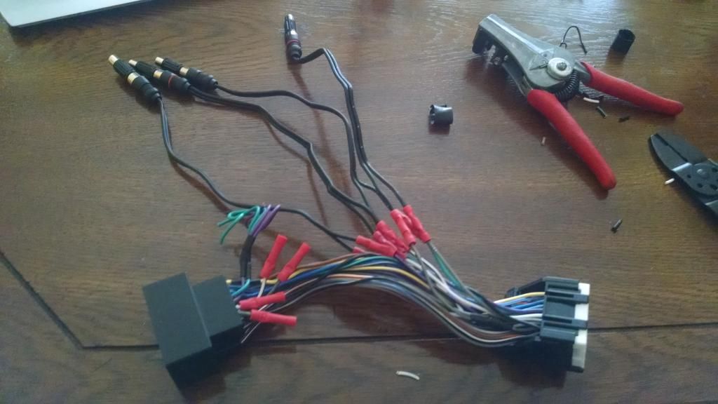

Hey guys I made a thread a while back about my head unit not working (I found out it was fried with my mulitmeter). I ordered a new unit for $65, got it programmed at the dealership for $95 and now I have the same issue I had before I shorted my previous head unit (I corrected the short. I needed to wrap my speaker wire to RCA converters in electric tape since the RCA's ground was exposed).
I am using the PAC LOC harness and NOT the LOC. Like what jeepguy did in this thread: http://www.camaro5.com/forums/showthread.php?t=213330
My head unit will sometimes not produce sound. If I power the stereo on without the keys in the ignition it will work and create sound. If I go to put the key in the ignition and fire up the car the sound will suddenly stop working (but the amp shows that it is indeed on). Sometimes the sound works sometimes it doesnt work. But, if whatever reason it stops producing sound the only thing I can do is reset the car by taking the keys out of the ignition and opening the door.
I don't know if there is a wire that is messed up going to the head unit or if my amp on wire is not attached to the correct wire or what. All wires are secure and look good. All speakers and sub work perfectly when the sound is produced.
It is mind boggling because sometimes it works perfectly, other times, not at all....
Loose wire? Bad amp on wire? I connected the amp on wire to the exact pin jeepguy did in his thread.
Help or suggestions are welcome. Literally, I will hear out any advice!
Here is my harness:

Do you have the blue wire with white stripe going to the turn-on input of your amp? The solid blue wire is to raise a power antenna, and if you used that one it may be confusing the system.

Awesome, these could be my issues. I am using the solid blue wire right now. Should I wire it to the blue/white wire instead?
And 760bowtie, what exactly do you do to put that add a circuit together? Would hard wiring it to the blue/white wire instead work the same? Would hard wiring to the cigarette lighter also work??

I'd rather do it the proper way than adding a circuit, both work the same. But white/blue is remote turn on wire where as the solid blue is for the Power radio antenna wire.
So yes blue/white is the remote turn on for an amplifier.

The blue wire will only supply 12 volts when the source is the radio. If you are not listening to the radio, but say a CD, then there will be no 12 volts on the blue wire. The blue wire is designed to raise and lower a power antenna, or to turn on an amplified antenna system.

I swapped it to the blue/white wire and everything now works as it should. Thanks SOOO much guys.
