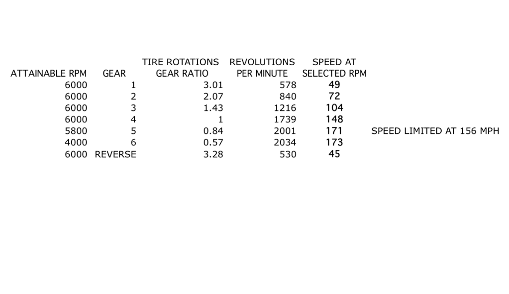

Does anyone know what the maximum speeds are that you can reach for each gear?

According to Road & Track June 2009 road test on the 2010 SS Camaro:
1st 6500 rpm 52 MPH
2nd 6500 rpm 76 MPH
3rd 6500 rpm 110 MPH
4th 6400 rpm 155 MPH*
5th 5400 rpm 155 MPH*
6th 3650 rpm 155 MPH*
*The computer in the 2010 Camaro limits top speed to 155MPH.

3rd would be fastest from 70, but 4th pulls pretty hard from there as well.
And, why would you go to 2nd? 6000 rpm is 72, not worth it for that...
