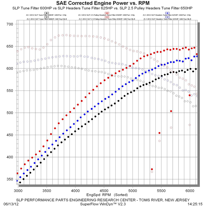

When adding headers to a supercharged application a lower psi in boost will be seen, BUT is easily remedied with a pulley swap to make additional power through volumetric efficiency. Stainless Works willl have a ZL1 here very soon to verify header fitment.

Well, the boost drops but what happened with the power(if tuned properly)
makes me wonder why you would even put headers on If you need the pulley to make up the lost boost...

as mentioned before, you can make more power with lower boost. Boost is only a measure of resistance/pressure in the intake system. It is not the same thing as CFM or amount of airflow.
Who cares if you have 20 psi of boost if the next guy makes more power with 10 psi because his engine intake and exhaust systems are that much more efficient. Besides, more boost means more heat, which also means less power.
The only reason to swap pulleys to maintain boost is because the motor can take it, and if it can take it ("it" meaning cylinder pressures), then why wouldn't you do it? More boost does mean more power as long as it isn't too much due to heat or engine durability.
Bottom line, headers make the system more efficient and you will still make more power even if there is a little less boost.

From our testing, LT's are worth about 13-15RWHP with a .6psi drop in boost pressure......worth it in every way when adding a QUALITY set of LT's like Stainless Works or Kooks

Keep an eye out here for headers and other parts from SLP for the ZL1
http://www.slponline.com/browse_list...p?SPC=zl1parts
Here is the only Dyno sheet I have right now. I should have others and more information at a later date.
