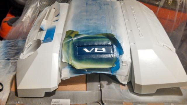

Did a bit of work on Tuesday. Installed the Grille lighting that I did not get installed on Saturday and then I received the extra engine cover that I had bought off another member here so I painted it.
Red
Blue
Ok going to preface these engine cover pictures with this: I am no artist or painter, I really can't even draw a stickman so is it perfect.....nope but it only has to last until I get my original back from the painter. It was pristine until I decided to open the garage door to ventilate and of course the wind blew a piece of tape up onto the not fully dried paint and put a pretty large blemish in it. Really had no clue how to fix it so waited on it to dry then sanded it down, put some coats of paint on it and well like I said it is not perfect but it will do for a couple of weeks.
masking in progress
White coats going on
starting to do the lettering
The Finished Product
