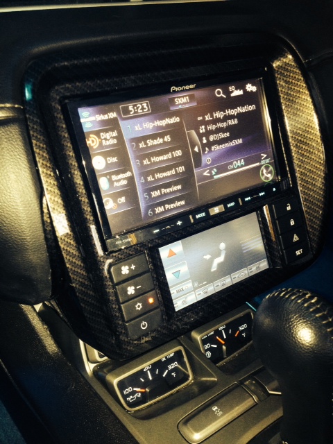

Here are some pics...I originally ordered the JL c2650's for the front and JL c2350's for the back...I wasnt happy with the overall sound. So I added 1 driver to each side in the back and added Pioneer 6.5 speakers to the back (had to cut metal to fit) and moved the 3.5's to the footwells (had to cut to fit)....sounds great now. JL 10w7 and JL hd750.1 coming next week, should complete the setup
Also put up a pic of the Scosche kit in Carbon Fiber (matching the hood)...looks great if anyone is thinking about getting the CF scosche
