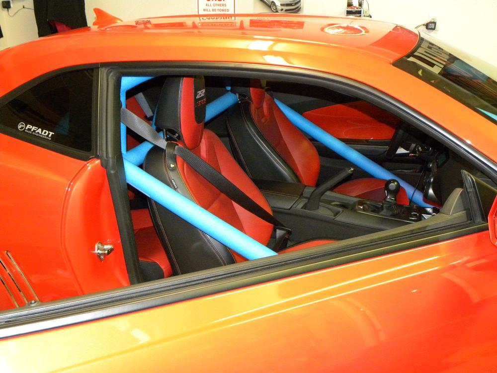

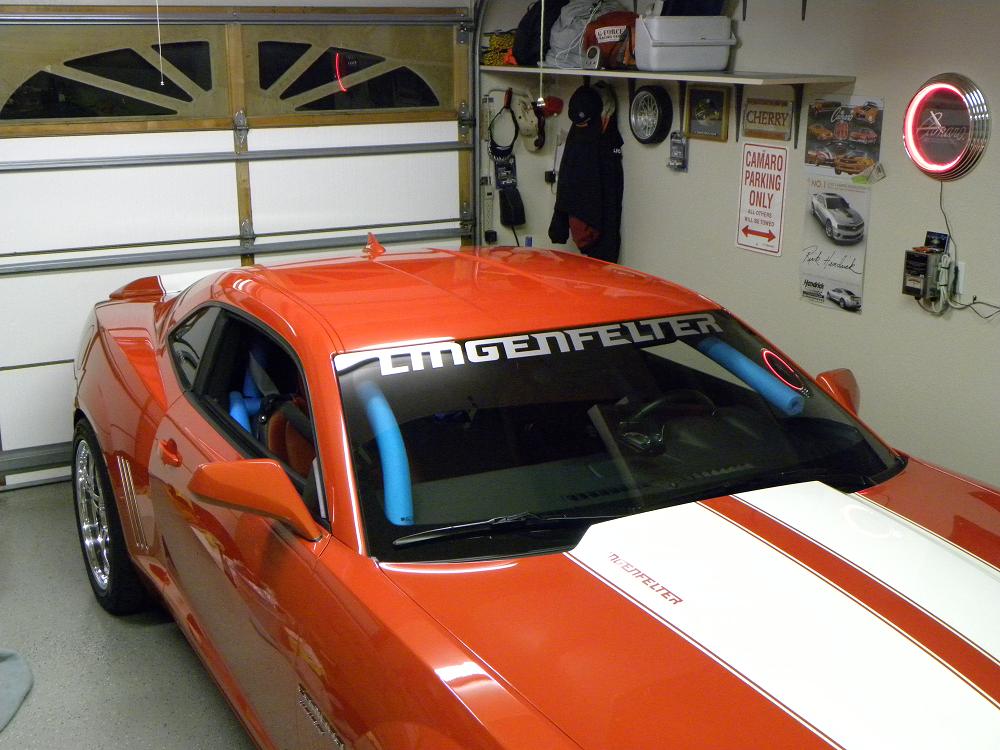

Powdercoated FNR Rollbar installed.....
Couldn't let "2010 SS RS" have all the fun

Okay, time to come clean...
I had to mess with "2010 SS RS" - Larry, and was hoping to get a rise out of "mtcwby" - Don. Had to make it look real, so posted in a few places. Larry already picked up on it ..... I got to help install an RPM in his Larry's last weekend along with Brian from Laramie Chevrolet. I'm just not quite ready to loose my rear seat. But the thought of needing one is quite entertaining.
So here's the cost and options for the FNR Rollbar system (Fun Noodle Rollbar):
Purple, Yellow, Red, or Blue.... $15
Holy Cow - That thing is made out of "Floatie Noodles" ?
You had me fooled - Doh !
Looks just like the Firebird's first rollcage covered in blue instead of black.
That is f'n awesome !!!
Ha, ha - do you think it'd pass tech inspection... j/k.
Nice one. You need to drive around C5Fest2 with that thing in place and then pop out the sidebar when you are in the parking lot and staging lanes... You do know that it looks like the cage FastLane had in their car at the original C5Fest? Wish I had a pic. You'd laugh your a.. off.

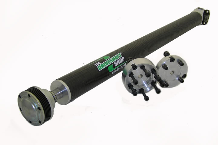

Drive shaft solution ordered - DSS Carbon Fiber DS!

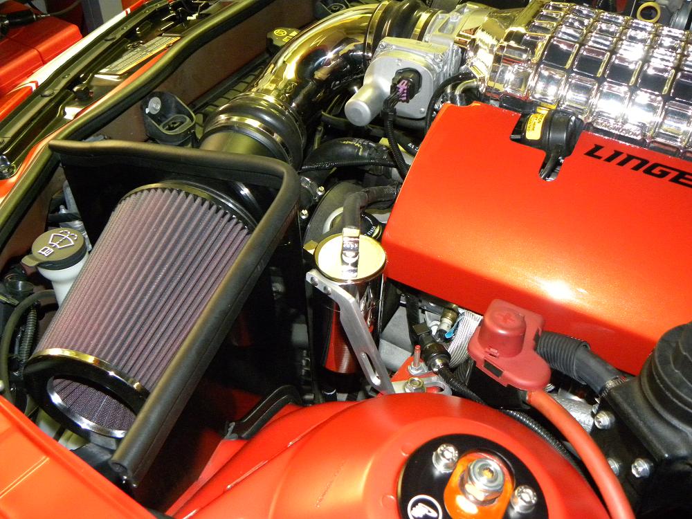

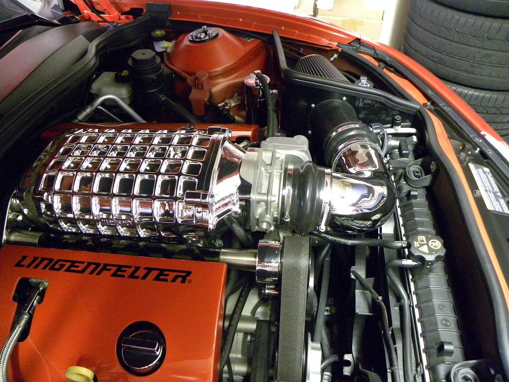

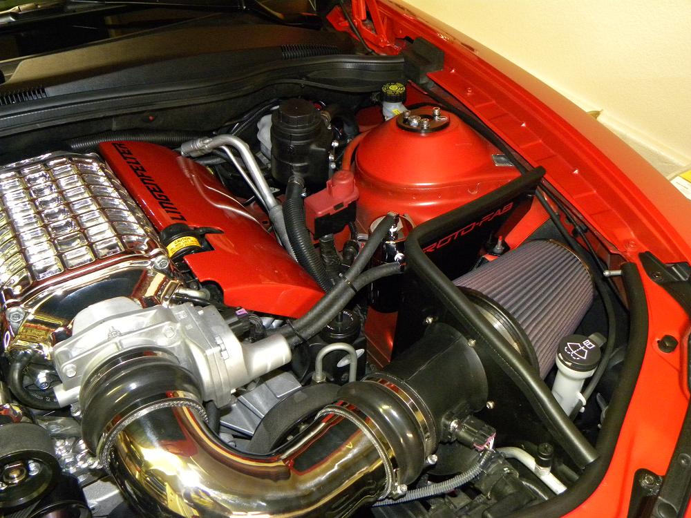

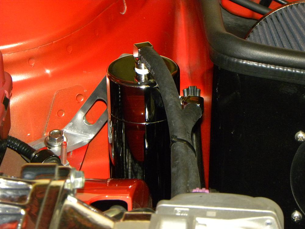

Elite Engineering Oil Catch Can Install Pics
Installed pictures....

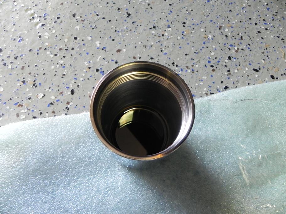

1st 2 pics shows oil caught in 270 mile road trip at ~65-75 MPH on interstate. Measures about 1 teaspoon.
I enlarged the mounting hole, plus used a different bolt and washer below the modified Elite bracket to get over the hump on the old air filter box mounting bracket. The stainless nut has a large locking flange base on it.... had a bag of them from my PV Solar System Array install that I special ordered from Fastenal.

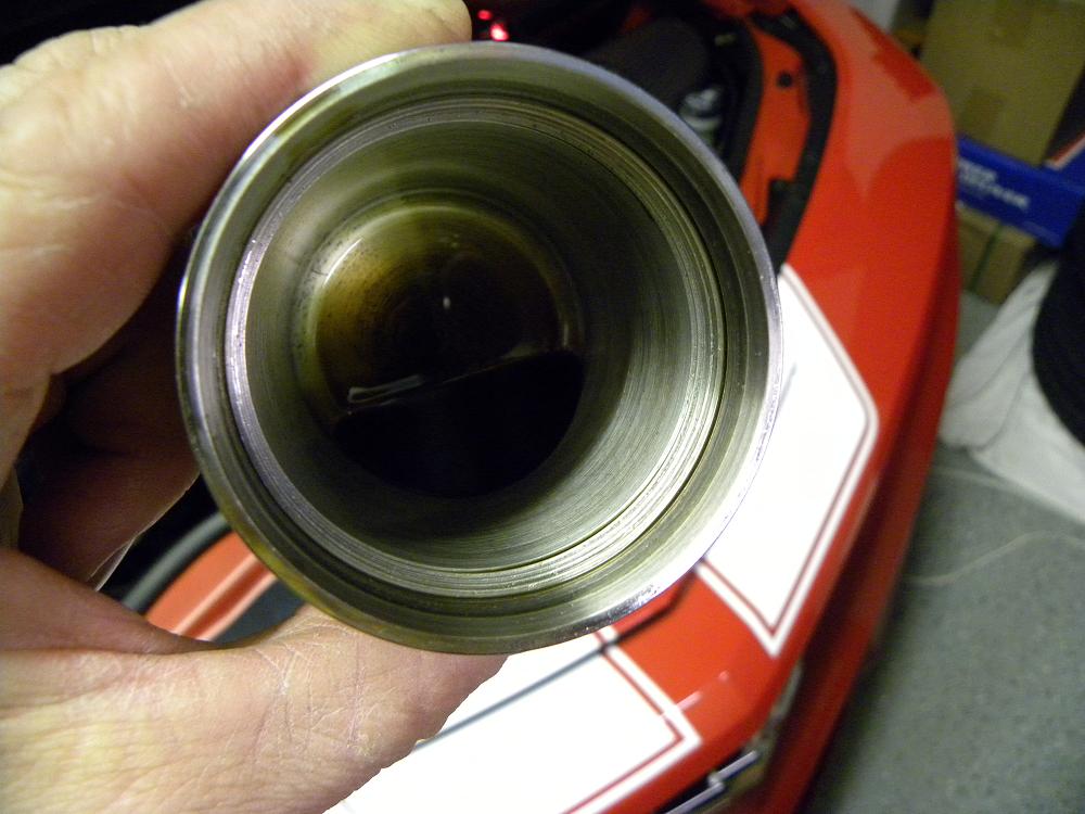

Last pic is 210 miles in town driving - didn't measure yet, but looks like a little more. I will be interesting to compare results with another member on trip to Cfest, dragstrip festivities, and Pfadt Track Attack session The other member is running a different unit on a stroked Eforce supercharged engine, but is using breather cap that requires a tune - due to using unmetered filtered air. I like my polished one that doesn't mess with our tunes!

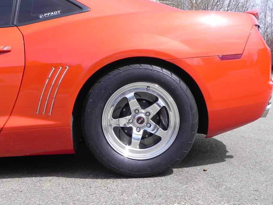

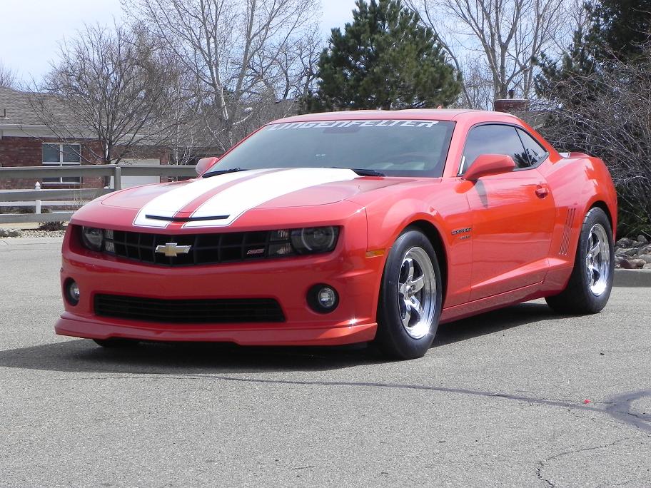

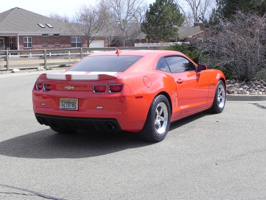

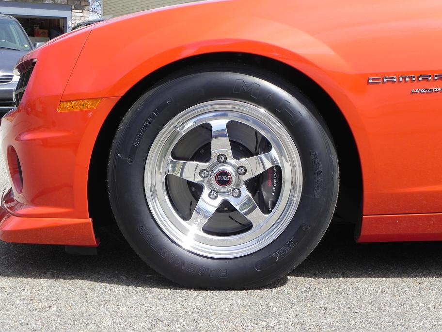

New Weld Racing rims installed.....
A few adjustment for clearances, but all good now!

Wow
Those look really great on there. Still has the stance and all. Very nice. Those M&H's should give you some good bite at the track.
