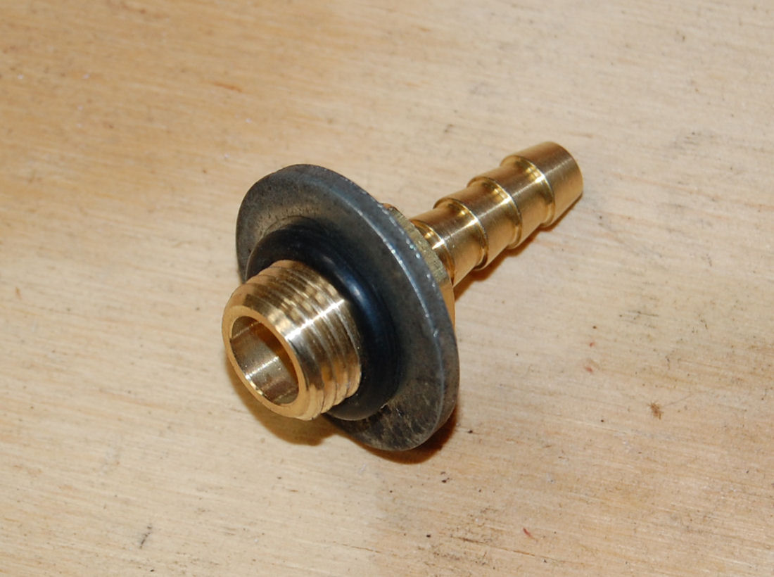

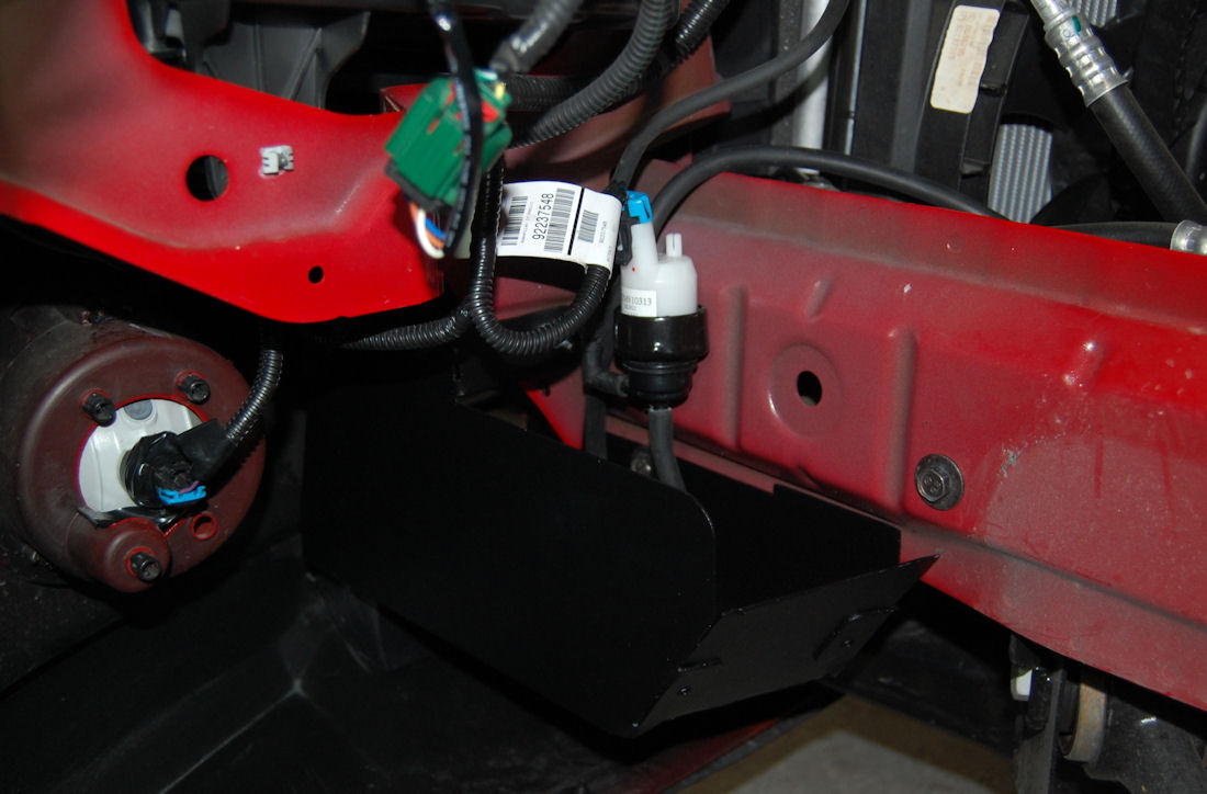

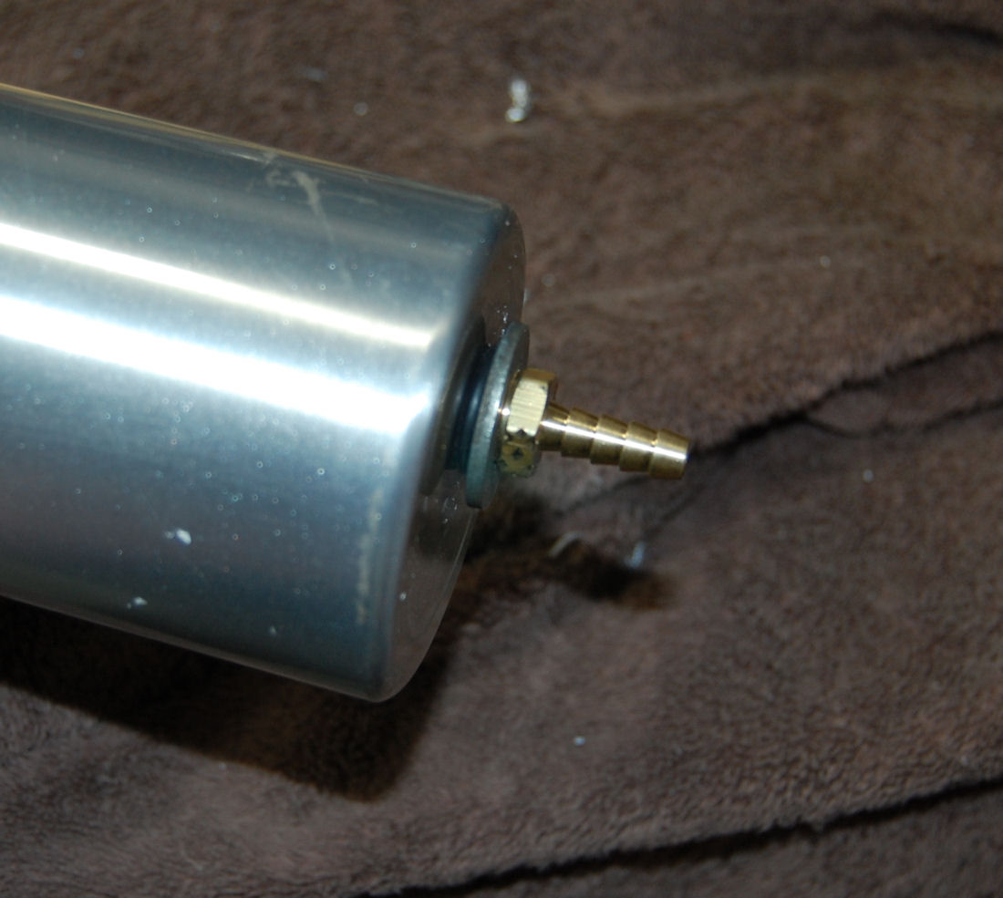

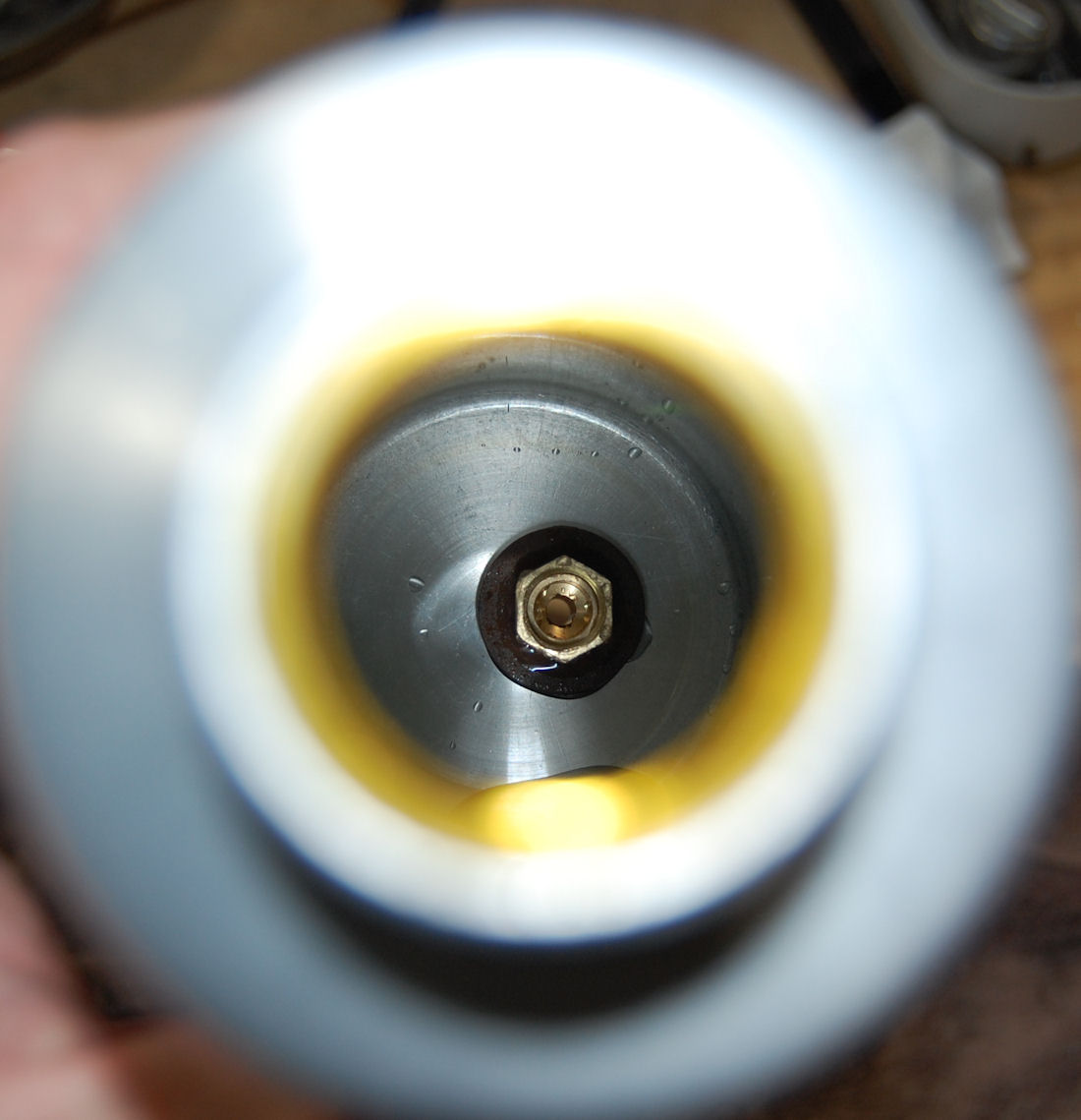

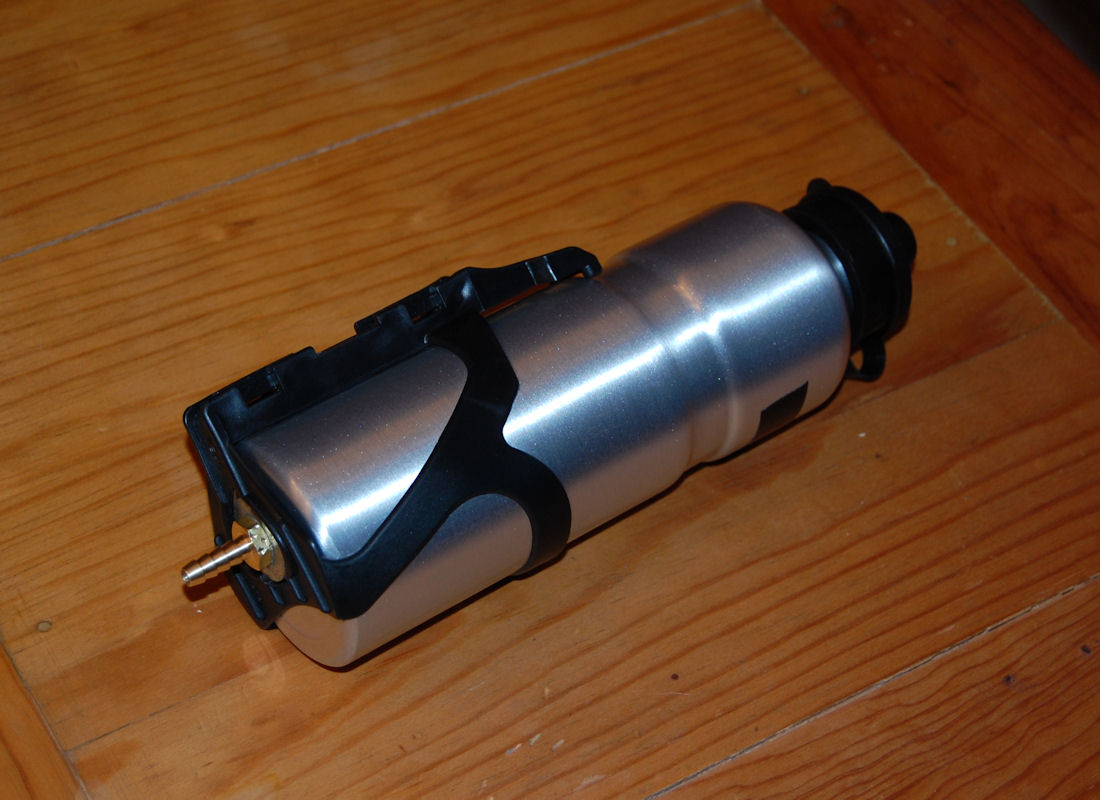

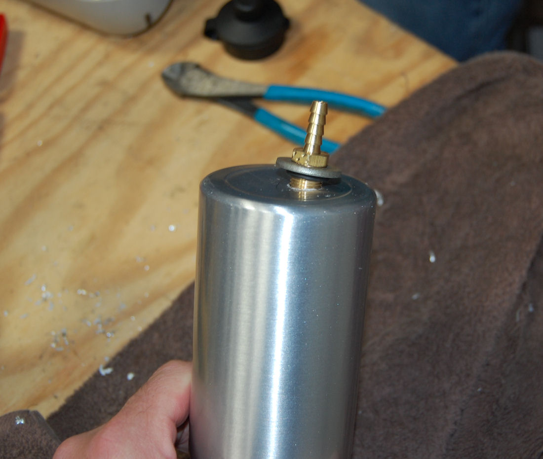

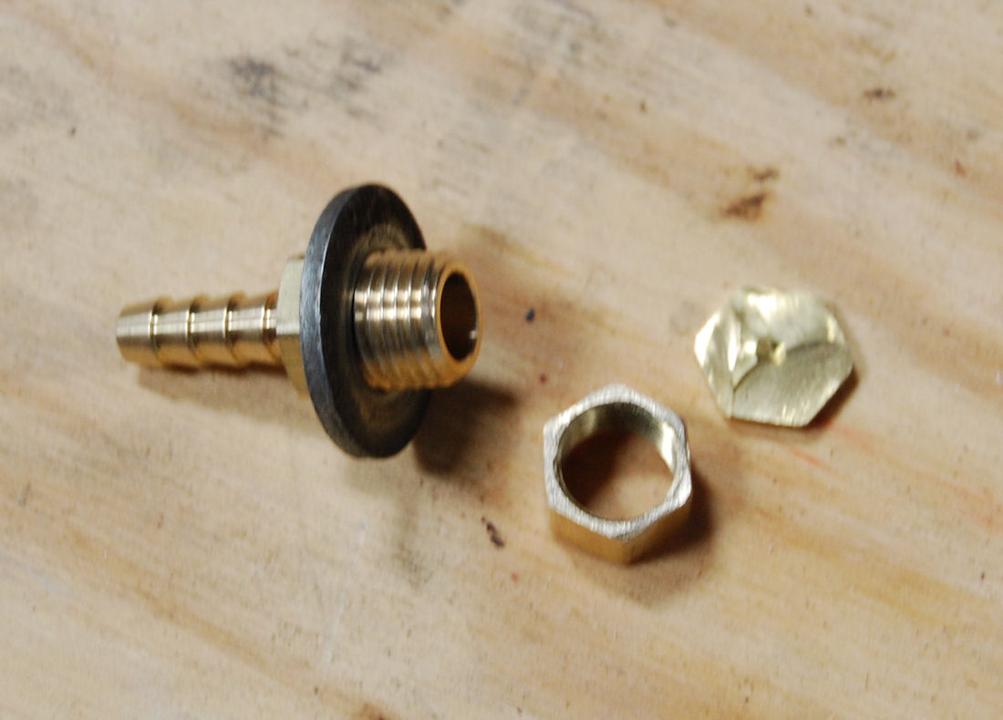

I finally came up with an idea for a washer bottle, thanks to Number_9, so I was able to add an ADM Race scoop with my Halltech.

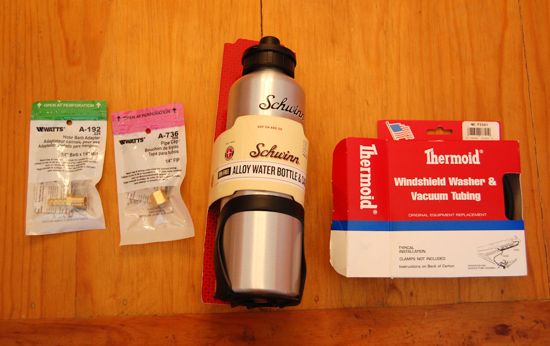

I went looking for a water bottle and ended up finding one at Walmart in their bicyle section. It is designed to go on a bike so it came with a holder. It was just under $9….but it did say Schwinn on it.
I then went to Lowes and bought a hose fitting and a nut. Well…they don’t have a nut for a hose fitting so I ended up buying a cap and then cut off the end of it with a dremel tool. I spent about $5 on those parts. I then drilled a whole in the bottle (starting off with a small whole and then increasing in size). I used a washer and a rubber seal. I tried a few combinations but ultimately I ended up with Fitting, Washer, Seal on the bottom and then a Seal, Washer, Nut on the inside.
I went to an Auto Parts store and picked up some vacuum/washer bottle hose for about $4. My total of parts came to about $20.
I mounted it the bottle bracket to the positive cable bracket inside the fender well. I had an extra 10mm bolt/lock washer/nut combo that I used. It was a little tricky to get a drill in there. Not a lot of room to work with but I eventually got it. I also used a couple zip ties to help hold it into place a little more.
Over this weekend I plan to take the cap off of the OEM washer bottle and JB Weld it to the lid of the new washer bottle. That should give it more of a factory look. The cap is almost an exact fit. I’ll have to do a little sanding to make the top flat but that shouldn’t be any big deal.
I might go back and paint the bottle black. I'm going to see what it looks like with then OEM lid first.

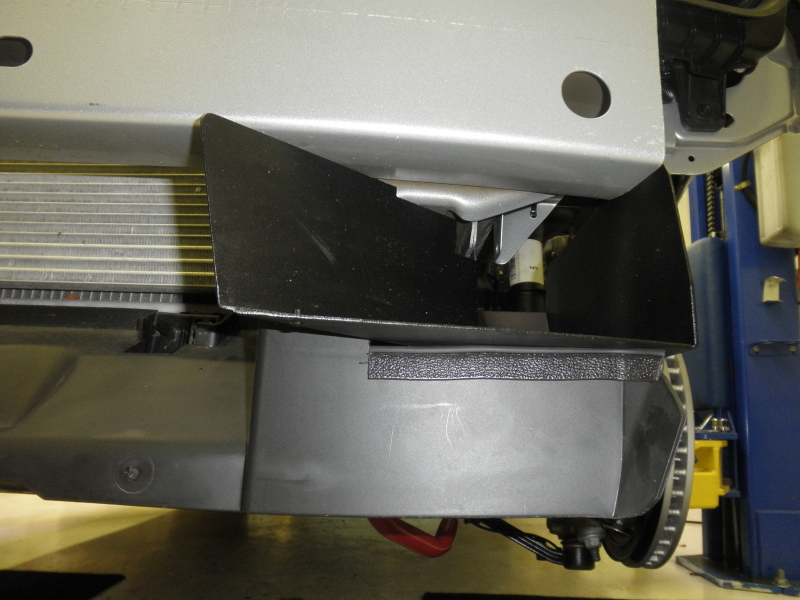

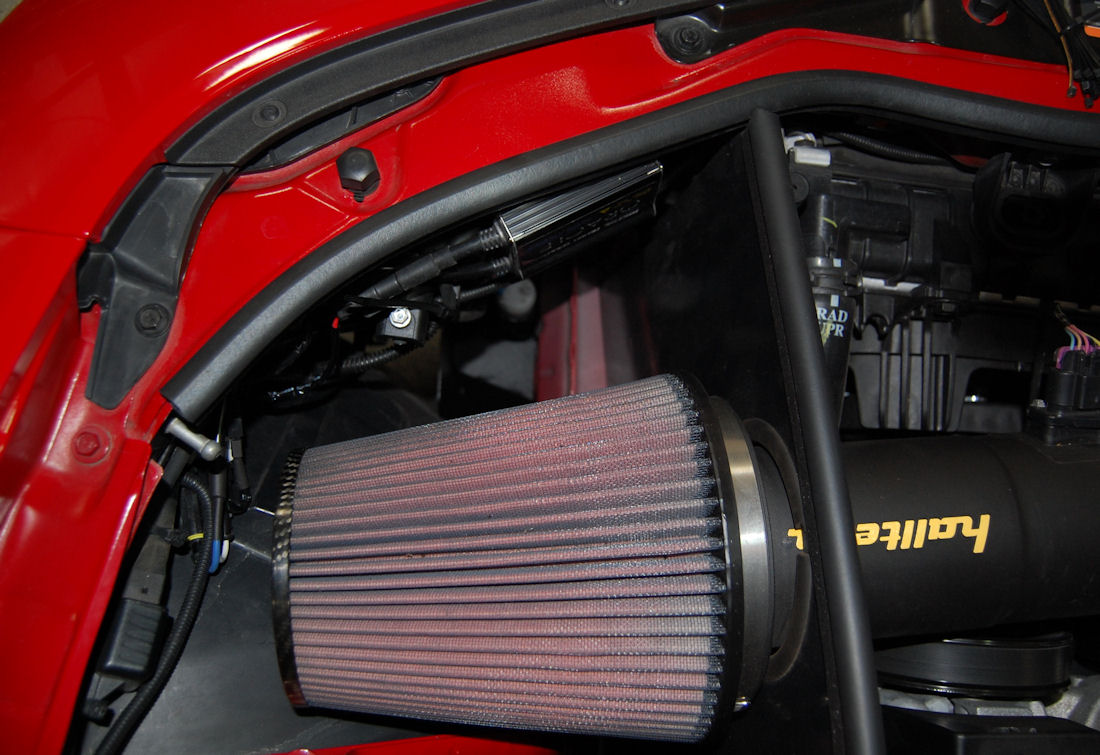

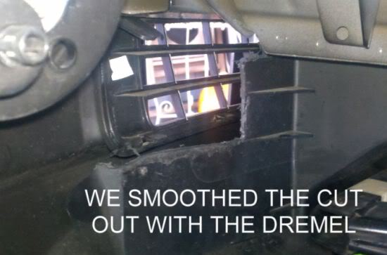

I took a trip over to ADM and picked up the Race Scoop yesterday. It’s a nice piece. If you buy one you should also ask Andy about the hose clamp to hold the water pump on with. He said they sold them at Home Depot but when I was at Lowes buying my other parts I couldn’t find anything like it and the helpers there were……no help.
You just follow the instructions he gives you which were a combination of these two threads.
http://www.camaro5.com/forums/showthread.php?t=90068
http://www.moderncamaro.com/forum/sh...ad.php?t=27037

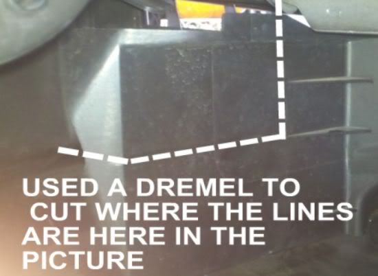

The only thing that was even remotely tricky was getting a dremel tool in there to cut it nice and neat….which it doesn’t have to be perfect. There is probably a better bit for the job but all I had was the round cut-off blades.
Definitely take out the fender well. It’s easy and gives you a lot more room to work with.
I just got it on last night so I haven’t been able to get a lot of seat time with it just yet but as you can see in the pictures there is no way this can’t significantly help. The washer bottle really blocks a lot of the air coming into the intake area.
I have basically $100 in everything with the mod….that includes the washer bottle. This is definitely a must do mod for those that have a CAI that use the front fender well area to pick up air from.
The Halltech was one of the better performing CAIs on Jannety's test. I would love to have seen it go up against the others with the ADM Scoop installed. Unfortunately I wasn't able to do a before/after on a dyno but again....I can't see how this can't be a huge improvement.

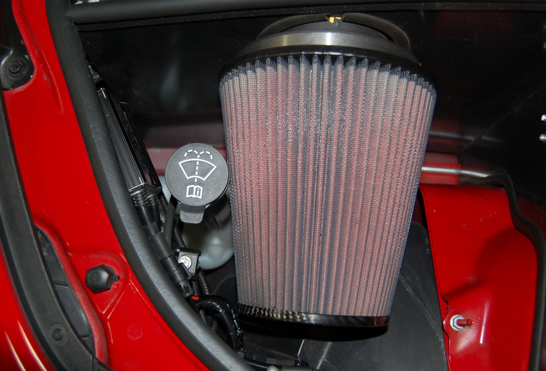

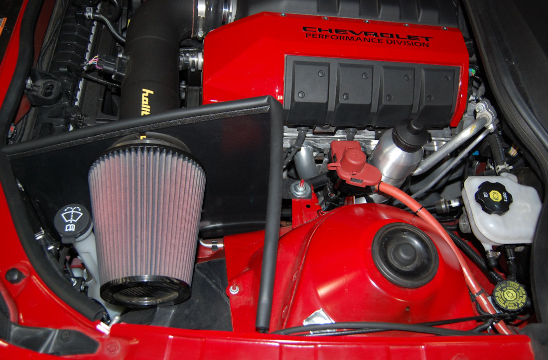

The first pic shows the CAI with the water bottle in the way. The next ones show what it looks like now.

You can see this in the other threads but thought I would post it here as well. This is what you cut out to get the fresh air and also a pic from the front of the scoop that is right behind the grill.
