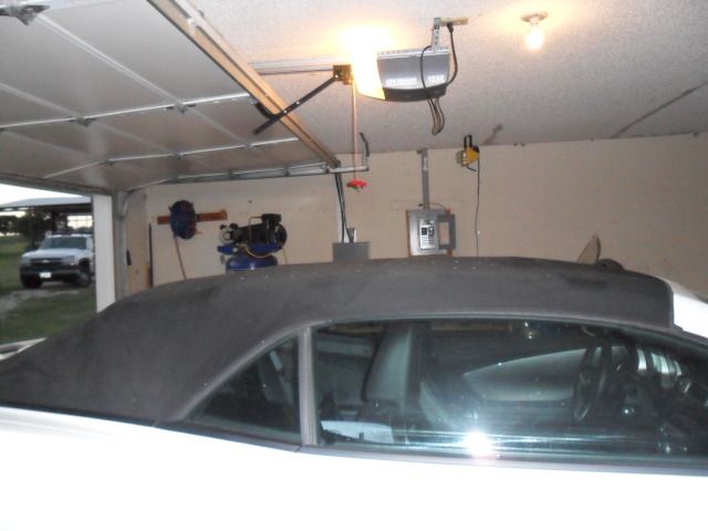

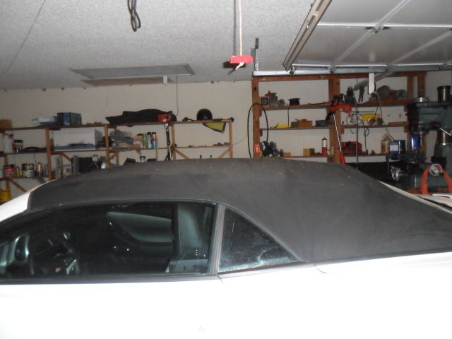

7500 miles on my 2012 [bought her last fall] with the milder texas winters the top is down three quarters of the time. Been a wetter spring thank goodness since we need the rain. Good for my garden, bad for my tan. She needs to be cleaned from a recent dandylion storm at work and I have to put a new batch of 303 on her, but here's my top pictures if I can get them to show up.

I just realized that only two of the three pictures I had showed up.
here is the drivers side:
"Life's been good to me soo far."
DandyB is offline   Reply With Quote
