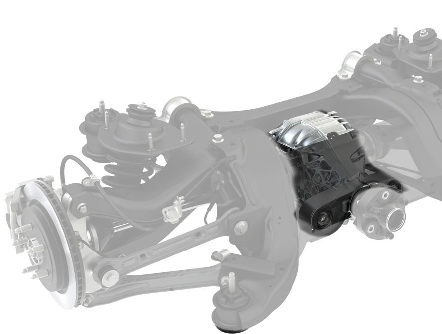

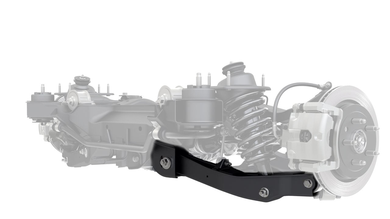

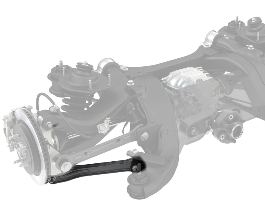

Could someone provide a labeled diagram or iso view of all the suspension parts and what they're connected to for newbies like me?
Just starting my research on upgrade mods in this area and knowing what everything is attached to would make understanding it alot quicker and easier.

The blue colored part is the trailing arm, it is generally one of the first parts changed on the rear suspension because it not only helps the pesky wheel hop these cars have but also helps with rear suspension movement which in turn gives the car a more controlled feel in the rear. Generally along with replacing the trailing arm we recommend swapping the soft deflective-prone rubber outer trailing bushing to a better outer trailing arm bushing like our BMR poly-urethane ones. Here at BMR we have a couple different versions of trailing arms to really fit everyones needs.
The yellow colored part is the toe rod. The toe rod controls the toe of the tire and upgrading to a better toe rod will also help with wheel hop and rear suspension movement and give the car a more sure feel. Both the factory toe rods and trailing arms are made of a thinner gauge stamped steel in conjunction with soft rubber bushings and they are really prone to flex and deflect which can lead to wheel hop and less than stellar handling so anytime you can swap to a better built part with poly-urethane bushings or spherical bearings there will be a noticeable difference.

The other two pictures I attached show the location of the bushings that we manufacturer. Changing out the rear cradle bushings and differential bushings can really help with the wheel hop and the handling also is definitely recommended. We sell them together in our rear cradle bushing kit which we have two different versions of depending on the power levels and goals of the car.

Camaro Rear Diff - 3 Bushings connect it to the subframe

Camaro Rear Toe Link
Camaro Rear Trailing Arm
