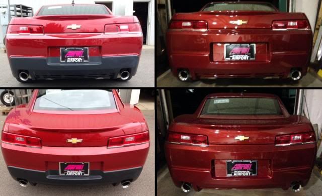

Thought I added this picture for those waiting to see the painted final product, but I guess it didn't take...
I'm very happy with how it turned out, make the 2014 rear look much better imo

It looks like you have a picture of the base model next to a higher-end model. This was a great upgrade!!
And thanks for the write-up. I am getting my NPP diffuser today, so I needed the info.

Is it the same car? maybe you repainted the whole vehicle because in the before pictures it looks like red hot, and the after pictures looks like crystal red tincoat. It looks different than any other 2014, so much better but i'm not asure i would dare to da that.

Same car, it's just the lighting that makes it look different. It's actually Red Rock Metallic... The fact that they're just poor quality cell phone pictures probably doesn't help what you're seeing.
