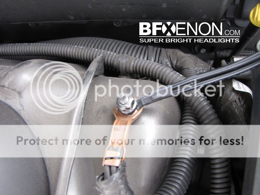

When installing BFxenon HID lights, for your safety, please remember to remove the battery terminal / negative lead to the battery before connecting any high voltage parts.

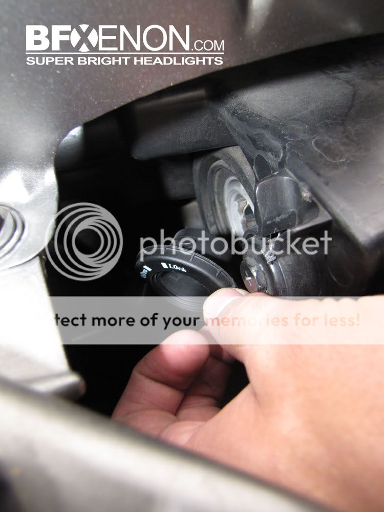

Step 1: Remove factory lights from the factory housing

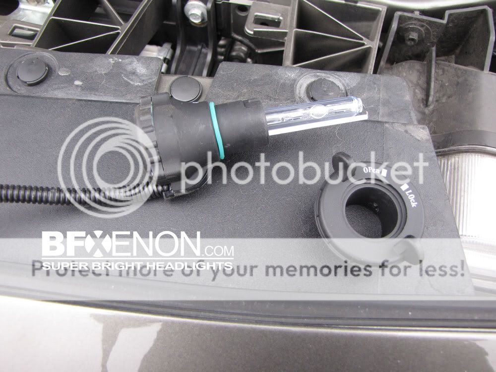

Step 2: Install HID bulb or Locking clip (on some applications) by lining up the channel locks, pushing it into the housing, and twisting.

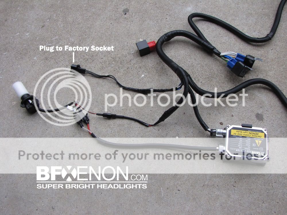

Step 4: Connect the female terminals on the harness to the ballast
Step 5: Connect the small trigger wire from the harness to the bulb and the positive and negative lead off the ballast to the bulb (see step 4 for picture)

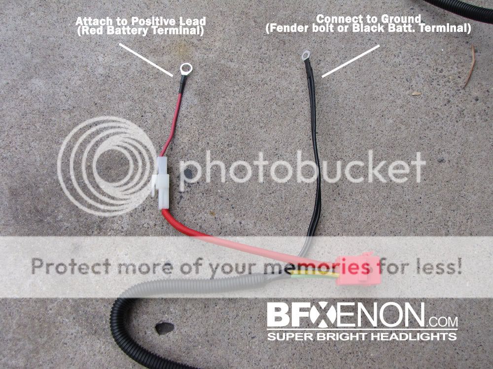

Step 7: Attach the ground wire and positive battery lead, re-attach the positive battery connection and turn everything on. This is just to ensure everything lights up properly before you secure the ballasts and wires.

Check your wiring:

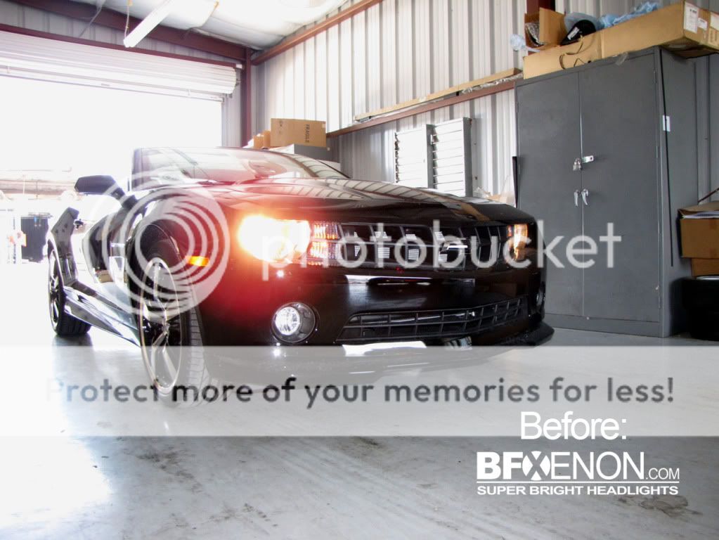

Can you give us some shots of the lights in action... before and after maybe?

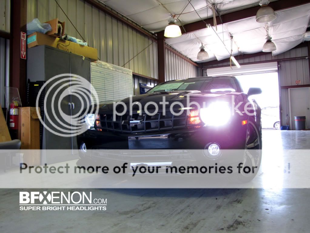

Old 10-12-2009, 01:00 PM   #3
BFxenon.com
Drives: Camaro
Location: BFxenon.com
Posts: 462
Before:
After:
Looking out at night:
