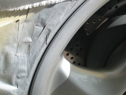

like to START by masking the tire from the wheel...get the masking tape WELL behind the rim.
Next, sand the area to a nice "feather" with 240 grit sandpaper and wipe some spot putty on. IMPORTANT...this ENTIRE project will work best if the wheel is in the sun and its a nice warm day...the drying time of spot putty is minutes but if it's cold or damp, this project is likely to not work out too well. Remember...keep your sanding to the IMMEDIATE area around the damage. Trust me on this.

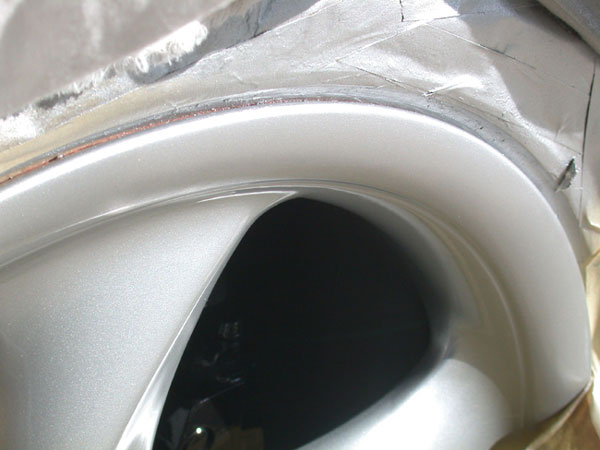

After the silver colorcoat dries (overnight is best), you can apply two thin coats of clear with about 20-30 minutes of drying time between coats. After the clear dries (another day) you can use 1500-2000 grit wet and dry or a fine cut compound to feather in any traces of the repair. Use a final polish to restore full gloss.
Here's the nicely repaired and painted wheel!
