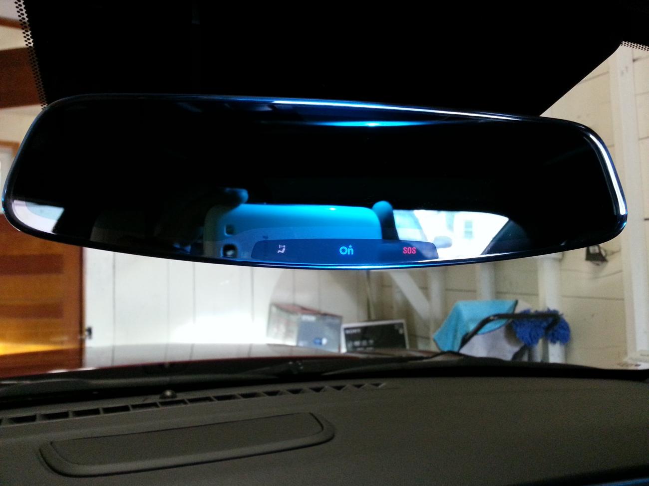

Originally Posted by DWALEX View Post
I'm going to show the way that I use to make this retrofit on my 2010
step 1
switch the Pin 10 (red) to Pin 6 (mirror connector)
Attachment 421821
step 2
I get supply voltage from CLSTR fuse (F4)
Attachment 421829
step 3
I get (Low Speed GMLAN) from instrument panel to console harness
Attachment 421832
step 4
I cut these wires. (Left-Light green Right yellow/black) the new mirror DOES NOT USE. this harness is under the right kick panel, closest to the door
Attachment 421834
I use this wires to send supply voltage and data signal
Attachment 421846
plug the GMLAN wire to Left-Light green
plug the supply voltage to Right yellow/black
step 5
connects the mirror and enjoy it
Attachment 423575
Apparently in the 2010 the Onstar module the green and red LED's commands to BCM are not sends
any questions send me a PM.
