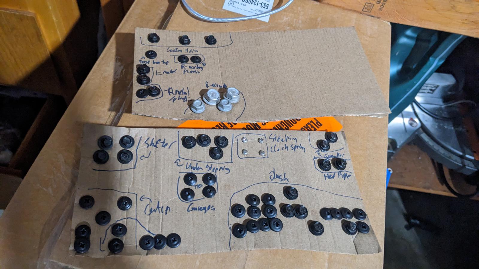

I've removed the dash on my 2010 when installing the HUD, I did it pretty much by myself (except getting the dash out for he car, it's much easier with 2 people) with basic tools, it is very involved though, kinda tedious and you have to be careful because there are bolts that some guides mention but others don't, even repair manuals leave out a few. I had basic tools and experience when I did it and it took me maybe 3-4 days to remove and reinstall, my best piece of advice is get few scrap sheets of cardboard and stick all the bolts in there with notes on where they go, there are too many bolts with different sizes to keep track of otherwise like this:
Behind every scratch is a story on what not to do, and my car has a lot of stories.

Yeah if I had to do it again I would definitely try and find someone else to do it, one side effect of it is that photo below is what the interior looked like by the end, so now I know how to remove most of the interior and roughly where all the different modules are in case one has to be replaced, so in past when I would be hesitant to remove a trim piece to run a wire or something, now it's no big deal
