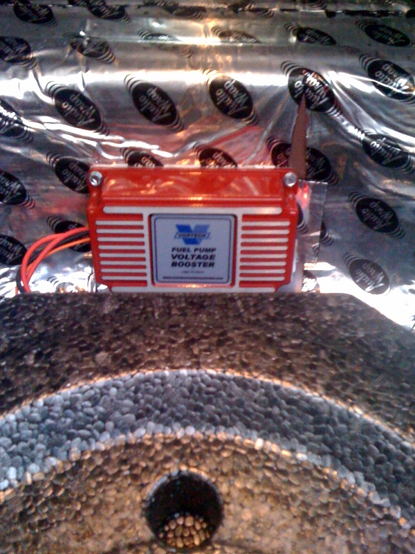

Vortech's voltage booster is the MSD voltage booster, but they include the whole wiring harness, they have already programmed the unit and it is ready to go in the Camaro. Best of all, it is the same price that MSD is selling them for. I got mine in 3 days. And mounted it in the battery well just in front of the battery. They put in about 10 ft more wire and loom than you will actually need.
You don't use the vacuum line on our cars.
Name:  Vortech Fuel Pump Voltage booster1.jpg
Name:  Vortech Fuel Pump Voltage booster.jpg

Yea, but that is not installed in the right place i believe. Like the KB BAP it needs to be installed after the pump and before the FPCM for best results. Your not getting full potential at that location. If you need more flow from your pump then u need to install it after the pump, but you need a boost activation switch to mount it there so it wont blow a fuse.
I don't have one installed, but i been doing a lot of research and thats where i read it needs to be installed.
