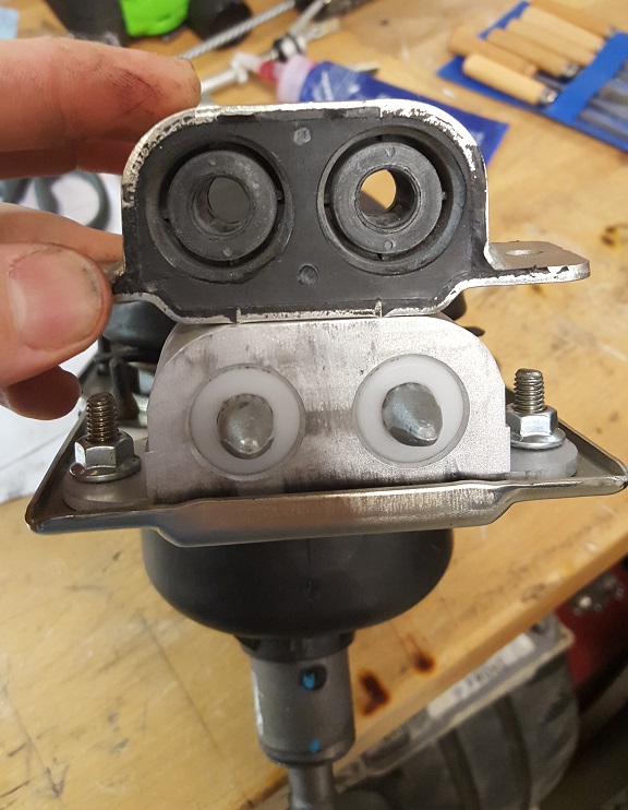

Yes, we do have ours getting ready. The vast majority of the movement in the shifter is in the rear mount. The front rubber bushings have hardly any deflection, and serve mostly for noise isolation. Here is the pic of ours mounted to a stock hurst short throw, along with the stock rubber mount. You can see how the rubber would move a lot, and give the shifter the sloppy feel. The mount shown has delrin bushings, but we have poly on the way to get the noise level more in line with what would be expected in a daily driver.

Will do. with the intention of being a diy install, the delrin bushings were a little difficult to slide onto the shifter, because it is a casting. The poly bushings will allow for a much easier install as well. We made 3 prototypes, all three are in local cars, and the guys love them. Very comparable to a billet shifter in feel, maybe 85-90% as good at a much lower projected cost. Our target customers are those with short throw shifter arms already, stock or aftermarket, that just want the more solid feel of a full shifter replacement without all the cost. I just have to get one more stock shifter asembly for final fitment of the mount. Guess I need to post up on the classifieds....
