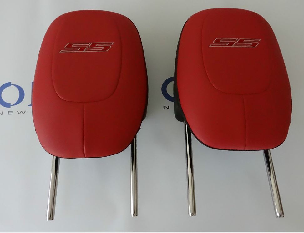

Yeah, i'm just not sure if the inferno headrest covers come with the SS stitching
Been looking at Inferno for a couple of years ...
Yes - OEM Inferno available with SS Logo.
On ebay now for $99 for the pair (new):
http://www.ebay.com/itm/2010-14-Cama...RSZu-W&vxp=mtr
Looks like a special part number. Good looks on that, gonna add that part number to my other post in the cosmetic section so that anyone else looking can check these
