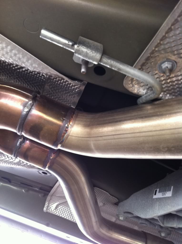

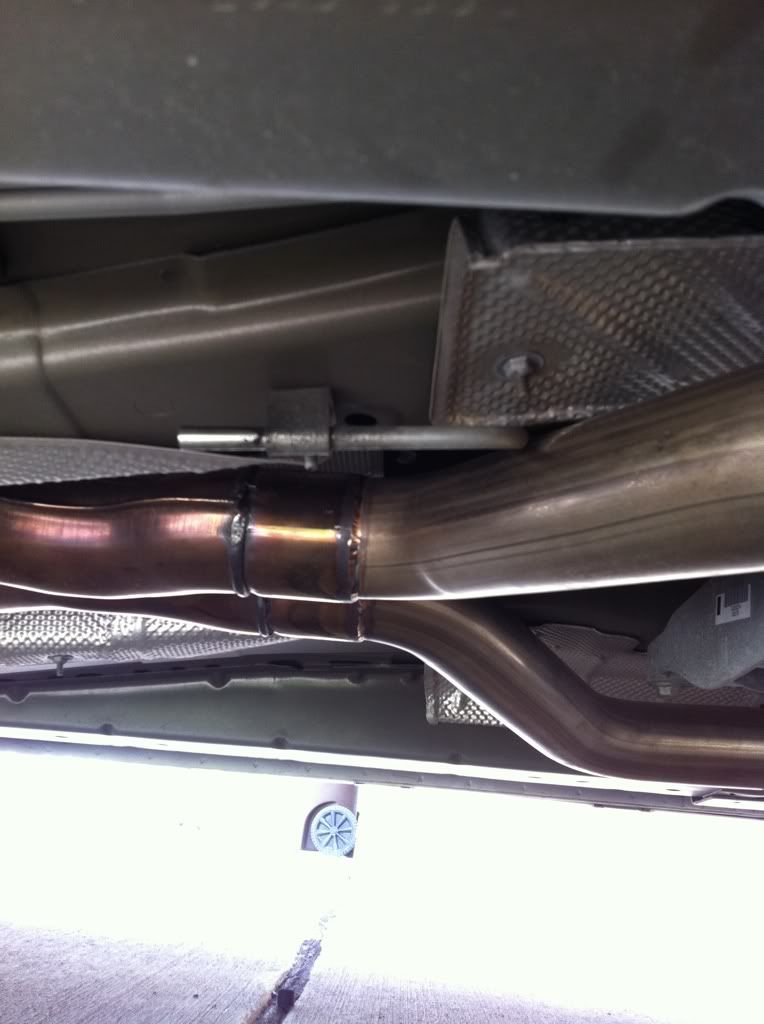

Okay so we finally fixed the gaskets and guess what? The sound is still there. Well we didn't give up there. We look through the entire exhaust and found a tiny little pipe right next to the X-pipe. I guess it's supposed to be the transmission vent. We put it on a jack and cranked it up and confirmed the sound. Is it safe to cut this tube/vent?

I can't answer your question...But nice find
