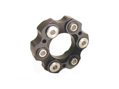

PROTHANE makes an upgraded Driveline Coupler
