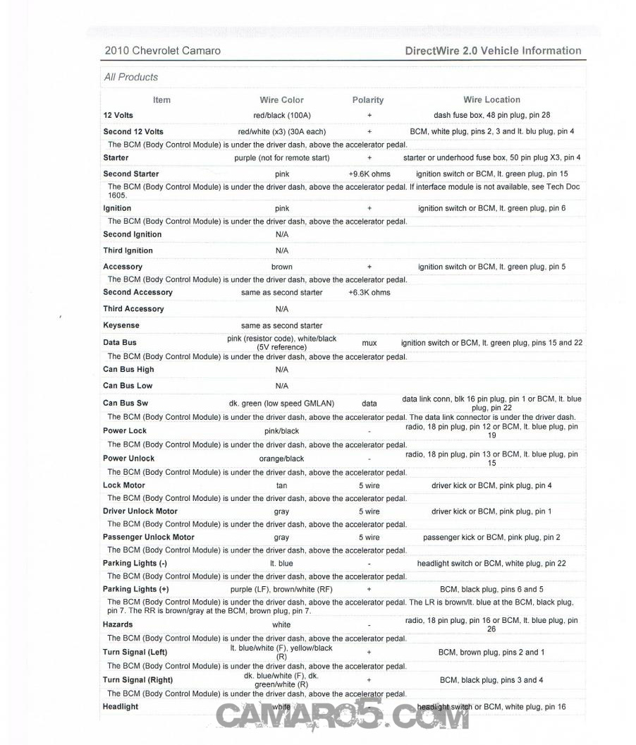

Maybe this will help you out.

Yep, Stephens beat me to the diagram. What you want to do is find a always hot fuse. Hold on, I need to ruffle through some files (while I know that you're not actually waiting I am looking for it mid-post).
There you go. First fuse on the list.
