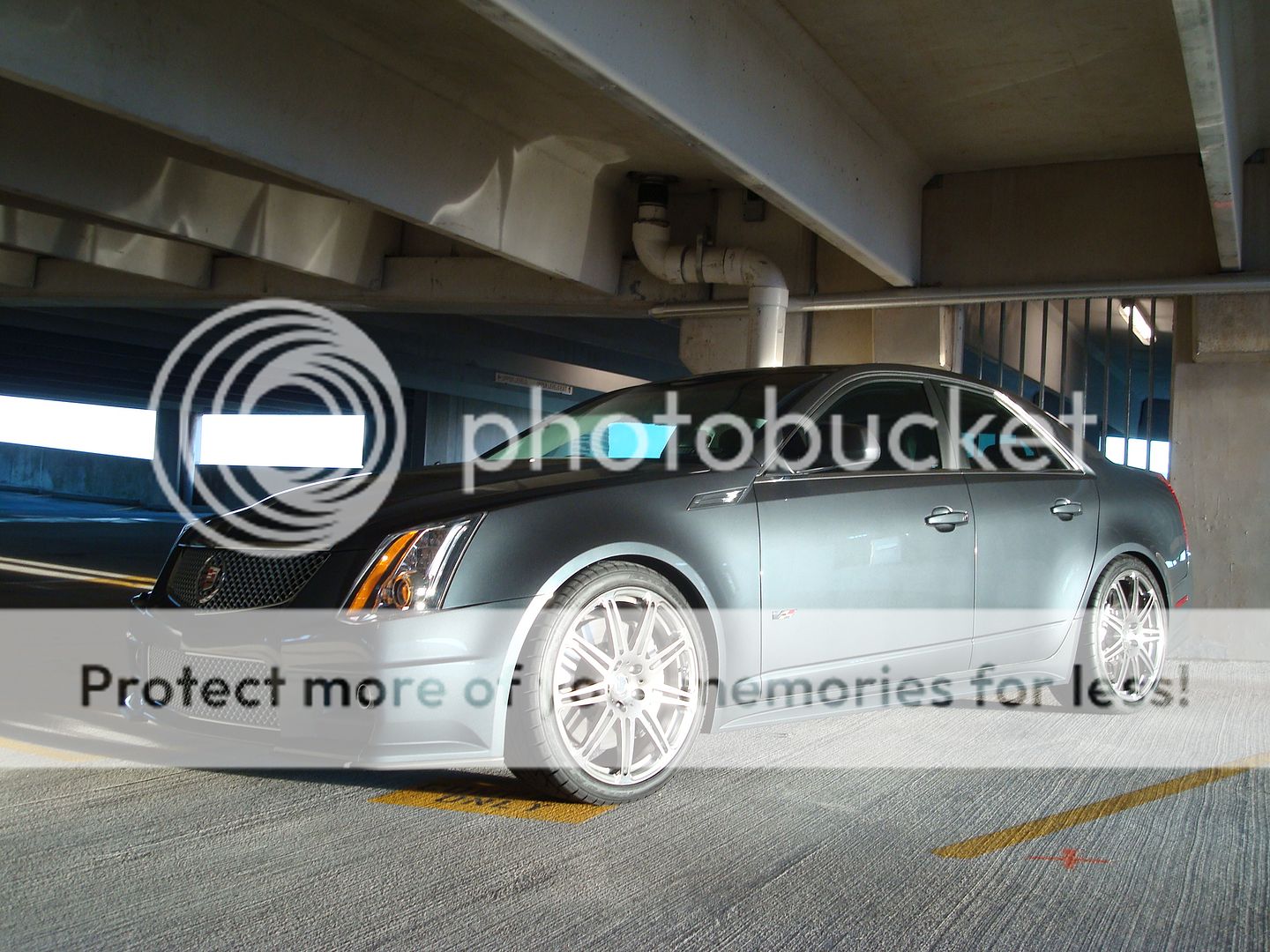

You guys are correct. My D3 lowering springs came with tiny rods to replace the factory rods on each sensor at each wheel. Basically fools the computer into thinking the car is still at factory height. Ride quality is unchanged, but that will depend on the spring rates that ZL1 spring makers use too. Mag ride still works like a charm, I actually prefer driving the car with it on at all times. 21K miles so far, no issues.

Perfect Nine'

One sexy looking Caddy! And as a previous poster said, awesome plate!
