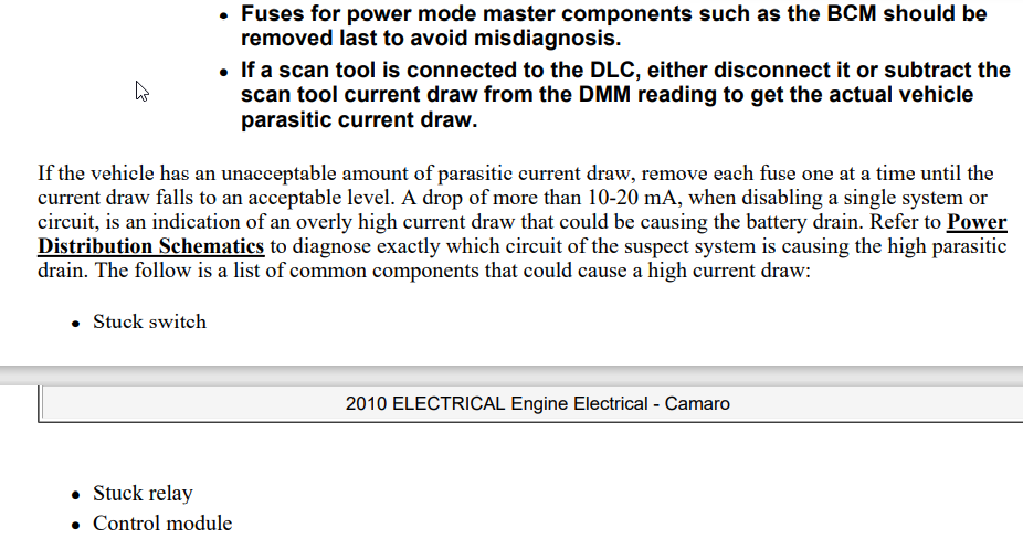

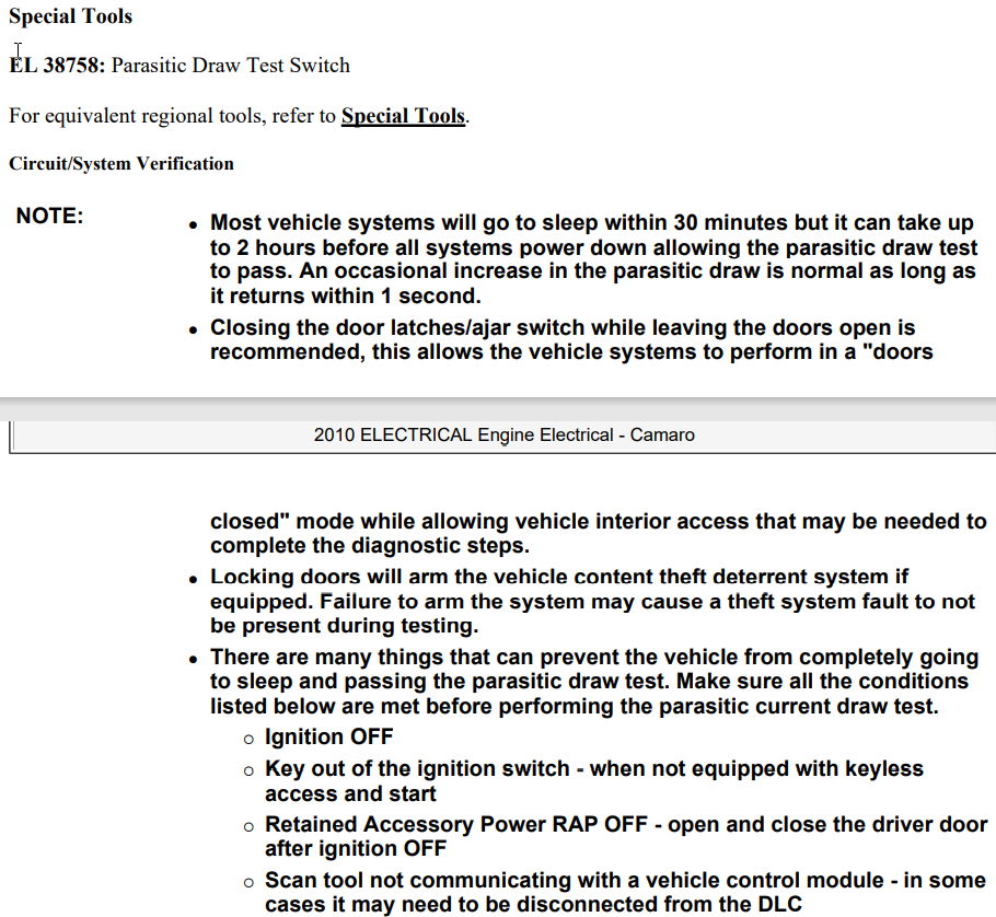

Battery voltage drain problem generator weak short in wire
Battery voltage drain problem generator weak short in wire accessory draining battery testing procedure. Today's post will be the manual to determine if voltage draw is normal or not and why your battery keeps going down. Included is simple generator test information. Note that the system doesn't go into sleep mode immediately. I noticed a recent post about that his drain on battery was too high but it was because it wasn't in sleep mode so this information will help determine if there is or not a parasitic drain too high on the battery: here goes 8pages
