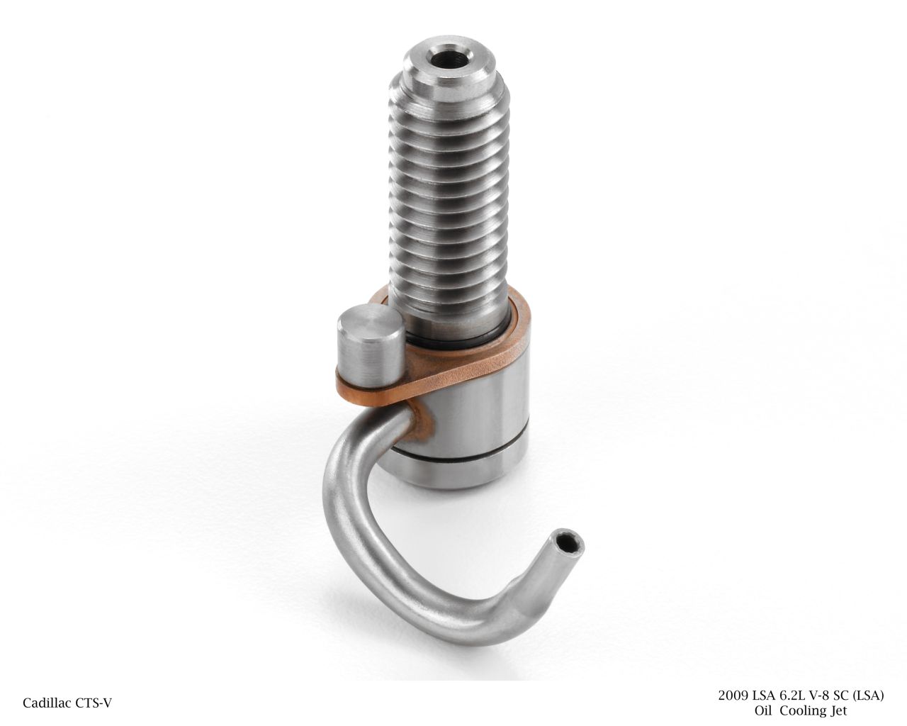

IMHO - you need to establish your goals and expectations first. If you're looking for 700 FWHP, you should be fine with the LSA bottom end with a good tune. You're going to see eleventybillion negative posts about hyper' pistons in a few minutes and most of those always leave out the fact there are oil-spraying nozzles for LS9/LSA to help with the heat and it's not like these are standard LS3 pistons in there. There's lower compression so detonation can be kept at bay for longer. It's already got a forged crank and PM rods.

The lsa doesnt have oil squirters, only the ls9
wrong

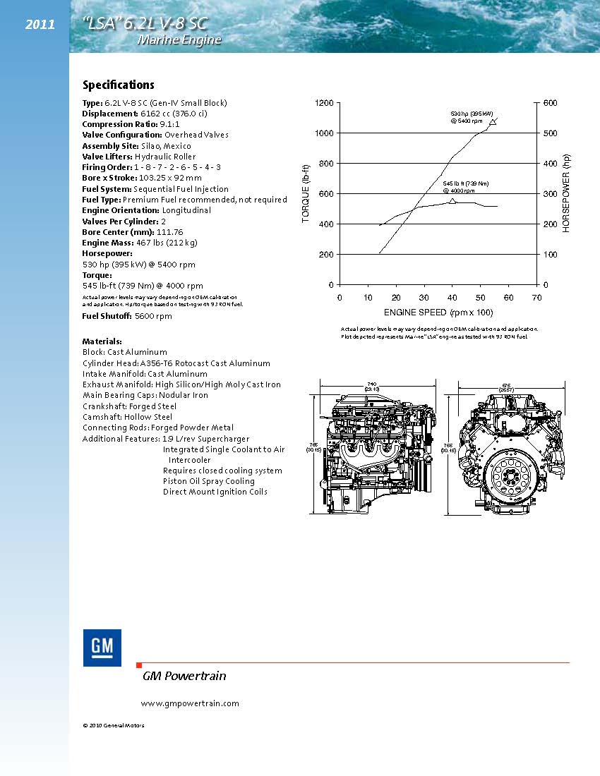

Posts: 15,788
http://media.gm.com/content/media/us...rolet/0208_lsa
Just off the top of my head...
'20 ZL1 Black "Fury"

Just to be clear (focus around the rods)
Components and design elements that contribute to the LSA’s performance include:
Balanced, lightweight reciprocating assembly
High-strength hypereutectic pistons
Sixth-generation Eaton supercharger with four-lobe rotors
Center-feed fuel system
Piston oil squirters.
ShnOmac is offline   Reply With Quote

I guess we can safely say there are piston cooling jets.
