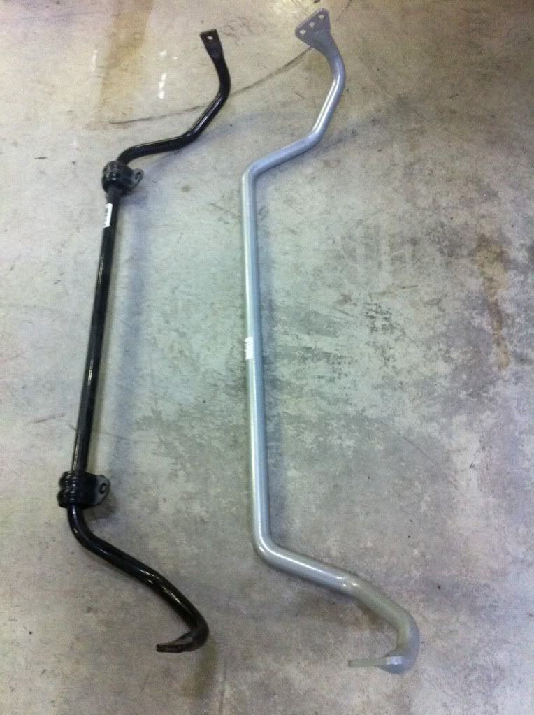

We we finally got a few minutes to put this thread together.
We just wanted to showcase the Whiteline Adjustable sway bars.

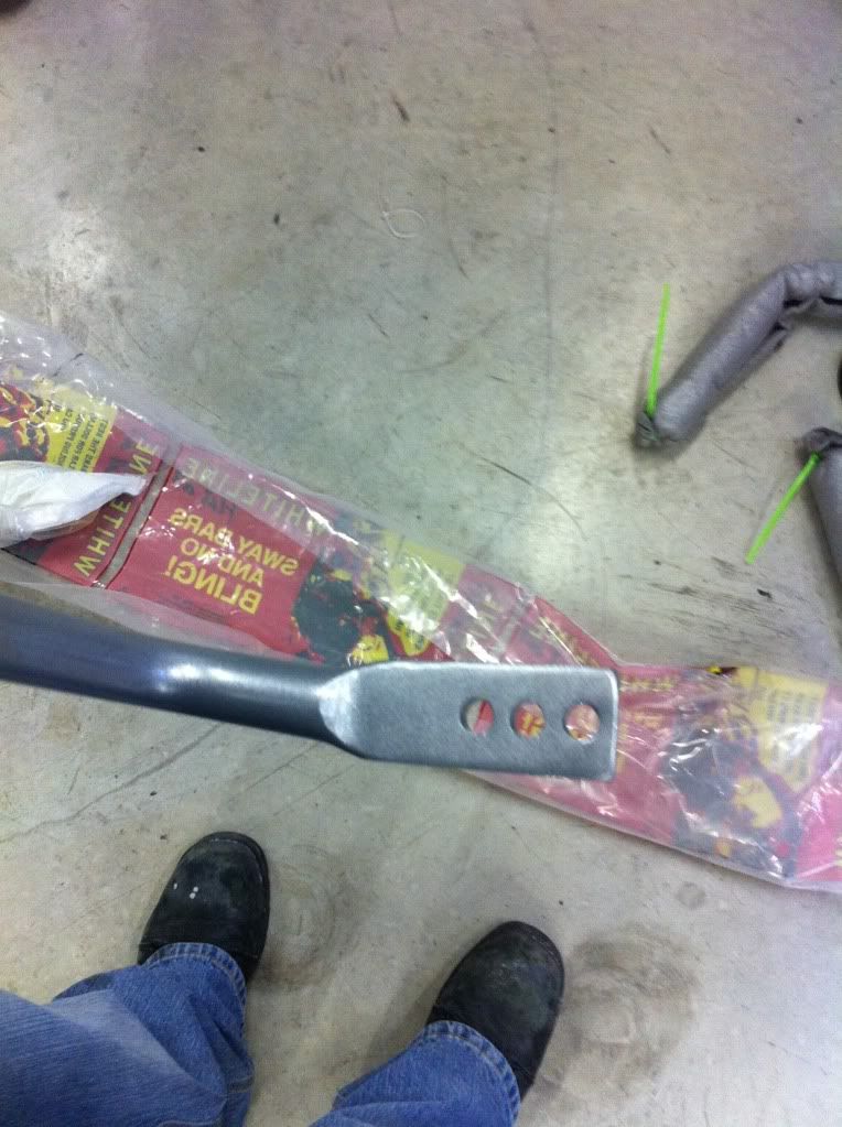

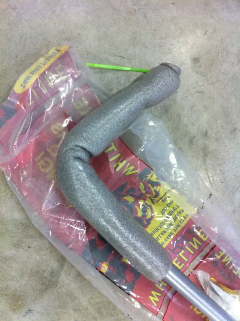

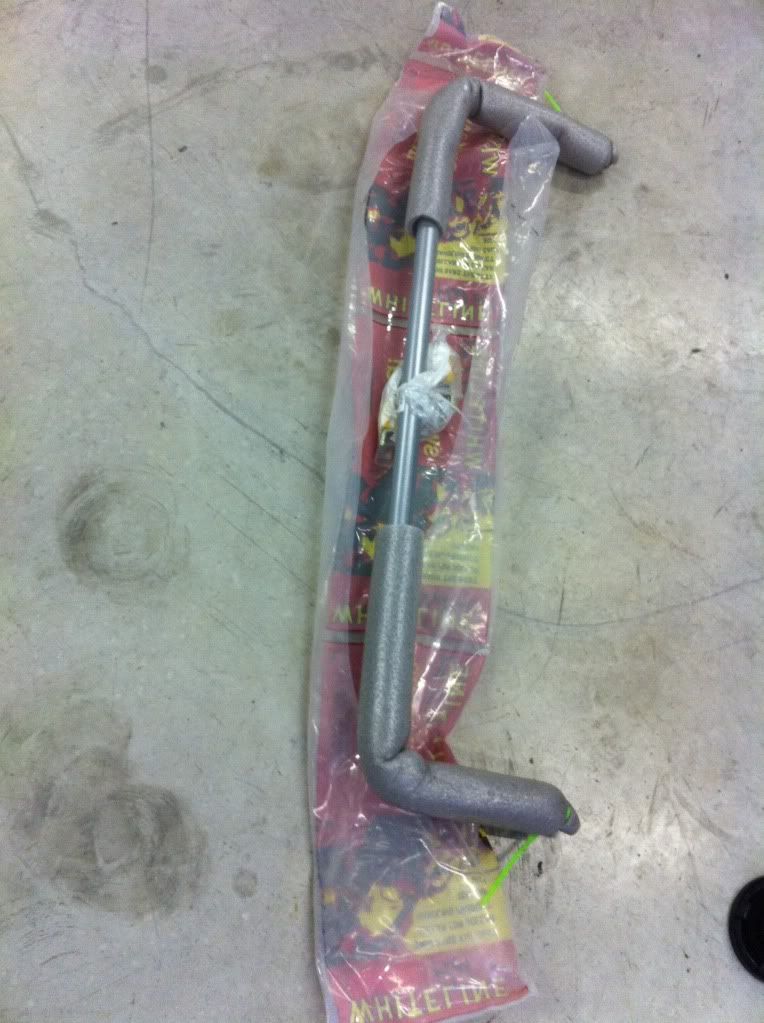

This is how your whiteline bars will come packaged.

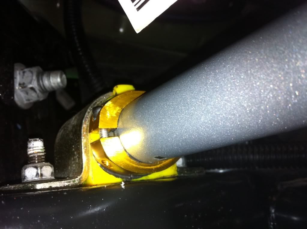

Here's a Look at the rear.
All whiteline sway bars now ship with lateral locks.

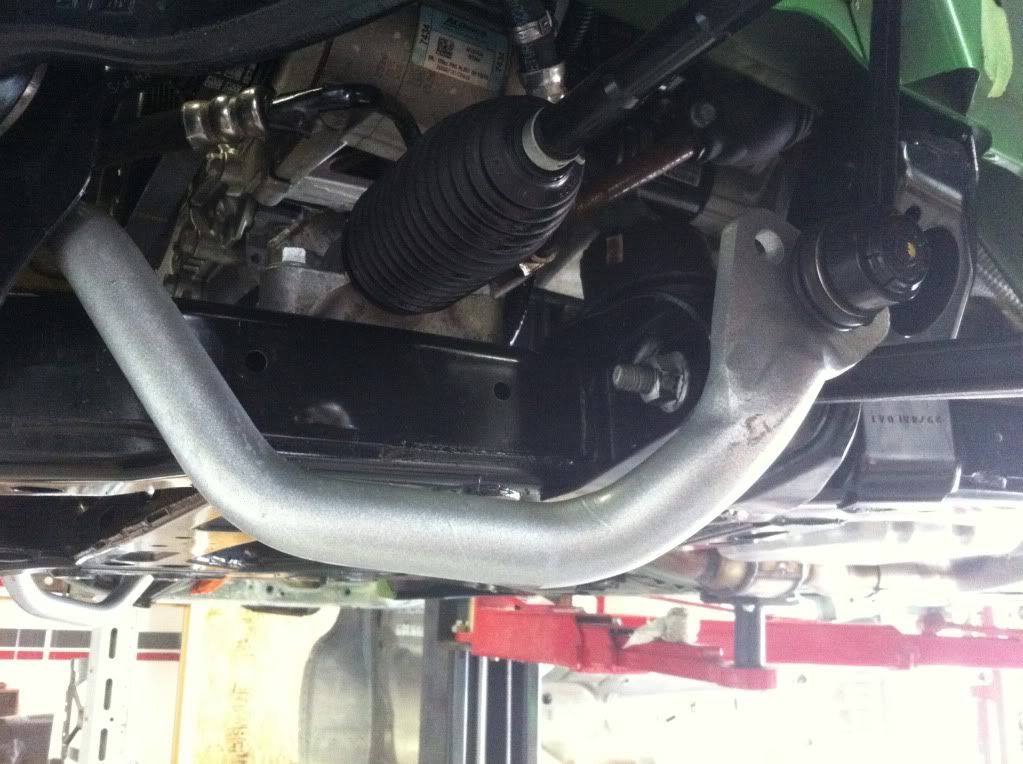

Front.

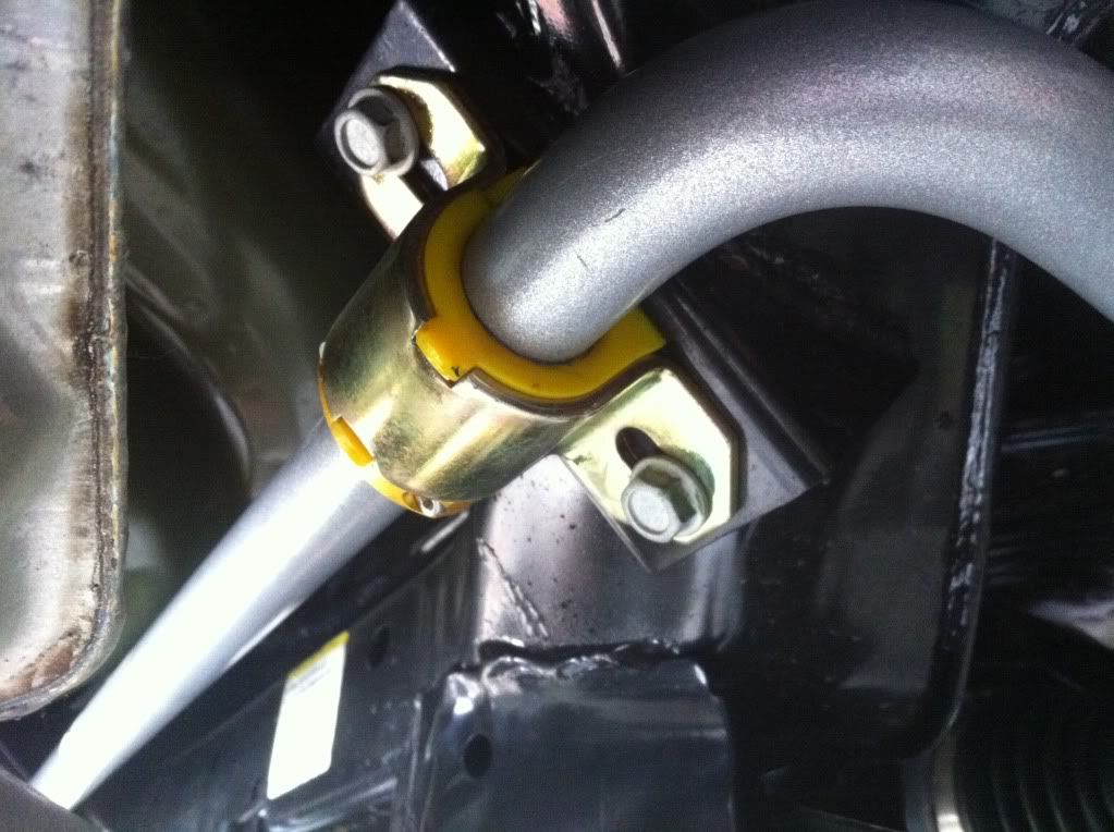

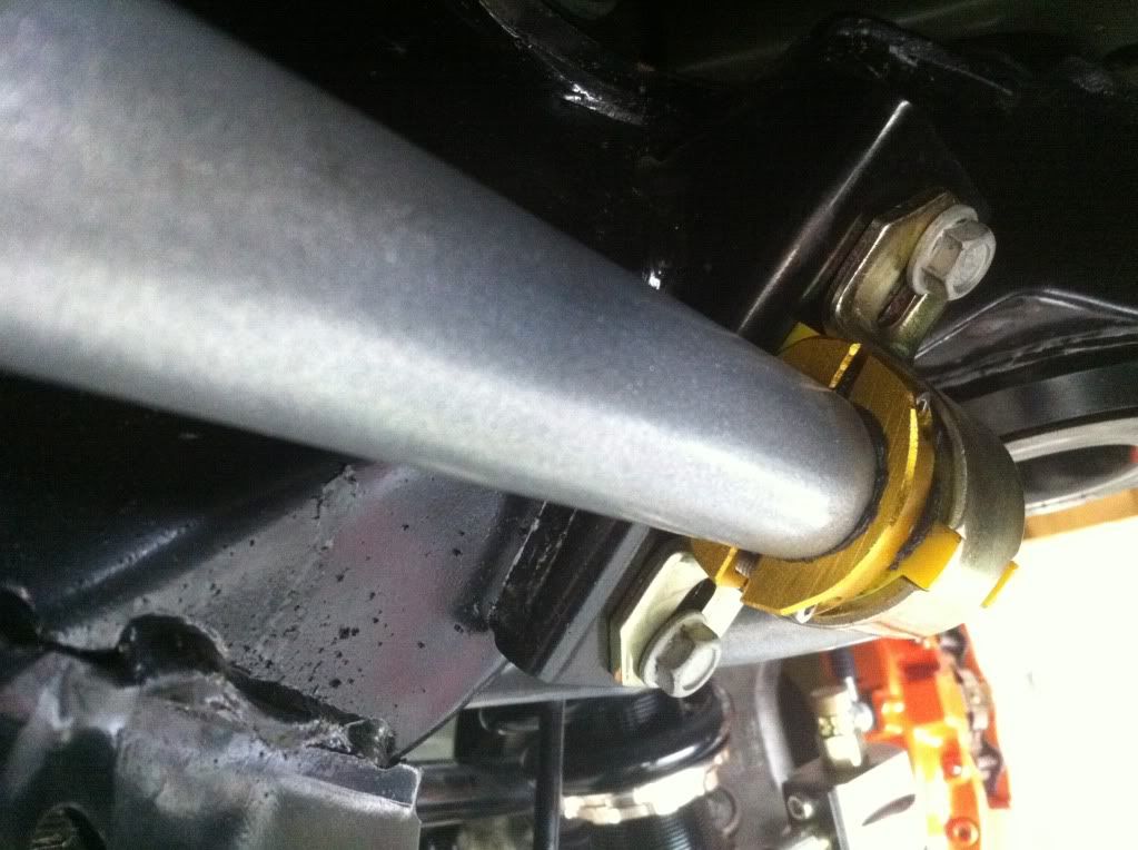

Here's a look at the front Bar.
Prior to the install the car still had a bit of understeer. Moving the rear endlink to the stiffest setting and the front endlink to the middle eliminated the understeer that was left with just the bushings/coilovers/alignment.
