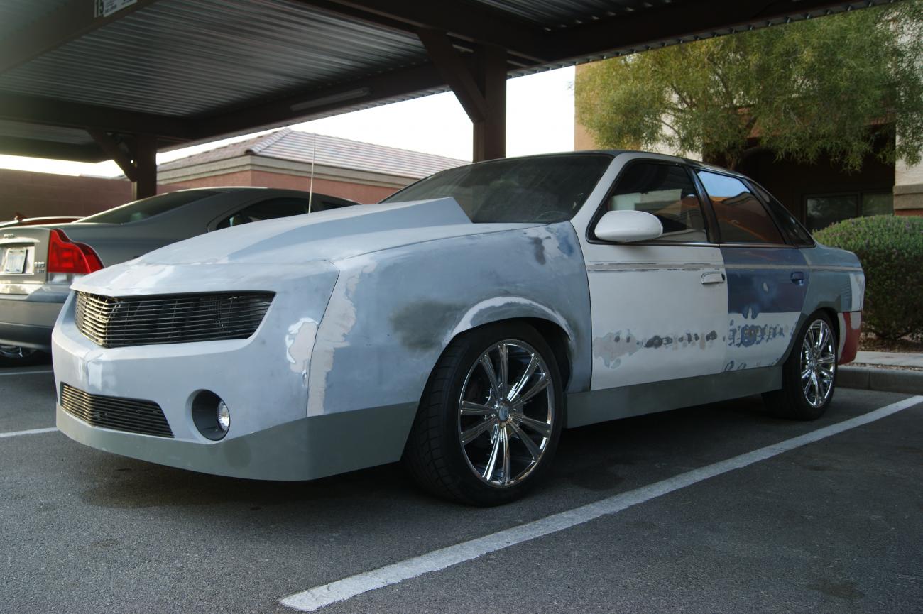

Now we got a front end, time for fenders. This was not going to be easy, maybe the hardest part of the entire build. One day I got up and was like, it’s time to cut off the fender. Buzzzzzzzzzzzzz went the angle grinder and gone went that nice $50 fender. I only kept where it mated to front doors. I started all my metal fabrication projects with card board templates I traced onto the sheet metal and cut out. I made the front fenders in 3 pieces. One giant piece from bumper to Ford part. One down to what I thought would be the bottom and finally the fender flares. How did I make them? Milk crate. Milk crate? I put the flat piece of sheet metal I had cut out to look like the fender on the ground and set a milk crate on the part I needed the bend to be. I put all my weight, 165 lb, on it and simply bent the 16 gauge sheet metal by hand until I had the shape I was after. I also used a hammer and dolly set for finer details.
The lower piece was easy to make, tricky to weld with my fledgling skills. I actually had to come back to some of my welds later. I ground off bondo down to welds and redid a bunch. Oh well Second hardest part was those tricky fender flares to cover my big ol 18” tires. It took me forever to figure these suckers out. Like it’s curved on both sides! Once on the car I simply trimmed one side to match the other. Speaking of the other side, that wasn’t easy making it all match! Passenger side came first so I could do the best job on the driver’s side or the one I would see walking up to car. Getting them to match wasn’t nearly as hard as making it all look correct and perfect later…

After the fenders I wanted to butch up that hood a little bit I mean my license plate is TOXCESS after all so I copied as best I could the COPO Camaro with a sweet 5” cowl induction style hood. Again you can see I made a cardboard version, then metal and I simply welded that sucker onto the Taurus hood. Functional? Fu$* no! Bad ass, can I get a hell yeah?
A buddy said and I quote, “yo, that hood goes hard!” After all this fabrication and hard work I needed a break and did my usual fun, LED’s!!! I did some RGB rings in headlights and grilles. I imagine I have more planned later, muah ha ha!!!

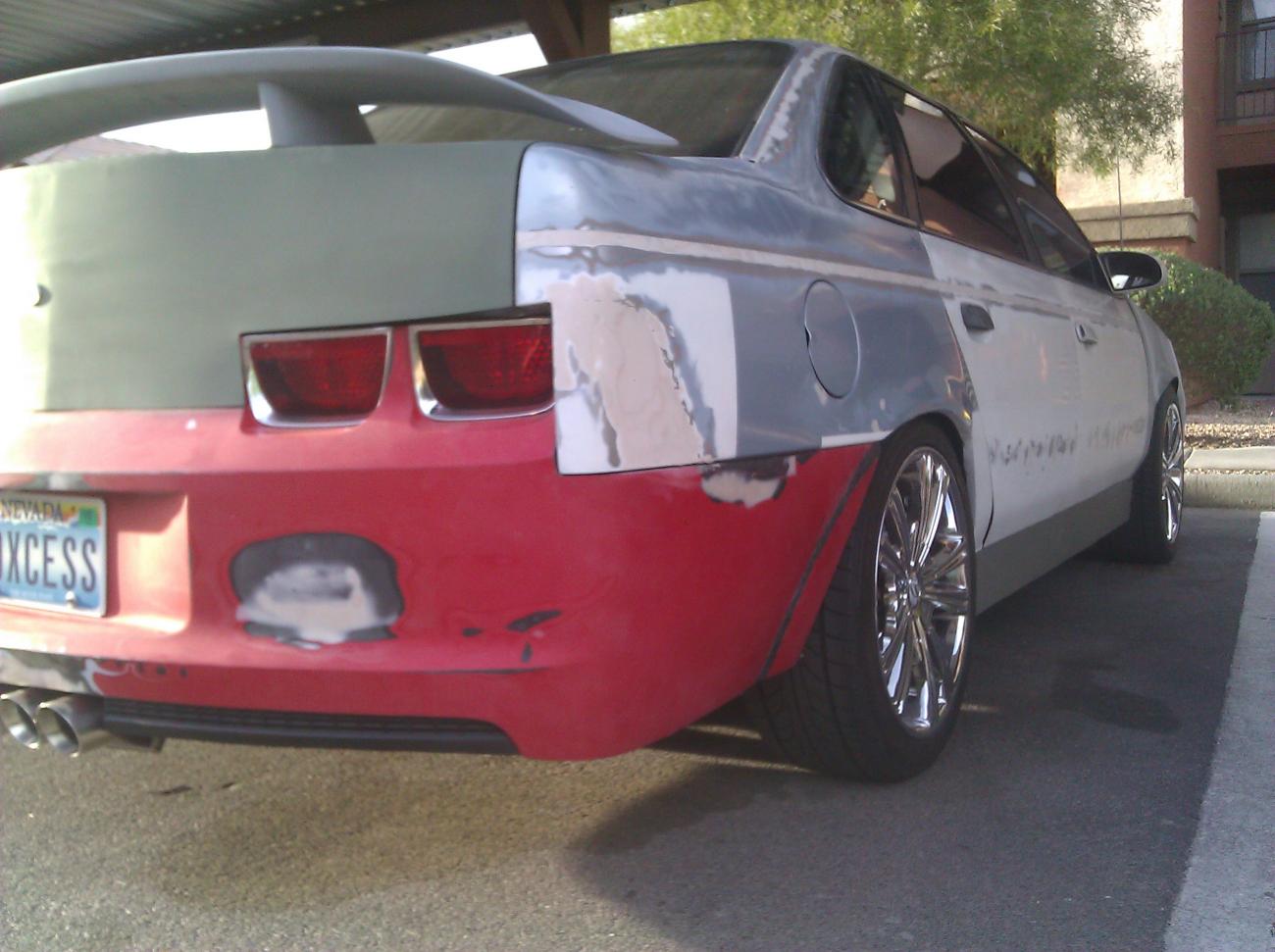

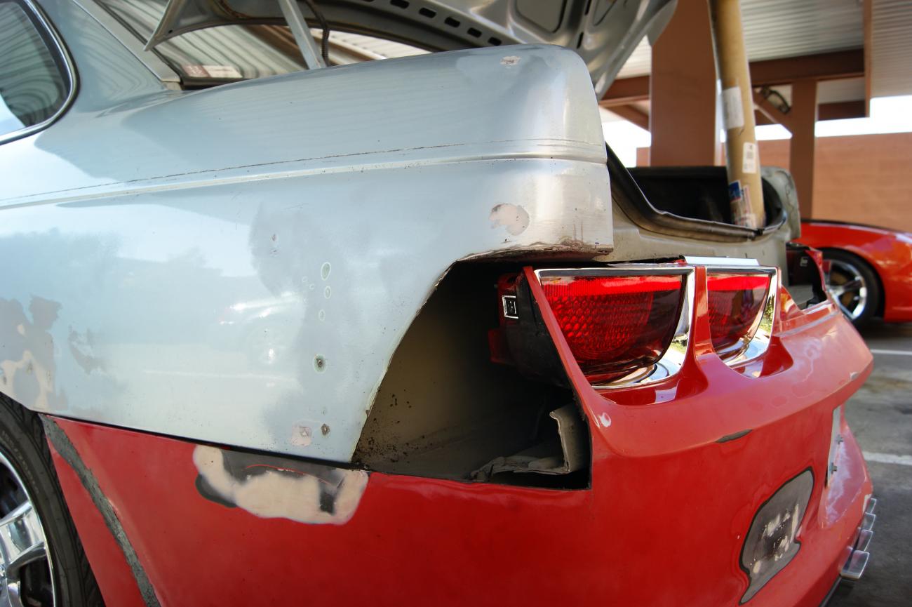

Initially when I talked about all this with Gene Meek once at Spring Mountain Raceway in Pahrump, NV we thought the rear would be the hardest. Well, it wasn’t!!! Front end probably took 3 months, rear took a couple weeks! Yup, by then I had gotten a little better and did it all in 2 weeks. First step was getting that big ol bumper stuck on there. To get it in there I had to cut out a lot where the Taurus tail lights were, just like the headlights. Look below, yeah that fit!!! It nearly touched the ground and hung way off the sides. To make it fit I trimmed off the excess on bottom and then used a heat gun to pull the sides in. Pretty neat trick, huh? I narrowed the bumper without cutting it down, slick $hit! To mount the bumper I bought the real Camaro center plastic clip from GM for like $15. The sides have one screw in the very leading edge and a 8mm Taurus bolt down low holding them steady.

I had already removed the back up and marker lights to clean things up, but how was I gonna get the corners to work. Hmmm, and make it look good and make it look tough? How about shrouding them in all evil like! I cut off the triangular Camaro bumper corners and where the Taurus tail lights went. I then fab’d up a cute little panel to fill the space I made. Again hand bent and designed it by molding the squared off Taurus body to meet the rounded corners of the Camaro bumper. Crazy panel to make and again TWICE! With the bumper fitting it was time to make the trunk fit. First step was adding a rounded panel that drops down between tail lights, easy peasy! Then I wanted it to round up in the middle so buzzzzzzzzzzzzzz went the angle grinder. With the shape dialed in I simple put a lid on it! Still learning welding I got this sucker on there but good! I also made the tail lights like cat’s eyes or like the Eye of Sauron, Lord of the Rings reference
Now for smaller details, to make it prettier How about that spoiler? Yup, it’s curved out like trunk and curved down too sides perfectly fitting in every way. How’d I do that? Bought a new unmodified Dodge Charger SRT8 spoiler for $78, that’s how! Exhaust time, inspired here by new Corvette Stingray, but on a smaller scale. Actual C5 Vette tips mounted closely together. The side pieces were what’s left of the rear diffuser. Remember I was really close to the ground so minimal here was the key. This stuff came together so easily and I think the rear almost looks like a real car. Later I did add some material to sides to match the side rockers that come later and curved them in to make the rear look like the 67 Camaro with tires sticking out stance. I even had to mount my back up lights underneath the exhaust, where else!!!
