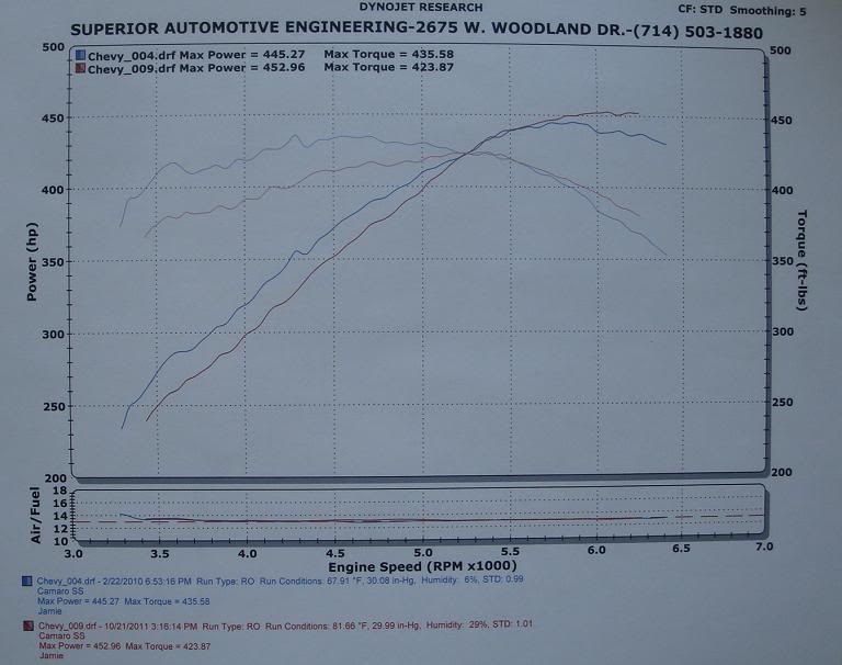

Here is a dyno comparing the old VVT cam vs the new non-VVT cam. Only two things changed were the cam and the heads. The new heads are LSA's with a bigger chamber to lower cr(10.38 vs 9.28) vs the old L92 heads. You can clearly see I lost a lot of low end tq getting rid of the VVT. The only reason for the change is to be able to run a lot of boost.
Same dyno just different days. Blue is VVT Red is after LS3 conversion.
You have two completely different setups with different HP/TQ numbers. So this really isn't worth comparing track times.
