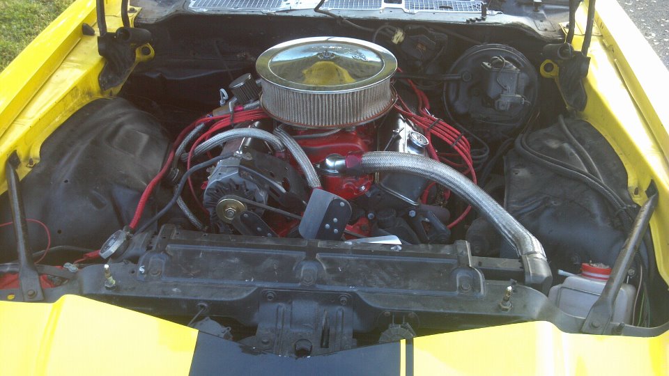

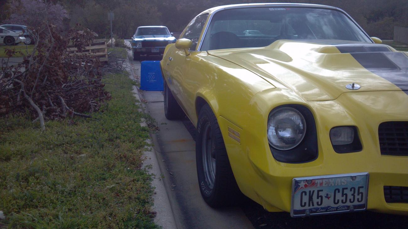

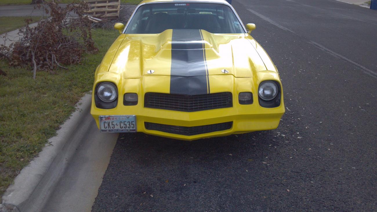

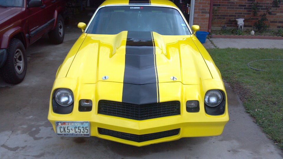

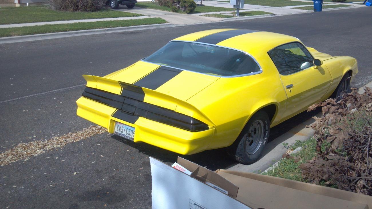

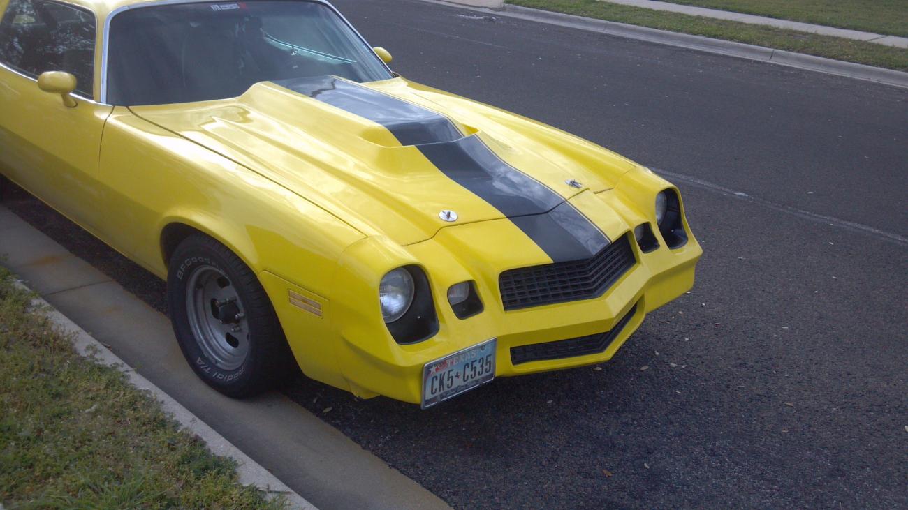

what do u think about this car?

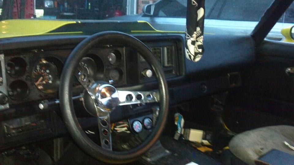

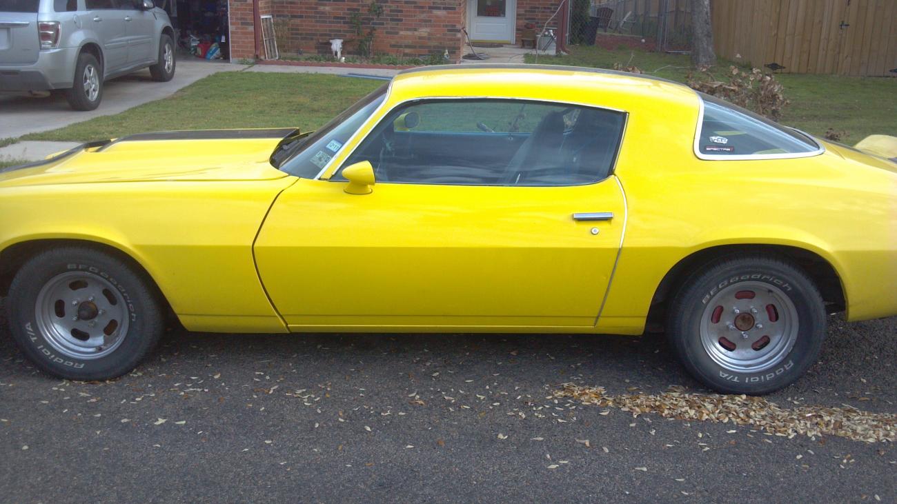

so someone's is selling this car for $2.5k, im kinda interested with it, but let see if dadd say yes to this as my DD. what do u say about this car? i ask him to email me the details of car and this what he said. what do u think of this car?
Needs either the seats re-done, or new seats, center console ( current center console is some home made sh*t ), door panels, window guides ( so they dont rattle ), one window roller. Other than that the car has treated me well. Driven it to and from work for a month while my daily driver broke down. Done multiple trips to waco and back with it. The speedometer doesn't work. Other than that it's a fun car. Long tube headers, flow master f-40 exhaust, aggressive sound to it. Passed all texas inspections when registered in texas. Clean title on hand.
I don't know the miles, the gauges for speed and mileage dont work. But temp, oil pressure and volts work. I put royal purple 10-30w, and premium oct in her.
she's never broke down on me once. yea, i put a partial down payment on a car, and the rest is due, hence the low price :-/ sucks but i have to do what i have to do ya know.
here's the picture. oh btw can u guys tell me what year of this car and the generation?

This is a second gen - not so fond of the color and stripes and appears to have been used hard over the years but the body looks solid.
Have a mechanic take a look at it for you especially if it is going to be your DD.

Doesn't look too bad. Stripe is a bit odd, and I'm sure those taillights are illegal painted that dark...But it looks to be a stick? That's a plus! Make sure the body isn't full of bondo, check the frame rails to make sure they aren't rusted out, give it a test drive, and if you like it go ahead and make an offer. Price doesn't seem ridiculous but the car does need some work.
And the car is a 78-81 model, 2nd gen. Can't tell for sure but I would think the owner would know??

It's got a 79 - 81 dash in it.
Check the vin# (look thru the lower drivers side windshield on the dash)
It will tell you the model and model year of the car. Also the date (Month and year) of MFG is problably on the drivers door.
1979 -- Vehicle Identification Example: 1Q87G9N500001
First digit is GM Division: 1 = Chevrolet
Second digit is model: Q = Sport Coupe, Rally Sport and Z28, S = Berlinetta
Digits 3 & 4 are body type: 87 = 2dr. coupe
Fifth digit is engine code: D = 250ci, G = 305ci, L = 350ci
Sixth digit is model year: 9 = 1979
Seventh digit is N for Norwood assembly, L for Van Nuys.
Last six digits increased one with each car built at each plant.
1980 -- Vehicle Identification Example: 1P87LAN547484
Second digit is model: P = Sport, Rally Sport, Z28, S = Berlinetta
Fifth digit is engine code: A = 231ci V6, H = 305ci V8, J = 267ci V8, K = 229ci V6, L = 350ci V8.
Sixth digit is model year: A = 1980
1981 -- Vehicle Identification Example: 1GlAP87K6BN100001
First digit is Country of Origin: 1 = USA, 2 = Canada.
Second digit: G for General Motors.
Third digit is Division, 1 = Chevrolet.
Fourth digit is restraint system: A = non-passive, B = automatic belts, C = inflatable restraint.
Fifth digit is series: P = Sport Coupe, Z28 Coupe, S = Berlinetta
Sixth and Seventh digits are for body style: 87 = sport coupe.
Eighth digit is engine code: A = 231ci V6, H = 305ci V8, J = 267ci V8, K = 229ci V6, L = 350ci V8
Ninth digit is a check digit.
Tenth digit is model year: B = 1981 Eleventh digit is N for Norwood assembly, L for Van Nuys.
