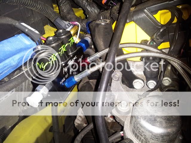

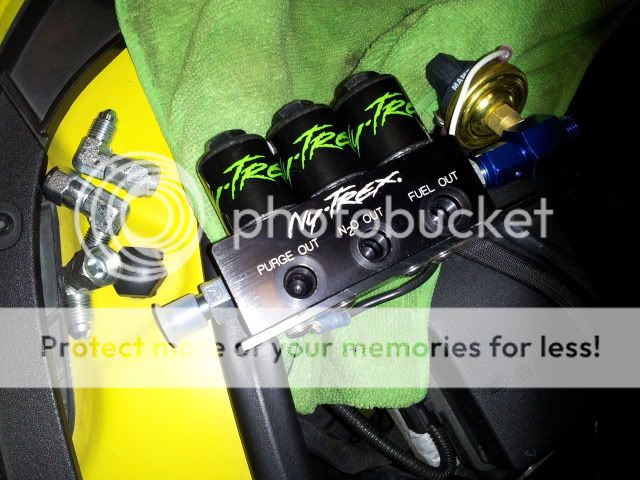

Well just finished installing the kit. Took me and a friend 4 hours to do. Was not very hard. Hardest part was getting the schrader valve out. Bought a valve stem removal tool from advanced auto. Took care of that. Other than that the directions are strait forward. If you have basic tools and some patients then it is very easy. Now just need to get the tank filled. I put in the jets for the 50 shot to start with and will go from there. Will post pics tomorrow. almost 2am. Time to crash. Do have one question. When I push the purge button I can hear the Solenoid click but when I push the WOT switch i get no click. I am assuming this is because of the Fuel Pressure Safety Switch? Car needs to be at wide open for it to activate the Solenoid?

Make sure you get your pressure gauge in the bottle before you fill it. The fuel pressure switch must have full pressure BEFORE the WOT switch will work. Keep pressures in the Upper portion of the green band around 1000psi. On a 50 shot you will feel a nice push in the seat of your pants. Nothing like the fake stuff on Fast and Furious " AT THIS SETTING". Enjoy the kit you will find yourself having fun very quick once you try it. I have had my kit for about 6 months and about 125 runs all is working good. Make sure you have premium fuel when you spray. Any questions feel free ask.

The Fuel Pressure Switch is preventing the NOS solenoid to activate. You will have to use a screwdriver to cross the terminals on the FPS and then you should hear the solenoid click at WOT.
Congrats on the install. Can't wait to see results. Reemeber, No "Traction Control" or "Stability control". Good luck getting traction
