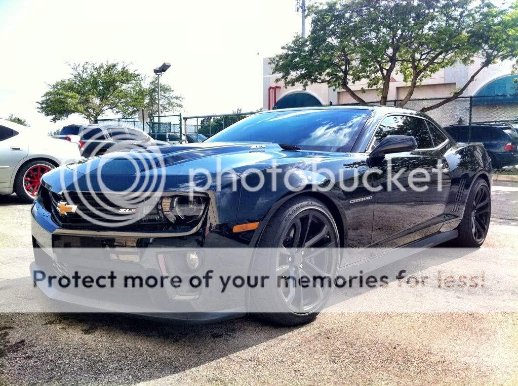

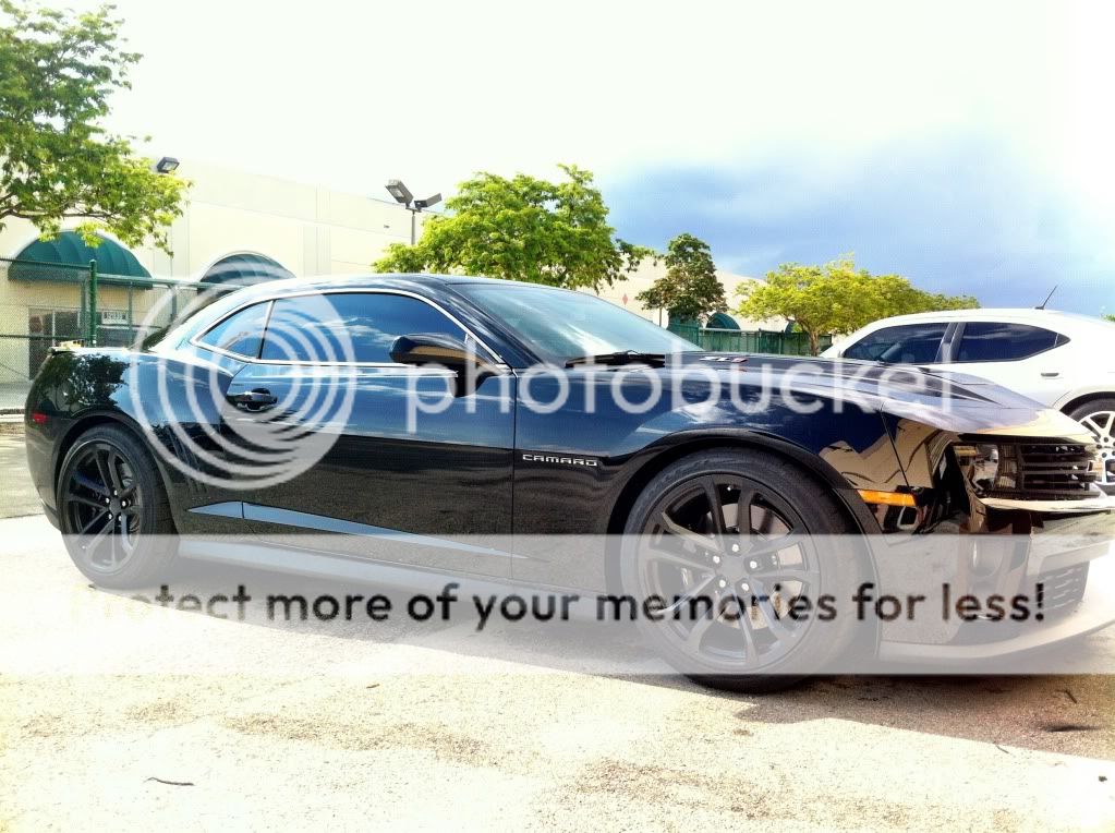

So today we finally got the opportunity to test some Pfadt Racing parts on one of our our Project ZL1's! And most importantly, their lowering springs
I will be posting tons of more info shortly once I get everything in the computer, photo's, vids etc but here is a sweet teaser shot for now
I have taken her for a good test drive and so far she feels absolutely amazing, but I will give my full impressions once the rain stops here and I can really feel her out. We will be putting a few test miles on her on the street and on the track to ensure the springs work in conjunction with the MRC and provides a nice upgrade over stock. Stay tuned!

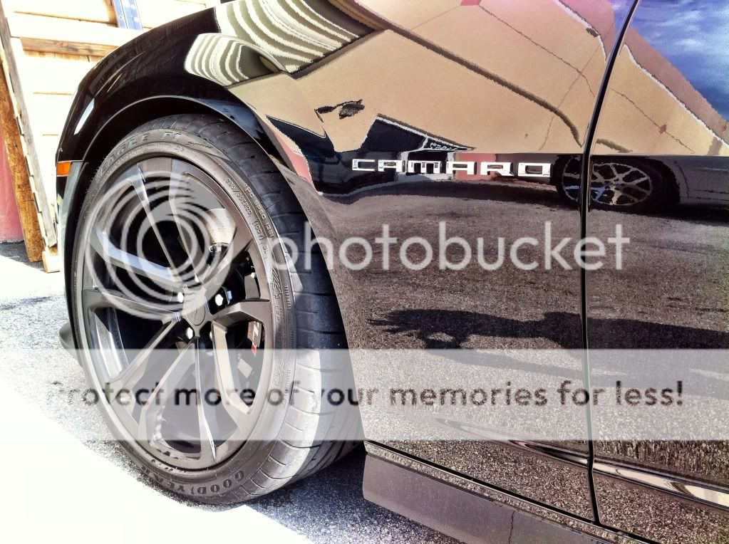

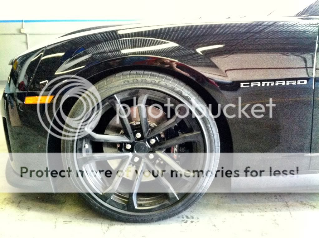

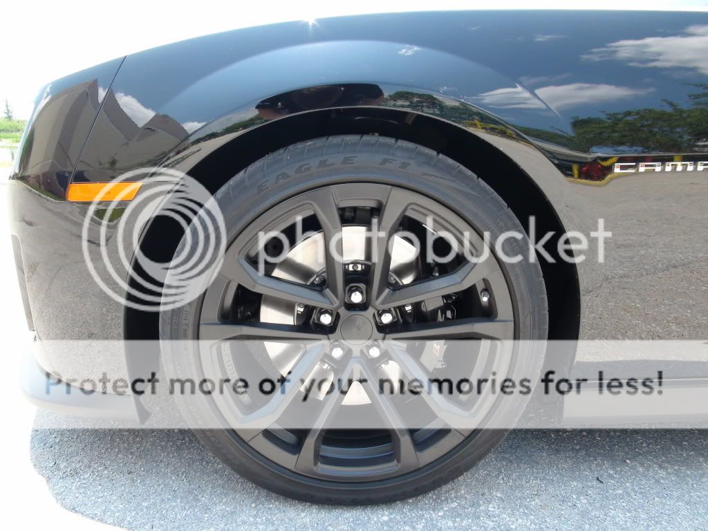

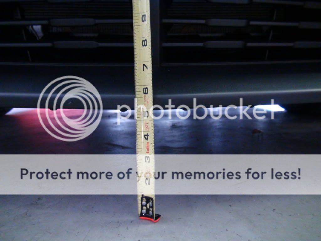

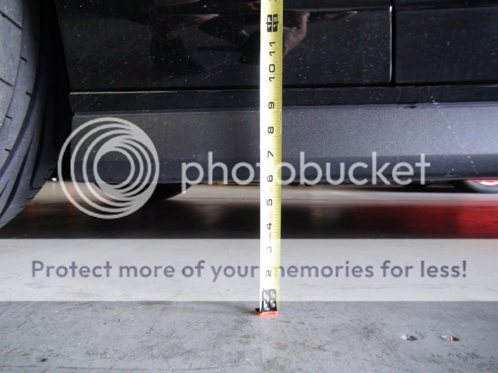

Personally I am very pleased with the looks of the car, the ZL1 comes somewhat lowered from the factory compared to the 4x4 stance that the SS had so in my opinion it did not need a huge drop. Plus as a road racer I think about things like suspension travel, chassis geometry and much more and I know that a "slammed" car is not really the best for performance. We measured about 3/4" drop in the fender wells and about 1" body drop. These might settle a bit more once we put some miles on them but I am happy it does not have a crazy slammed look. Also, by lowering it any more I think the front splitter will be the most common part to be replaced on these cars!

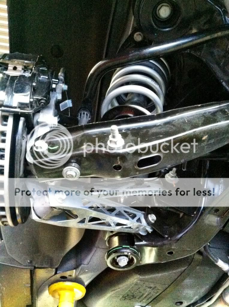

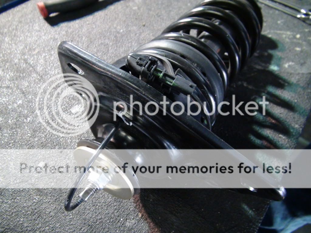

I will mention that install is pretty much the same compared to an SS except for one very important thing which you will see in the photo below! The sensor cable for the rear shock goes right through the shock and rear upper shock mount. There is no way of getting the stock spring off with this in place. If you are not comfortable with wiring, I would recommend having these springs installed by a professional!
STOCK RIDE HEIGHT SPLITTER CLEARANCE
LOWERED RIDE HEIGHT SPLITTER CLEARANCE
STOCK RIDE HEIGHT SIDE SKIRT
LOWERED RIDE HEIGHT SIDE SKIRT
FRONT FENDER STOCK RIDE HEIGHT
FRONT FENDER LOWERED RIDE HEIGHT
AND HERE ARE SOME BEAUTY SHOTS
