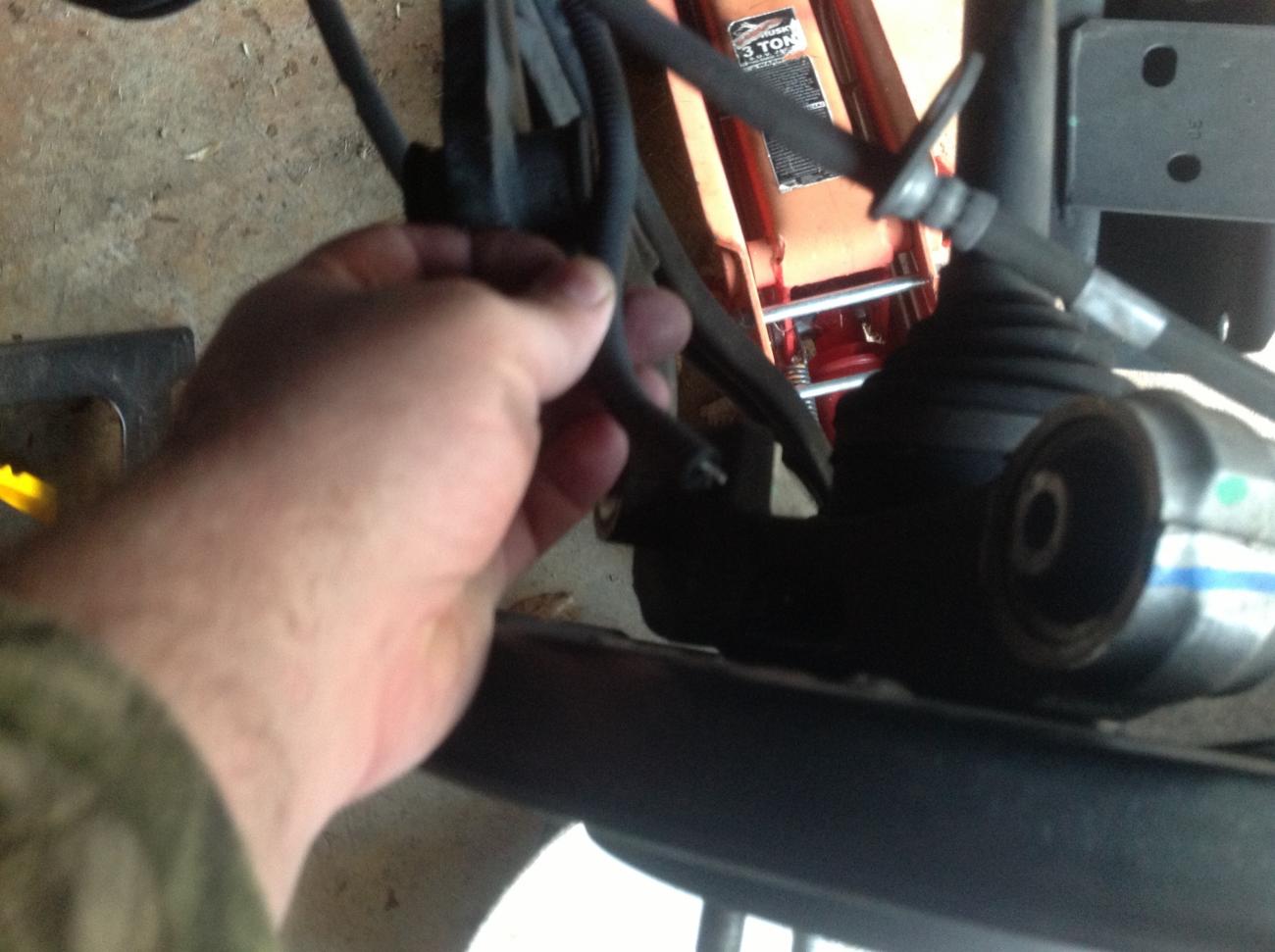

I was putting a 1LE diff in my car today and I broke what I think is the ABS sensor wire while popping the axel out of the diff. Does anyone know how to fix this? I have searched and found nothing. I need to fix it before putting the car back together.
Thanks in advance!

You'll have to buy a new one and replace it.

dont know the actual name of it but that little sensor you broke will be close to $400 to replace

I see a rear speed sensor listed on a GM parts website in the ABS section, but no pic. That's what that thing is..a hall effect sender.
It looks like its gonna cost you 20 at the dealer, or 11 + shipping online.

if there is enough wire sticking out of the connector just use but connectors

Looks like it broke flush where it goes into the plastic housing, like they always do when they get yanked on.

Thanks for the help guys! It did break off at the connector. It was a pain getting the axels to give following bmr's instructions. I'm gonna call the dealer in the morning and hopefully they have it in stock.

it must not be the sensor that im thinking about, i broke one on another car that i had, it caused the abs light to stay on all the time. the dealership charged me like $370 to fix it. hopefully its not much at all.

shouldnt be if i remember right when i had to replace mine because i sheered the splines off of the axle it was only like 30-50 $

WSS (Wheel Speed Sensor) is what that part is. Some of them can be extremely expensive. From what my tech program shows me you are lucky and the WSS they use on the Camaro are relatively cheap.

Of course no dealer or auto parts store had it in stock. I ordered it on Amazon for $10 with my prime membership so Ill have it tomorrow! Thanks for the info guys!
