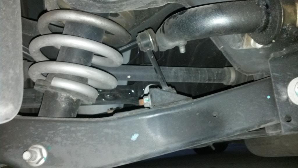

I bought the car used and I know it has pfadt sway bars but not sure if the previous owner installed anything else. How would I be able to tell and what should I look for? I am not able to contact the original owner or I would. Id like to strengthen the suspension if not already done. Thanks

Stock parts will be black, aftermarket parts are generally not. Depending on the part and the manufacturer they could be red, orange, grey, etc..

Take some pictures and post them. Focus around where the sway bars attach on the ends for both front and back. The fronts mount to the struts and the rear to the lower control arm. Generally in those areas you will see the most common mods such as bushings, control arms, etc. Also one of the vendors recently posted some illustrations of the Gen5 suspension. You those as a guide to locate where mods may have been installed.

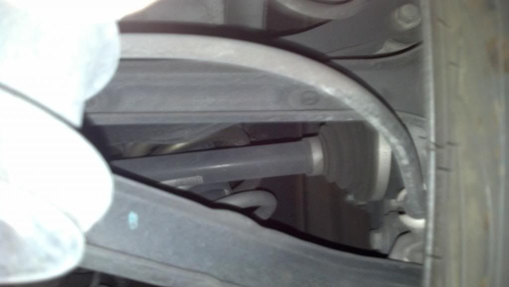

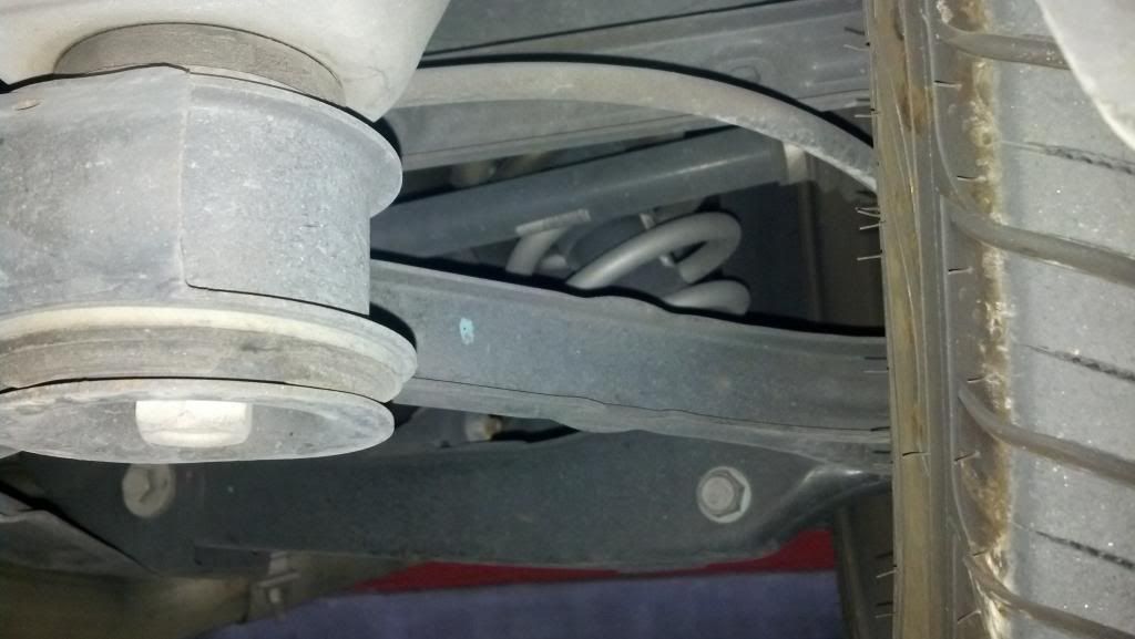

Here are some pics, had to upload onto different computer so different username.
All of the rear

From the pictures it looks like the only aftermarket parts you have on the vehicle are the Pfadt lowering springs and sway bars otherwise everything looks stock. I see you are in Tampa, FL, so are we and if you wanted to bring it by I would be more than happy to throw it up on a lift for you so you could check everything out.

Those are definitely our drop springs and sway bars. The previous owner likely installed our Stage 2 package, which conveniently enough consists of our Drop springs and sways!
