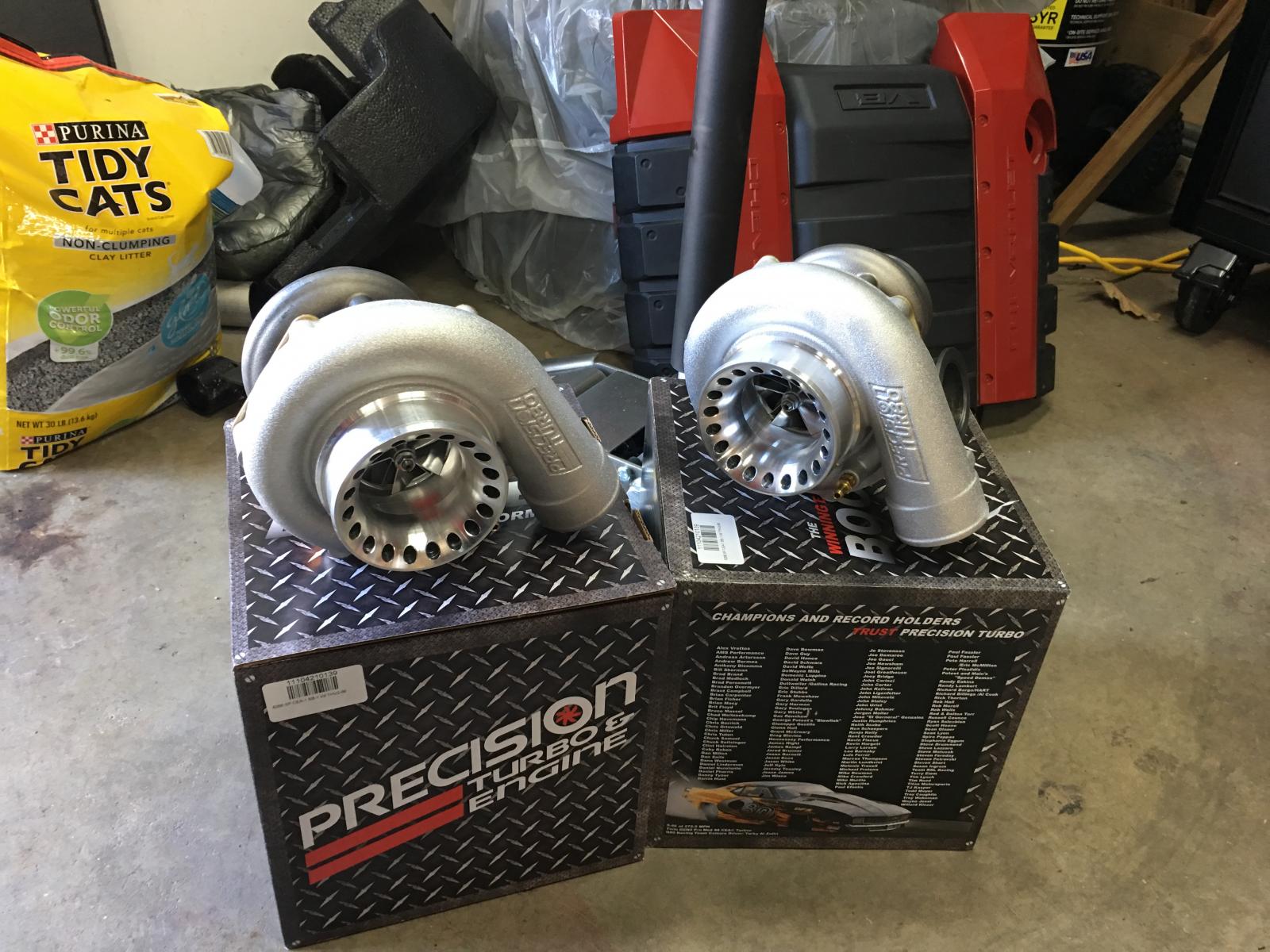

As the parts have started to trickle in, I have been feeling like a kid on Christmas morning especially opening those Precision Turbo boxes. I almost have everything delivered I'm just waiting on the rest of the Hellion kit (I received the turbos already). I'm planning on starting the build this weekend. I'll take a few pictures along the way to post here.

Originally Posted by camaro500 View Post
FU?&ING SWEET MAN! Post pictures of parts and build progress!
I'll post some pics of the mountain of parts when I get home tonight.

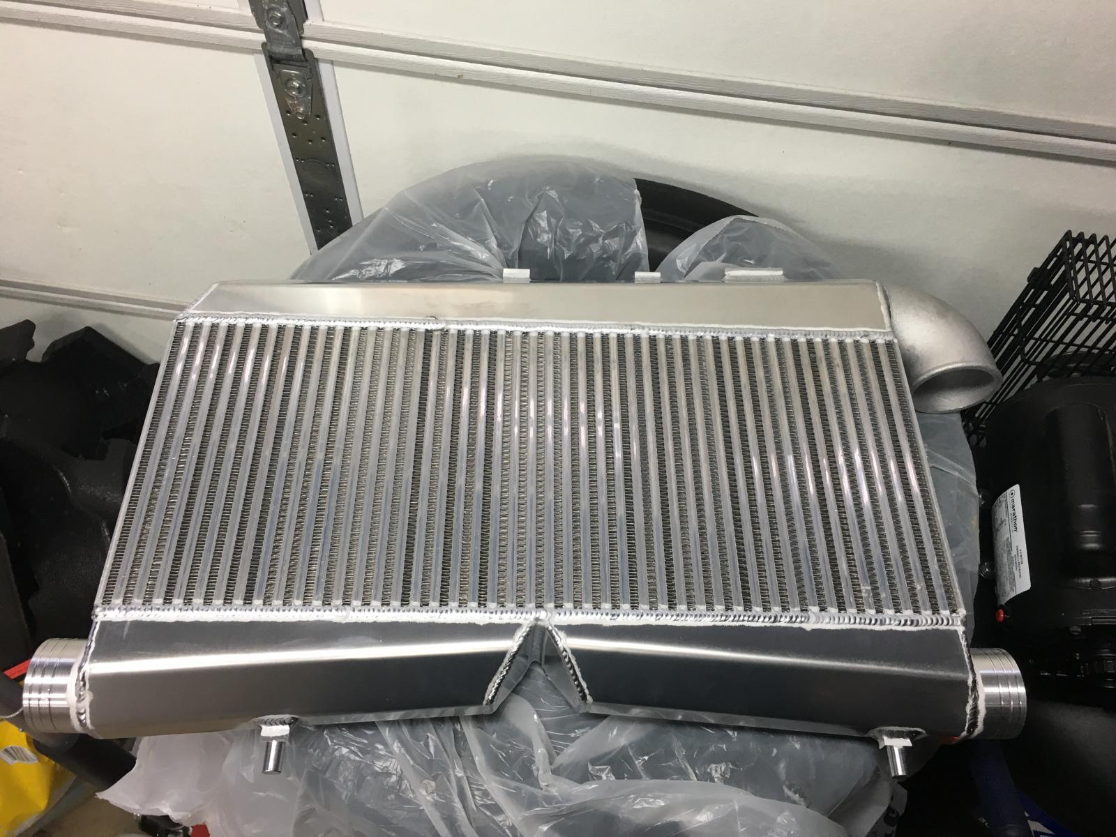

I know I need to post pics, but I've been a little busy. The intercooler came but I'm still waiting on the rest of the hellion kit for the piping. Here are some teasers. I'll post some progress pics soon too as I've been working on the fuel system.

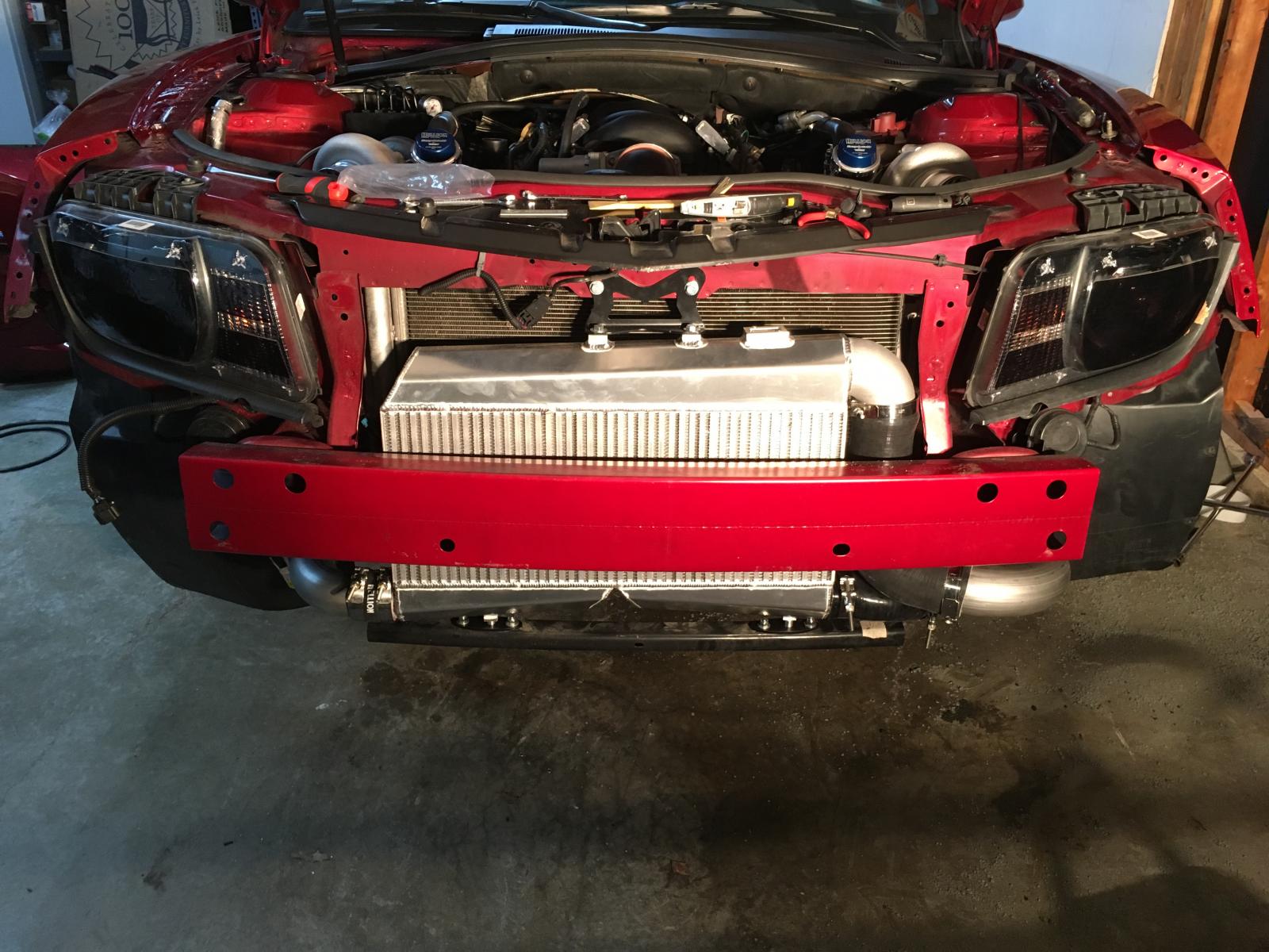

Didn't have the time this past weekend to get as much done as I would have liked but all considering made some decent progress. So far though I have the new pumps back int he fuel tank, fuel rails, pressure regulator, injectors, and 3 bar MAP mounted and made some progress on wiring together the FC3 controller
I know it is neater but I would not recommend feeding 1 rail or all 8 injectors in a row.
Take the feed line split it to the back of both rails, come off the front of the rails with either a T or Y and then regulator then back to tank.
Put your flex fuel sensor in the return line after the regulator
Ted.
I placed an order tonight with Fore for the fittings I'll need for that configuration so I'll have those shortly and can change the configuration and route the rails to be fed in parallel. Thanks for going over this with me on the phone earlier today.

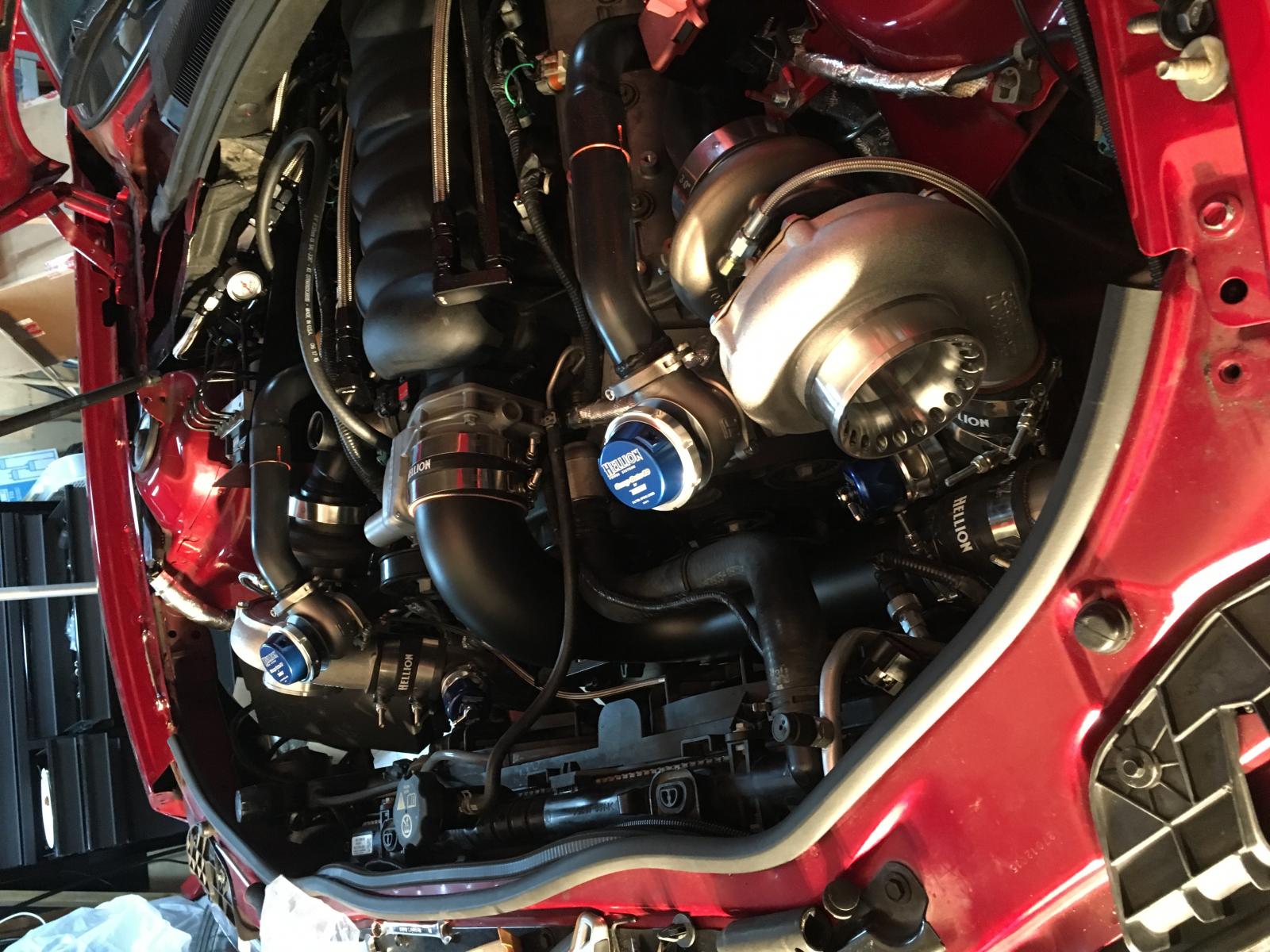

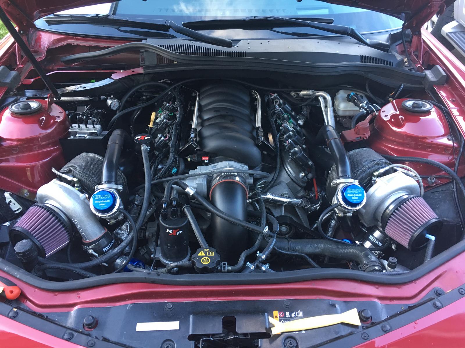

More progress pics. Got the fuel system done, new cam in, and the hellion kit installed. Holding off on the boost controller temporarily while we get the tuned dialed in with the all of the mods. I'm ordering a bunch of silicone hose so I can clean up all of the boost/vacuum reference lines and I'm making a mounting bracket for the boost/vacuum manifold so I can clean up the engine bay a bit. Currently I'm in the process of data logging for Ted so he can make tuning adjustments. Soon enough I should be able to get out and really stretch its legs.
