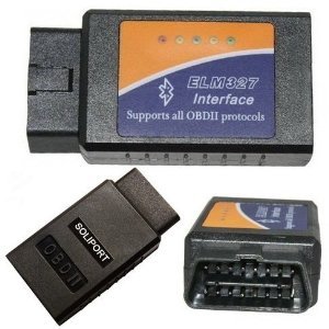

I had one of these plugged into my car for a LONG time:
(ELM327 Bluetooth OBDII Scanner) - sold it to Doug (TAG UR IT)

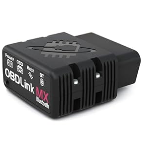

And now I have one of these plugged into my car full-time:
(OBDLink MX Bluetooth Scan Tool)
And I have never had my Onstar diagnostic report indicate that something was wrong...
Why did you upgrade to the MX? Just curious I have the ELM 327 as well
