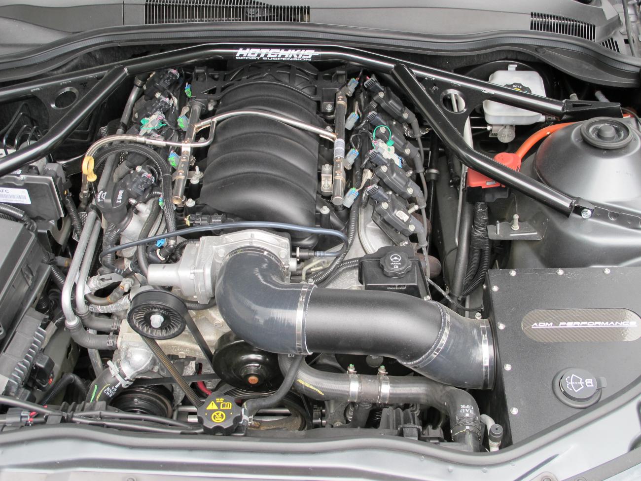

Well here it is, I did a lot to it before taking pictures ect.. so I'm trying to catch up now. I bought it in Dallas TX almost a year ago and installed a ADM CAI American long tube headers, hi flow cats, x pipe and Magnaflow race exhaust and a full Hotchkis suspension. Springs, strut tower brace, sway bars and sub frame connector. Once it hit 1000 miles I went to ADM and had them put in a stage 2 blower cam and springs, 160 stat, hose relocation kit and dyno tune it.

engine bay and amp
Amp and 6X9's

What heater hose kit is that? Looks really good.

The hose relocation kit is from ADM Performance.

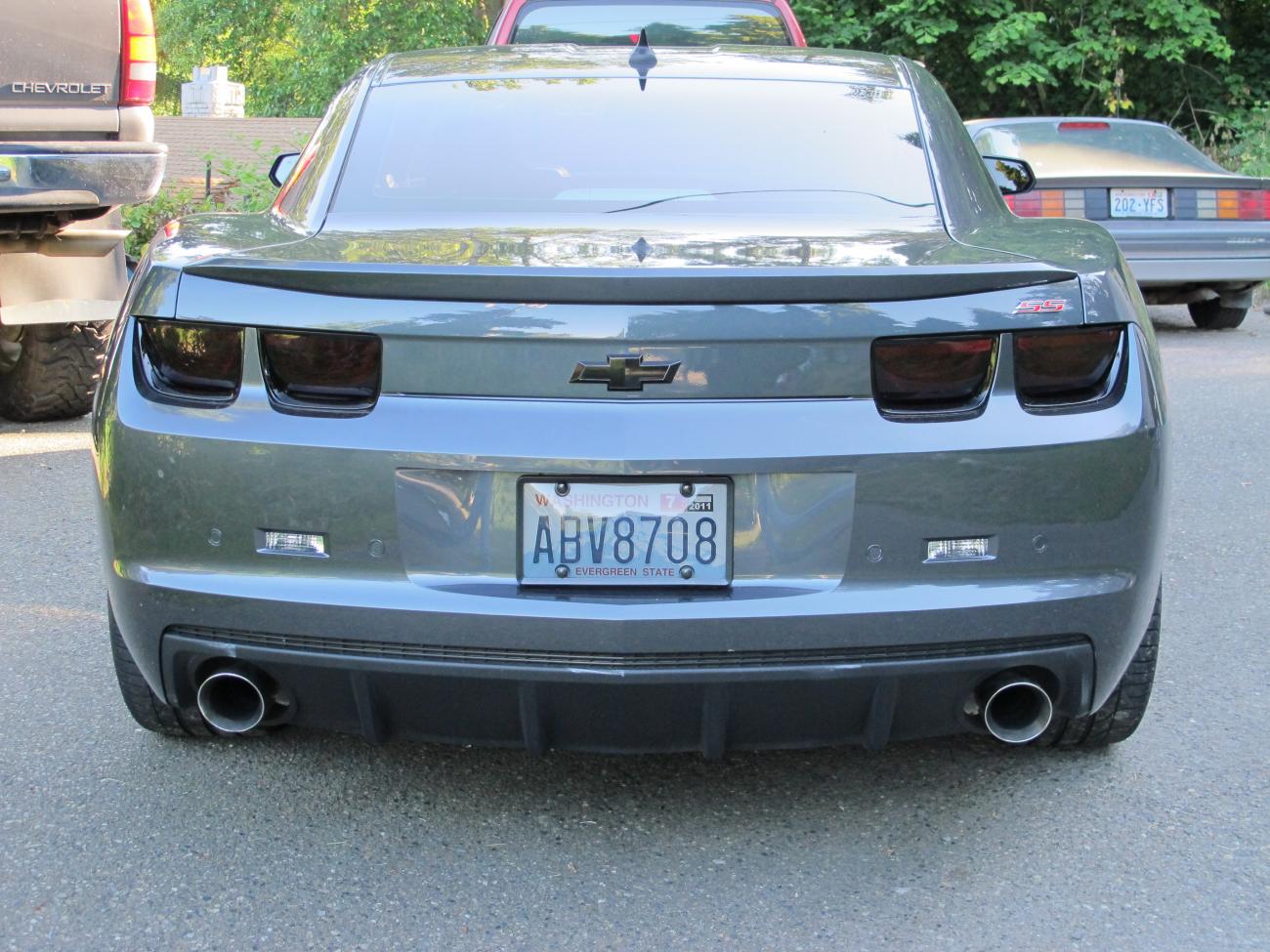

I also finished the tail light trim, bow tie black out and lens tint. I did not want issues with the police so I held back the urge and dident go to dark. For the trim and bow tie i used SEM trim black rattle can and top coated with urethane clear. With the lens I sanded them with 600 wet applied 2 thin coats of VHT night shades and top coated with urethane clear.

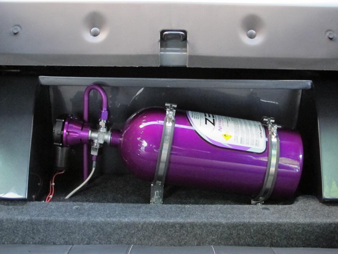

Well I had some time this weekend and got the remote bottle opener and safety blow down installed as well as the 6 shooter short throw shifter.

Finished the plumbing for the Nos, put the grill in and tinted the front side markers. I used the same method as the tail lights, the rear ones are finished just not installed yet.
