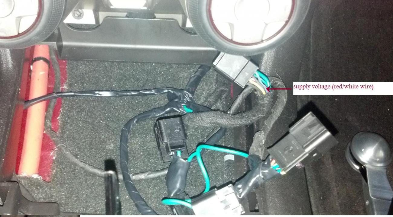

I get supply voltage from the red/white wire from the instrument panel to console harness or
CLSTR fuse (F4) is the same circuit. With this wire is it possible to use the mirror (make call or connect to Onstar ) even if the engine switch is off as in the previous mirror by pressing the power button on the stereo and maintain the mirror on until the call is over

step 3
I get (Low Speed GMLAN) from instrument panel to console harness
