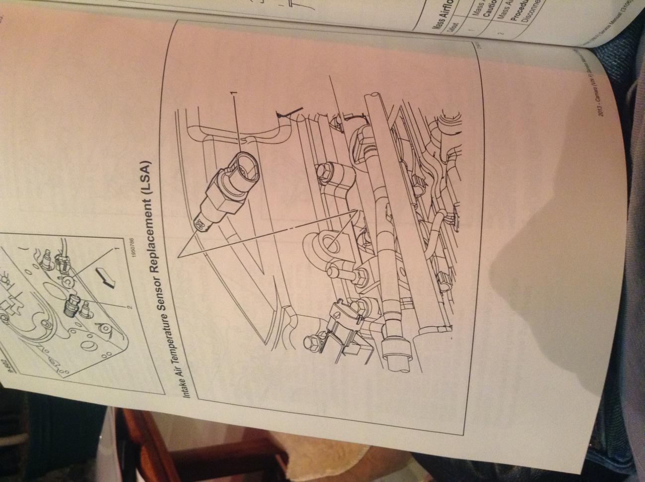

Where is the location of the intake air temperture IAT sensor? Was at the track yesterday and temps would get up to 119 degrees while in staging lanes. Using OBDII code reader. Trying to figure out how to get car to run more consistent.

It is on the blower, you have in and the out temps of the blower. So there is two of them.

I thought IAT1 was at the MAF and IAT2 is on the supercharger hat driver's side

Yes have a inter cooler. The one that counts is the one in the pic. Correct the MAS has a temp sensor in it, but that is not what counts to tell the ECM in boost.

It's in the MAF. Iat2 in on the blower housing.

Timing does not start pulling until 147 + on the IAT2 table.

Hey Keith where did you get that IAT2 table from? Do you possibly use EFIlive? HPTuners only has an intake air temp table and ive been told by them that on vehicles equipped with a physical IAT2 sensor this table referenced that sensor. On all other vehicles IAT2 data does exist but its only "estimated/calculated" and means nothing.
Looking at the IAT vs spark table the LSA will be pulling out 1.2 to 2 degrees of spark advance at high revs at the temps you are running at.
