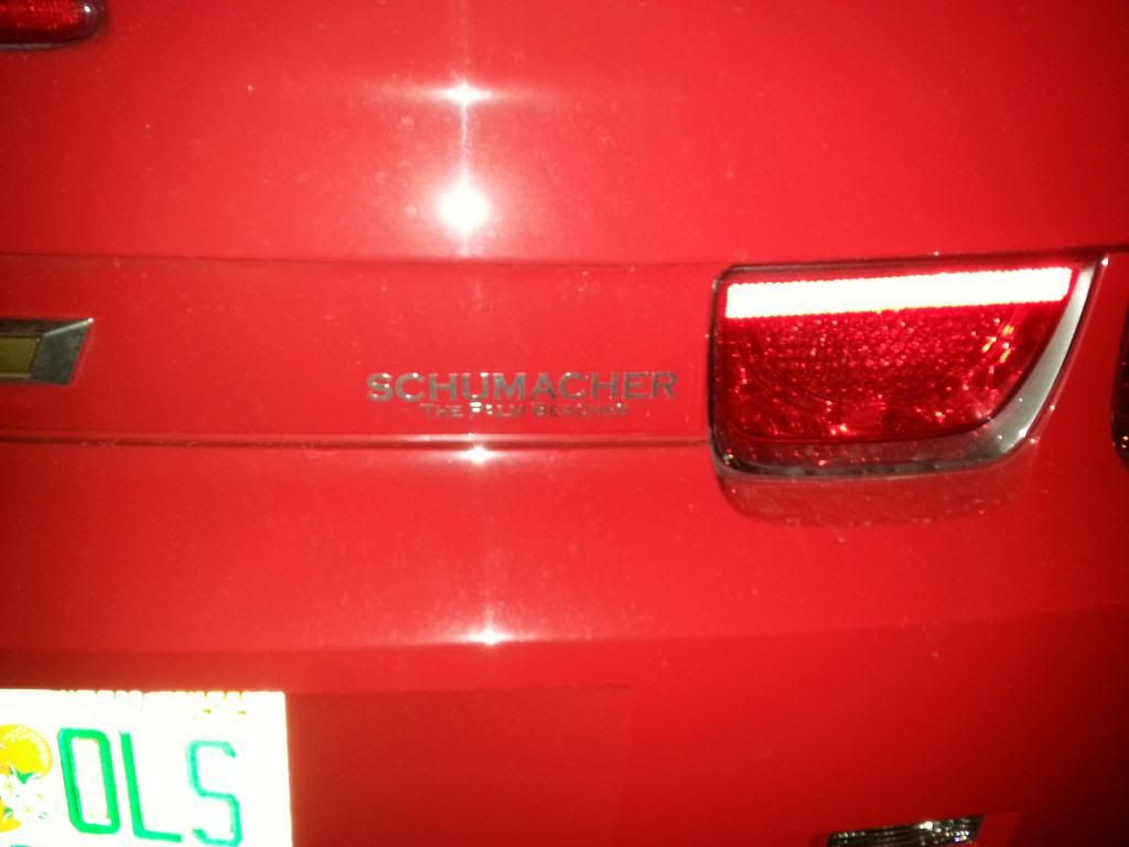

This is it
yes the car is dirty, i kno lol its been raining for the past three days

On my last car with one of these, I parked the car in a parking lot on a sunny day, waited an hour, and peeled them off using my thumbnail

I put a couple Oregon stickers on the C pillars in 2011 when I went to the Oregon/LSU game in Dallas. They were just cling stickers that didn't have adhesive. They didn't look bad till they started wearing last summer so I decided to take them off. Wasn't happening. They had baked on in the sun I guess.
I felt like you do probably right now. How the hell can I get them off without damage to the paint. I got the 3M wheel and it was like magic. It just chewed them up and they were gone. I wiped the area down with alcohol and there was not a single mark left behind. Just clean, shiny clear coat. I washed and waxed aafter that and not a sign they were ever there. My car is black too which shows any imperfections.
If they are vinyl this should work. If they are metallic I would think more in the lines of heat and plastic razor blades.
