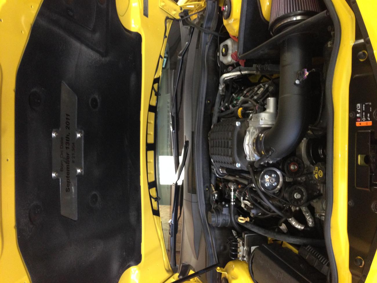

MOTOR & EXHAUST
L99 to LS3 conversion
MagnaCharger supercharger w/3.6 pulley
Lingenfelter GT9 cam
Ported LS3 heads w/valve job
-Hollow stem 2.165 intake valve
-1.59 High temp heavy duty Inconel exhaust valve
Halltech Yellow Jacket 102mm CAI
Boost-a-pump
ZL1 high volume fuel pump
ARH 1-7/8 x 3" headers w/o cats
Flowmaster American Thunder cat back
SUSPENTION
Pedders Supercars coilovers
Sub-Frame Bushes
Supercars End links
Radius Bush Inserts
Lower Inner Rear Steel Jacketed Bushes
Weld-In Rear LCA
Pedders Full Alignment Kit
ZL1 sway bars
BMR chassis brace
BMR Trailing Arms
BMR Rear Trailing Arm Bushing Kit
BMR Toe Rods
BRAKES
Raymond CTS/V 6 piston Brembo front brake conversion w/ front and rear slotted rotors
INTERIOR
CFD TapShift shifter
Pillar gauges: Autometer carbon fiber boost & fuel pressure
EXTERIOR
ZL1 front bumper
Hot Rod Black accents
Smoked taillights, front blinkers and side markers
Classic Industries rear SS badge
DRIVETRAIN
GForce 9" Rearend
Built Stange Pro-Iron pumpkin with 3.50 gears,
35 spline S-TRAC, Level 5 31 spline axles, 35 spline inner stubs, outer stubs
3.5" aluminum driveshaft
CURRENT NUMBERS
566 RWHP
501 Torque
