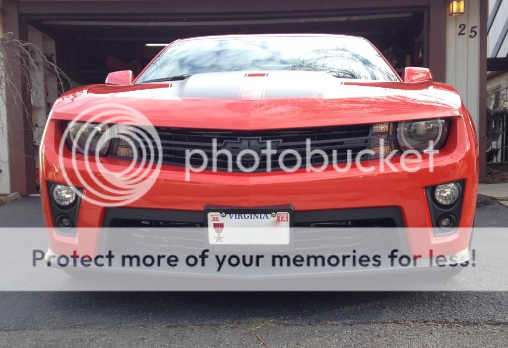

Eliminator No-Drill License Plate Bracket.
A couple members have asked me about this bracket since I posted it in my build thread a couple of days ago, so I thought I would post some better pictures and a description. This particular bracket is made for the ZL1 front bumper but that make them for other Camaro bumpers as well.

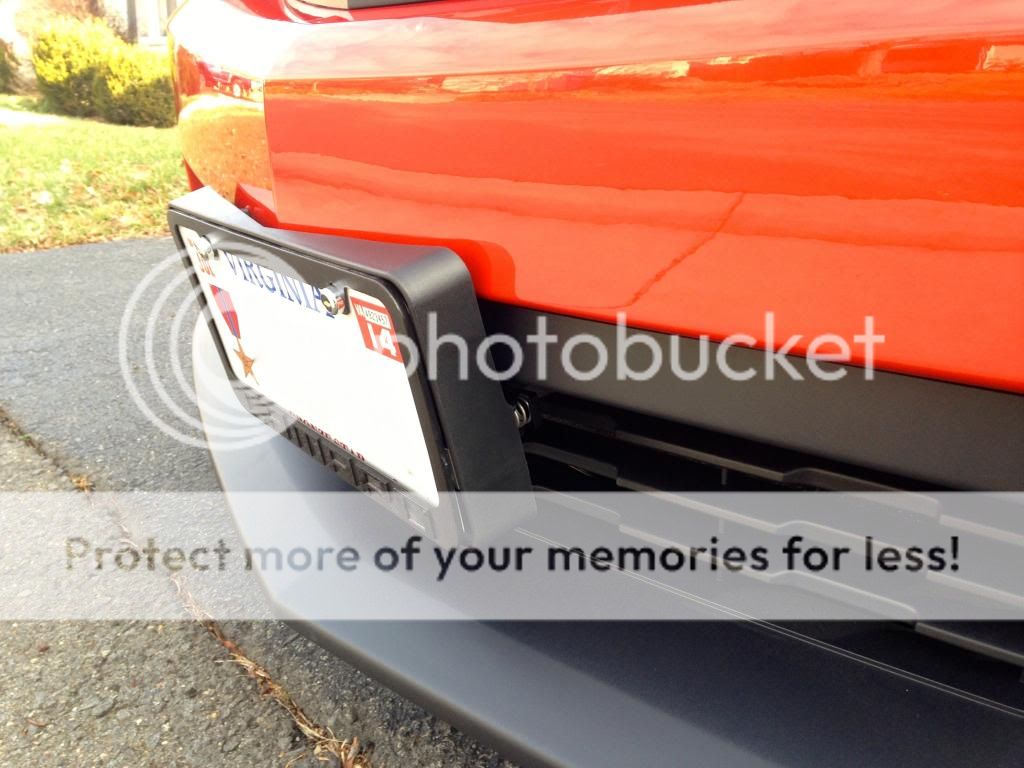

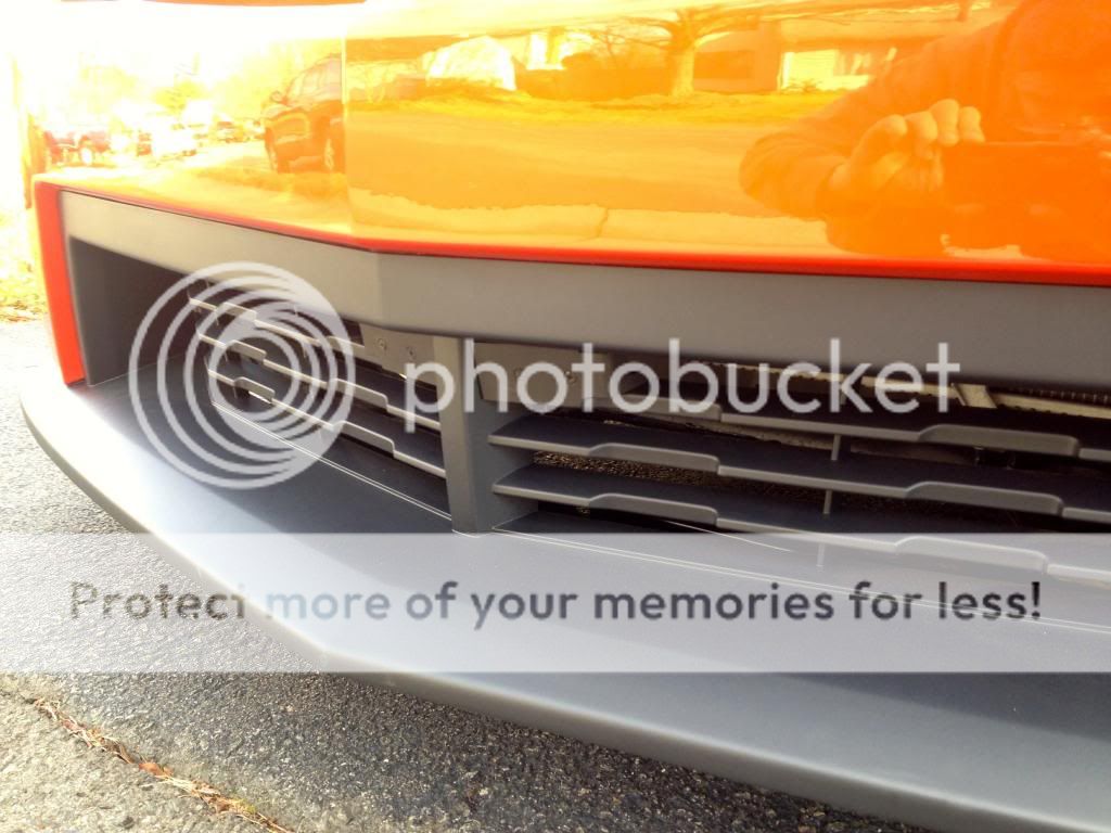

So basically, the bracket works by attaching some plates and brackets to the lower grill on the ZL1 bumper. The plates and brackets screw into each other and clamp to the upper part of the lower grill. The kit is made to install without having to remove any parts. The manufacturer included a cleaver tool for inserting the clamps behind the grill and fishing them into place and everything is held in place with a rubber band while you insert screws.

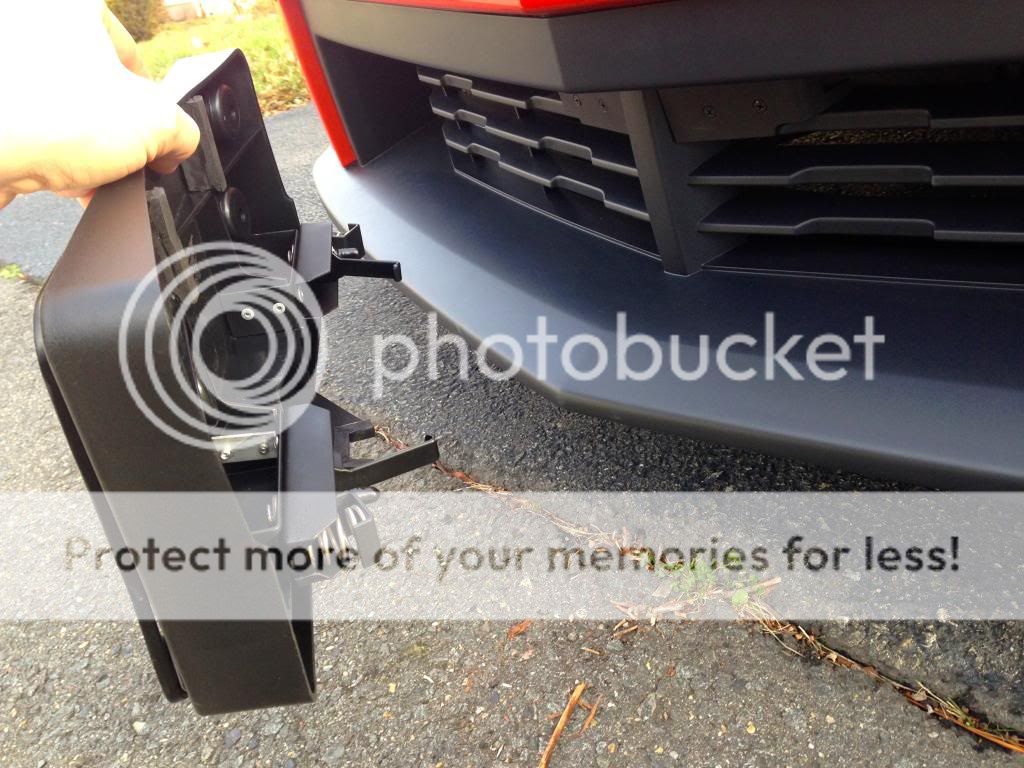

Once the backing plates are in place, the front license plate bracket simply clamps in place using some adjustable clamps mounted to the back of it.
See pictures below. Excuse the lack of bow ties... waiting for a new set from Lupe to be delivered.
I think it works really well and it feels very secure. It has a little bit of a downward cant to it. You can remove the license plate in about 2 seconds flat.
With Bracket in Place
Without Bracket in Place. Note small plates at top center of lower grill.

I'm kind of liking that.... Much better than some of the other options out there, ecspecially if you have a splitter..
