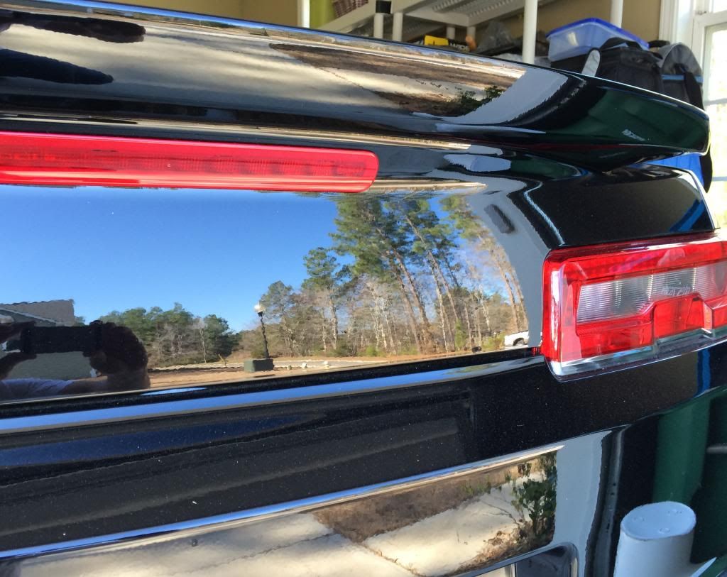

The rear bowtie is a PAIN. I used a heat gun. Take your time and try to get as much adhesive off as you can at once, otherwise, getting the remainder off is not easy (ask me how I know). I bought some 3M adhesive remover and it makes it easy. Just have to soak whats left and rub it off. Polish, then wax. Here's what the rear looks like when done and naked.
Now if I can only figure out what to do with the front bowtie...
