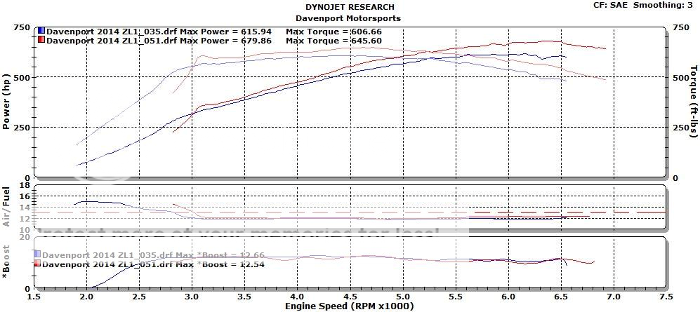

Well we received our first two Magnuson Heartbeat TVS2300 superchargers for the LSA motors. We immediately went to work installing it on our Ashen Grey 14 automatic, this car was already equipped with our stage 5 upgrade.

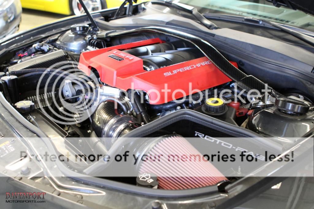

The boys wanted to be sneaky so they modified the stock LSA supercharger shroud to fit on the new Heartbeat.
We baselined our car before swapping the S/C and then ran it again with the new Heartbeat upgrade.
Here are the numbers:

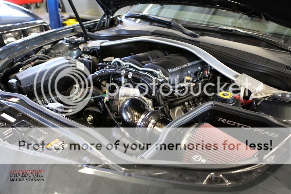

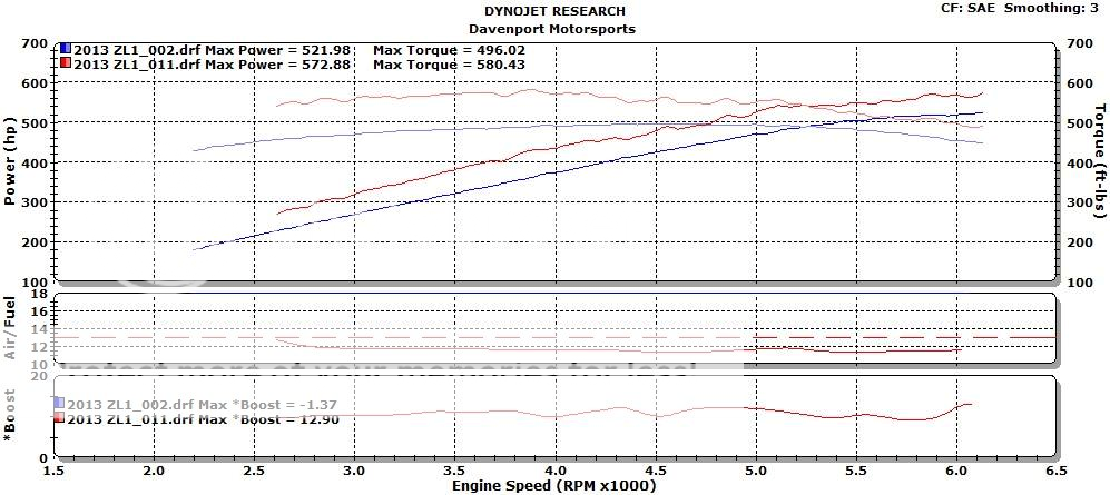

We also had a customers Ashen grey, Manual transmission ZL1 here for a stage 5 upgrade, it already had a Roto-fab cold air intake on it. We asked Robert if we could try the other Heartbeat on his car since is was nearly stock, and was a manual. He was more than game to give it a try.
Here are the numbers for that set up. The baseline was done with the Roto-fab intake, and then we installed the new Heartbeat.

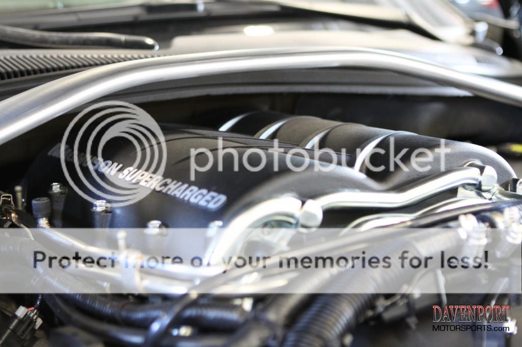

Those are nice numbers. The LSA and heads obviously breathe well, they're just licking up that extra air.
Namala, that last photo of the Heartbeat is a keeper, nice one.

Thanks! Took three tries to get the shot I wanted but it worked out.
