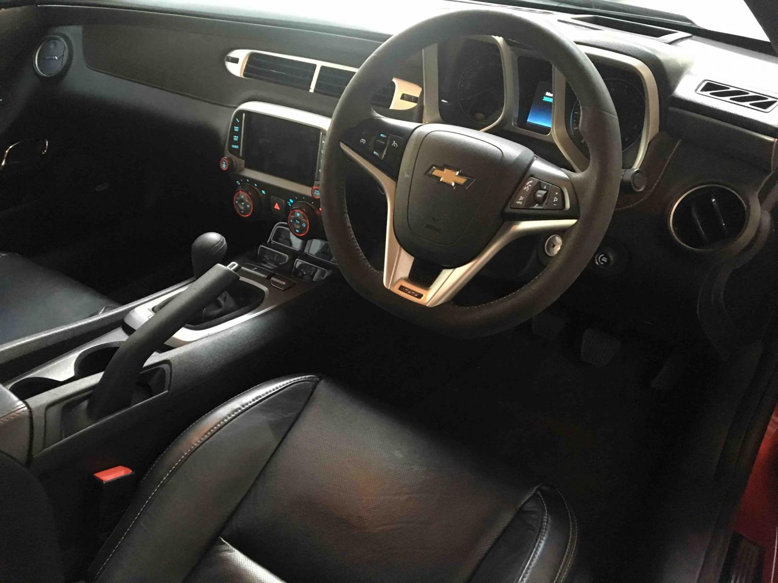

Good deal that you got it fixed! The first time I seen your picture of the interior change over was mind blowing. What do they do for the pedals on manual cars when they make the conversion? I love manual cars and choose manual over auto but I think I would have a hard time driving a manual car converted to the right side driver.
If you look at the pedals the accelerator is on the right side brake in the middle clutch on the left we change gears wit our left hands
I had the pleasure of of driving in Hawaii last year the hardest thing was keeping right turning opposite to the last 30 yrs of driving but judging car parking spaces was real hard having the majority of the car on the wrong side of you driving but you get the hang of it or hit head on with a car
