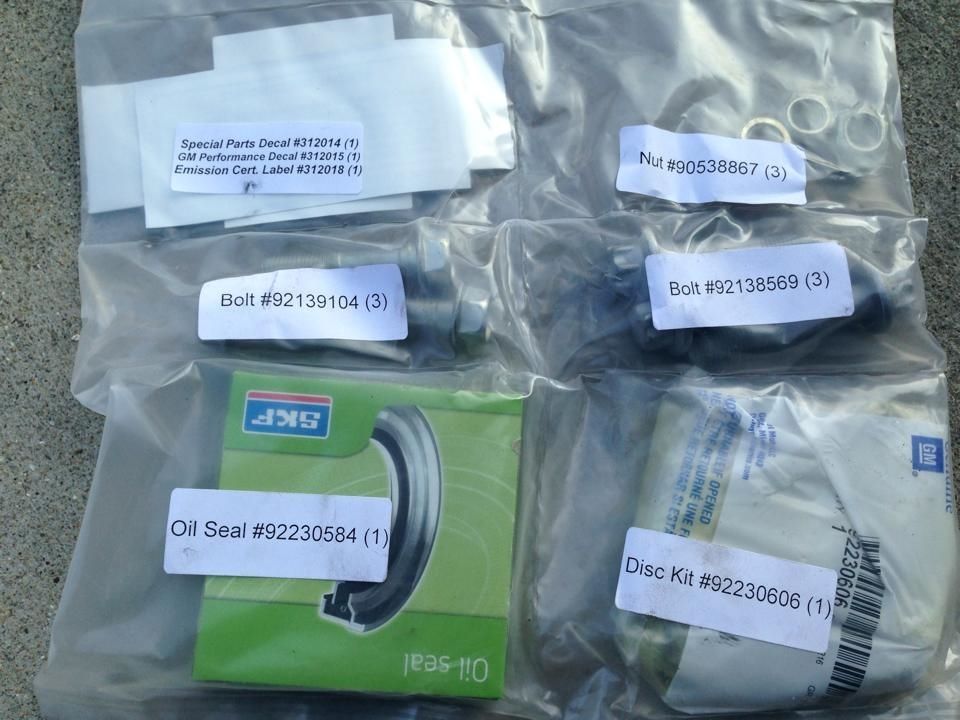

I'll be selling 90% of a gear install kit if anyone is interested.
