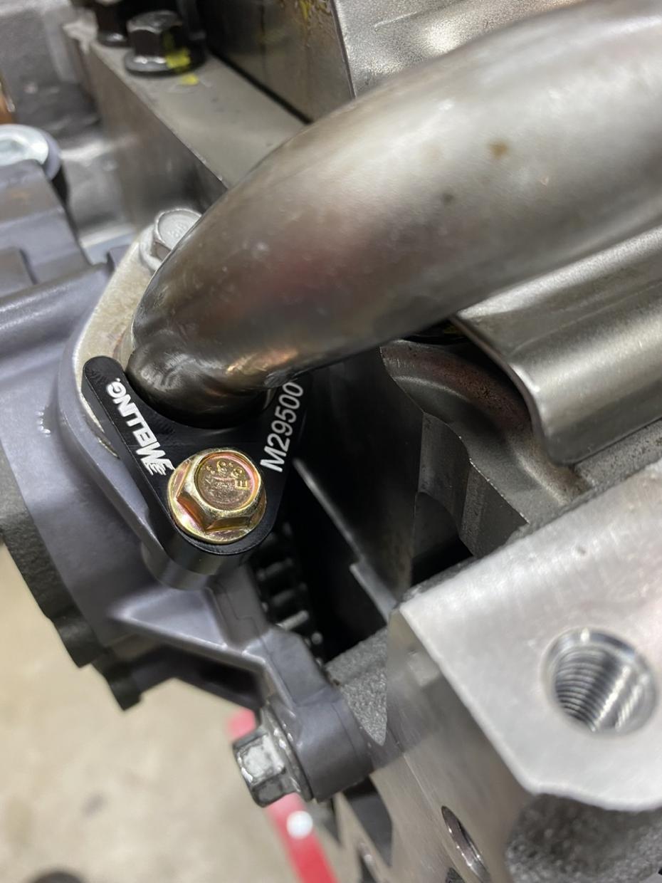

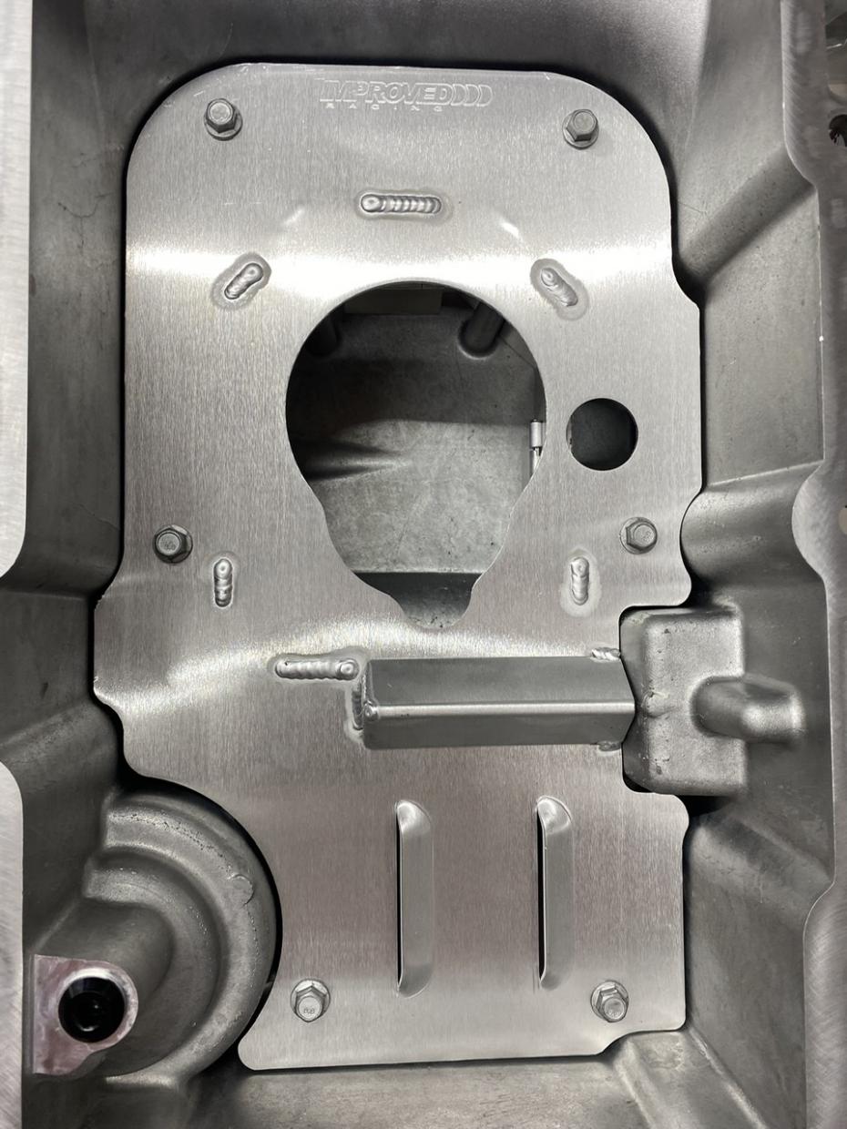

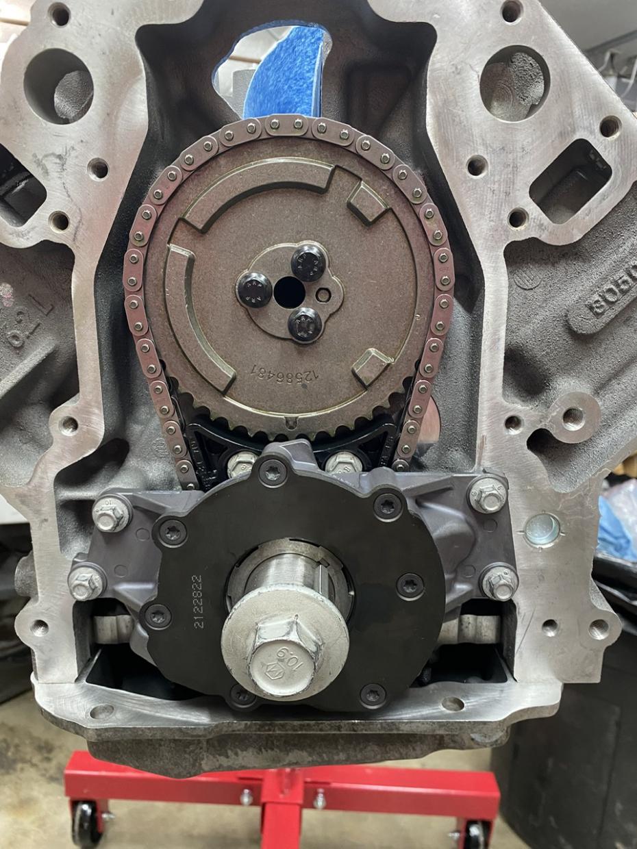

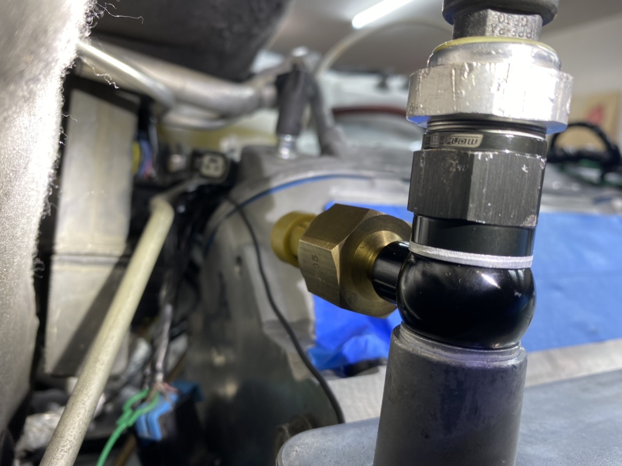

I’ve not had any pressure concerns. I do have an AEM pressure gauge reading from the OPSU to keep my eye on it as well. Before my engine rebuild, I just had a Melling 10295 and was running M1 5w30. For the new 379 I used a new 10295 along with the M29500 pickup tube brace, as well as Improved Racing pan baffle and pressure relief plug. Running Brad Penn 10w40 now. Only one track night with the new setup, but all was good.

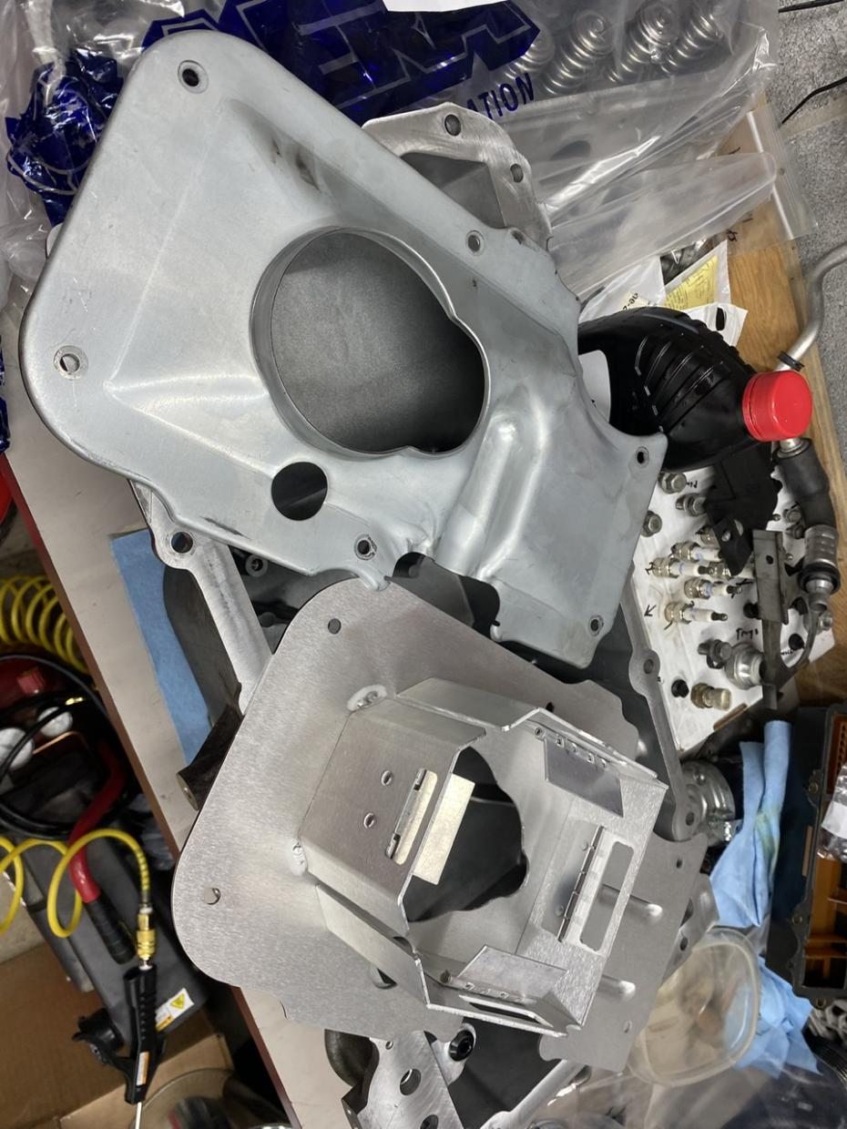

Great pics! These machines are works of art. Always wondered what the baffles looked like installed. Glad to hear oil pressures are good and I know you take advantage of the power that's available. I wonder if the oil pressure issues are more of a Corvette thing with the LS6 and the different oil pan setup.(?).

If you enjoy pictures, attached is another view of the baffled replacement versus OE. As an aside, I took pictures of every single thing with my new build. I need to get them updated in my build thread, but I digress…
Perhaps it’s a combination of the different pan setup as well as the capabilities between the platforms. Clearly the Z28 proved the Zeta II can do it, but it certainly wasn’t coming as easy as the Corvette. That said - and this is just for posterity - the LS7 and manual transmission Grand Sport LS3 are the only dry sump setups GM have us. Considering the GS is for intents and purposes a Z06 without the LS7, it also makes sense.
