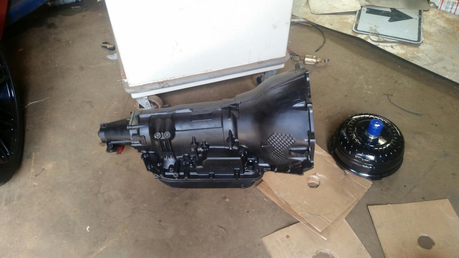

●Cooks 4L80E Transmission
●FTI 2800 Triple Disk Billet Stall

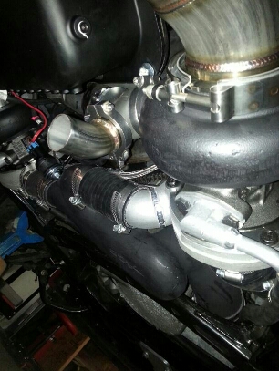

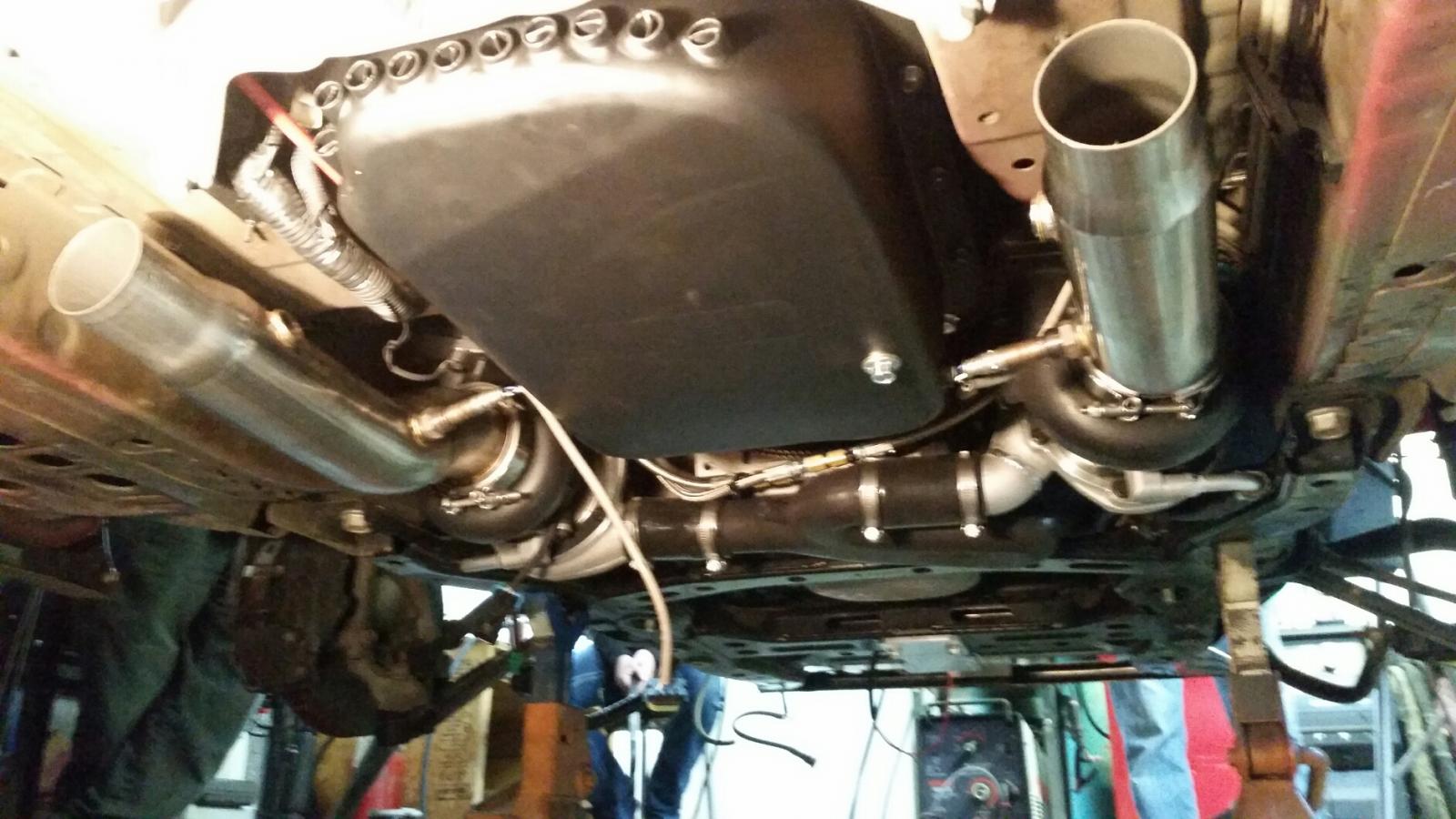

We finally finished everything up last week after about 3 weeks of working on it. Now I'm trying to figure out who is going to tune this bird? I was thinking of PCM again but I've been also hearing very good things about Vengeance Racing down in GA, if anyone has experience with great shops and tuners for flex fuel I welcome the replys? Thanks!
Final numbers coming soon along with a build sheet of my motor & car.
If anyone has questions about cutting the turbo for the wastegate to fit the passenger side of the car feel free to ask, I also have detailed pictures if you need them. This is for the guys that have 4l80e's or TH400's transmission.

how does your wastegates fit with the 4l80?
Welded the the flange to the turbo housing in a location that would fit beside the 4L80E.
