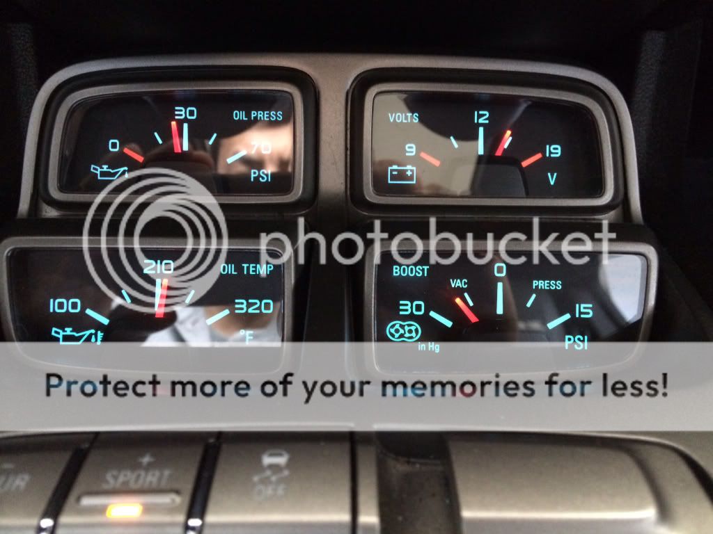

This is mine cold sorry it's blurry.

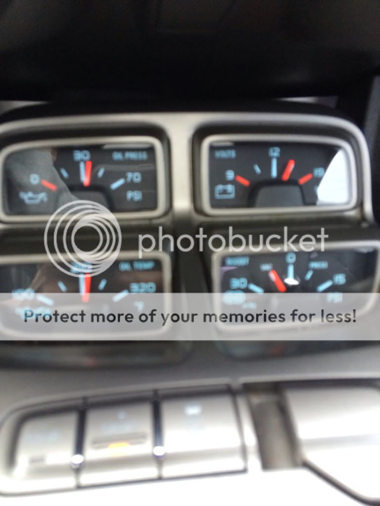

This is mine after its warmed up.
The gauges (IMO) read low the true way to accurate reading is hook diagnostic tester up to OBDII port and read it there. When I did mine it read 64 psi cold and 39 psi hot.
Hope this helps.

Thanks mine is the exact same good to know about obd port reading thanks again.
