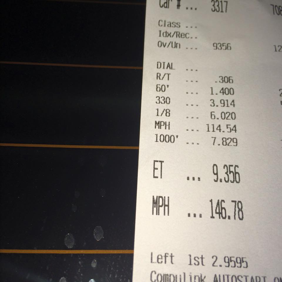

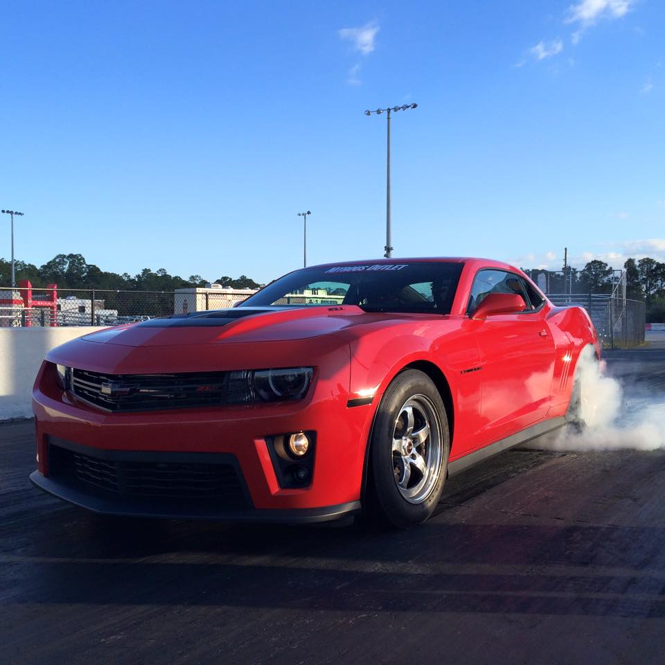

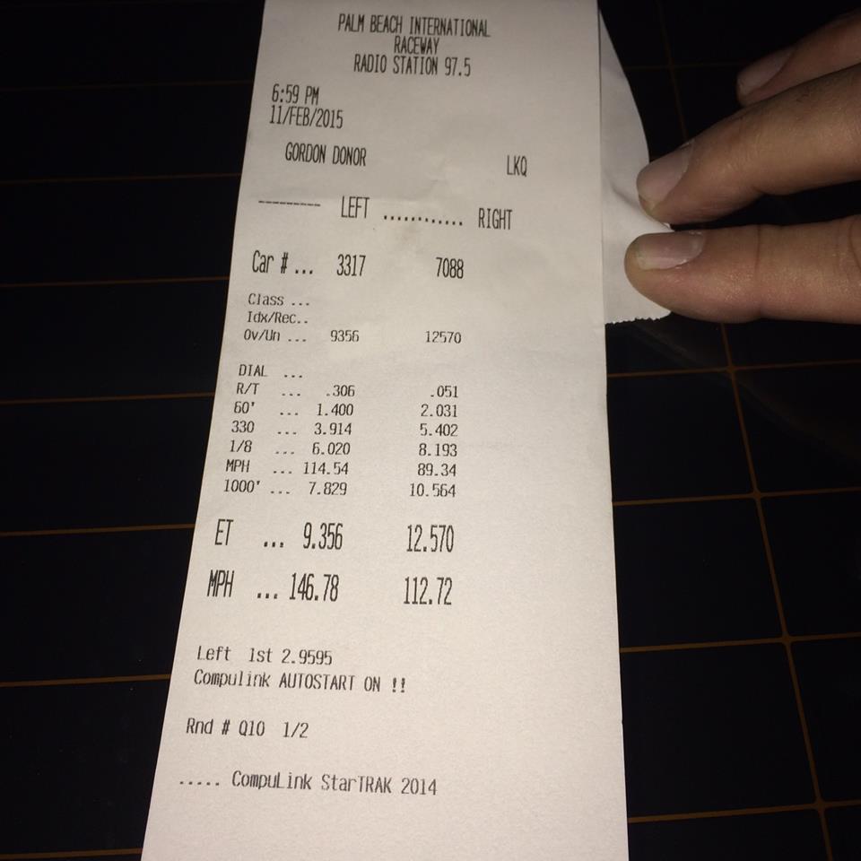

Well... Last night reset the record for Fasest camaro ZL1 period!!! Still had exactly the same set-up i did when I went 9.86 on boost just now we added a little nitrous to the mix LOL! 9.35@146!!! KraftWorks built, tuned and dialed in!!!
STILL ON A Stock Bottom end, Stock Transmission, Stock Converter, Stock Suspension, Full weight at 4260lbs
Mods list…
Nitrous Outlet Blower Plate system (150 shot)
KraftWorks Custom CAI
KraftWorks Custom Comp Cam
Latozke Racing heads Ported Stock LSA Heads, Blower/Snout
American Racing Headers 1 7/8'' no cats
2.55 upper and 9.55 lower pulley
Fore triple pump fuel system
Nick Williams 102mm Throttle body
Injector Dynamics ID850's
Wheels 17'' Weld RTS's
M&H 325/45/17 Drag Radials
Built and tuned by KraftWorks
