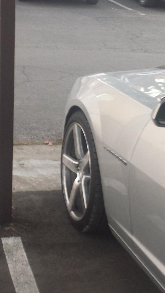

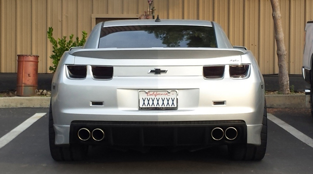

Hold on now... the offset always depends on the type of wheel. I've got +20 Offset for the rears and +35 Offset for the fronts on the Niche Milans, and it all sits perfectly flush, at least to my liking. I did have to add some small adapters to my fronts in order to get them there... but all is well in that department.
Here's a shot of the front (sorry bad pic), and a shot from the rear (note that on the rear shot, I had not yet added the adapters to the fronts).
